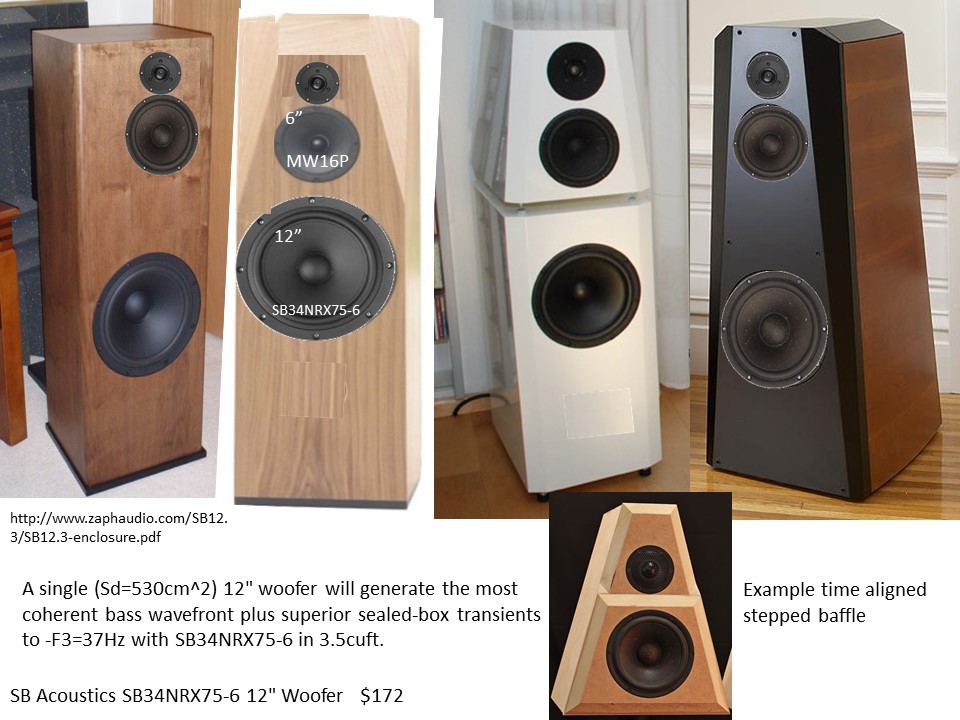

Spend some time searching for a 3-way design with a sealed 12" woofer like the SB34NRX75-6 in 3.5cuft cabinet volume for tight transient deep bass, supporting the 6" Satori MW16P-4 to cover the vocal range and a 1" Satori or SBAcoustics tweeter.
Line source gave good advise. A floostanding 3-way can be your final speaker. From Troels SBA-10 is worth consideration, it has low tuned 10" bass. Most slim towers have too high br tuning, but that can be changed easily, or changed to sealed but then you need EQ.
A single (Sd=530cm^2) 12" woofer will generate the most coherent bass wavefront plus superior sealed-box transients to -F3=37Hz with SB34NRX75-6 in 3.5cuft.
