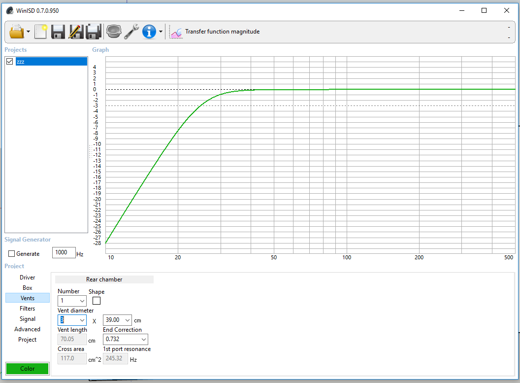

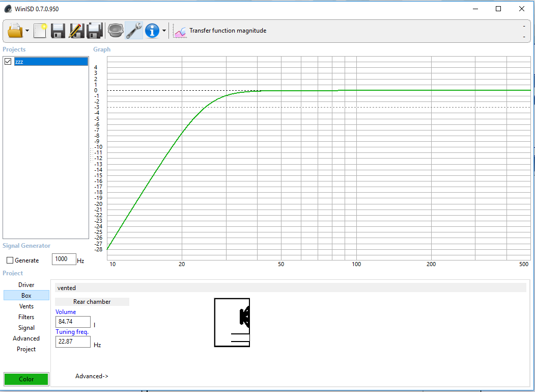

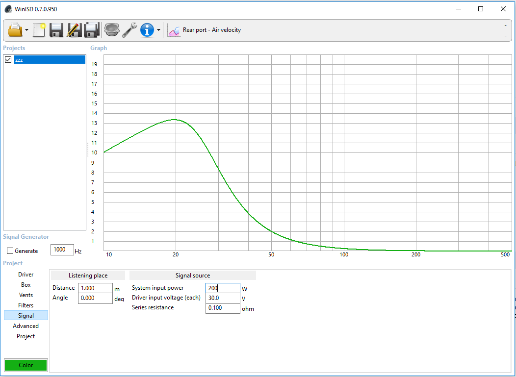

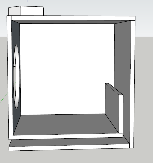

I ordered the SB Acoustics SB34 12 inch sub and I'm designing a box for it. WinISD suggests sealed, but I'd go for ported this time. I've never built a ported sub so I need some advice.
I went with the "slot" type port instead of a tube, but I'm concerned that it migh be too small in height and so port noise will occur.
For high output (PA subs) 30 m/sec. is about the maximum, using the maximum power (from the amplifier) the driver will ever get. About 15 m/ sec. for home use is a good rule of thumb. As it's also SPL related, a bit higher might not be a problem but a bit lower isn't a problem.

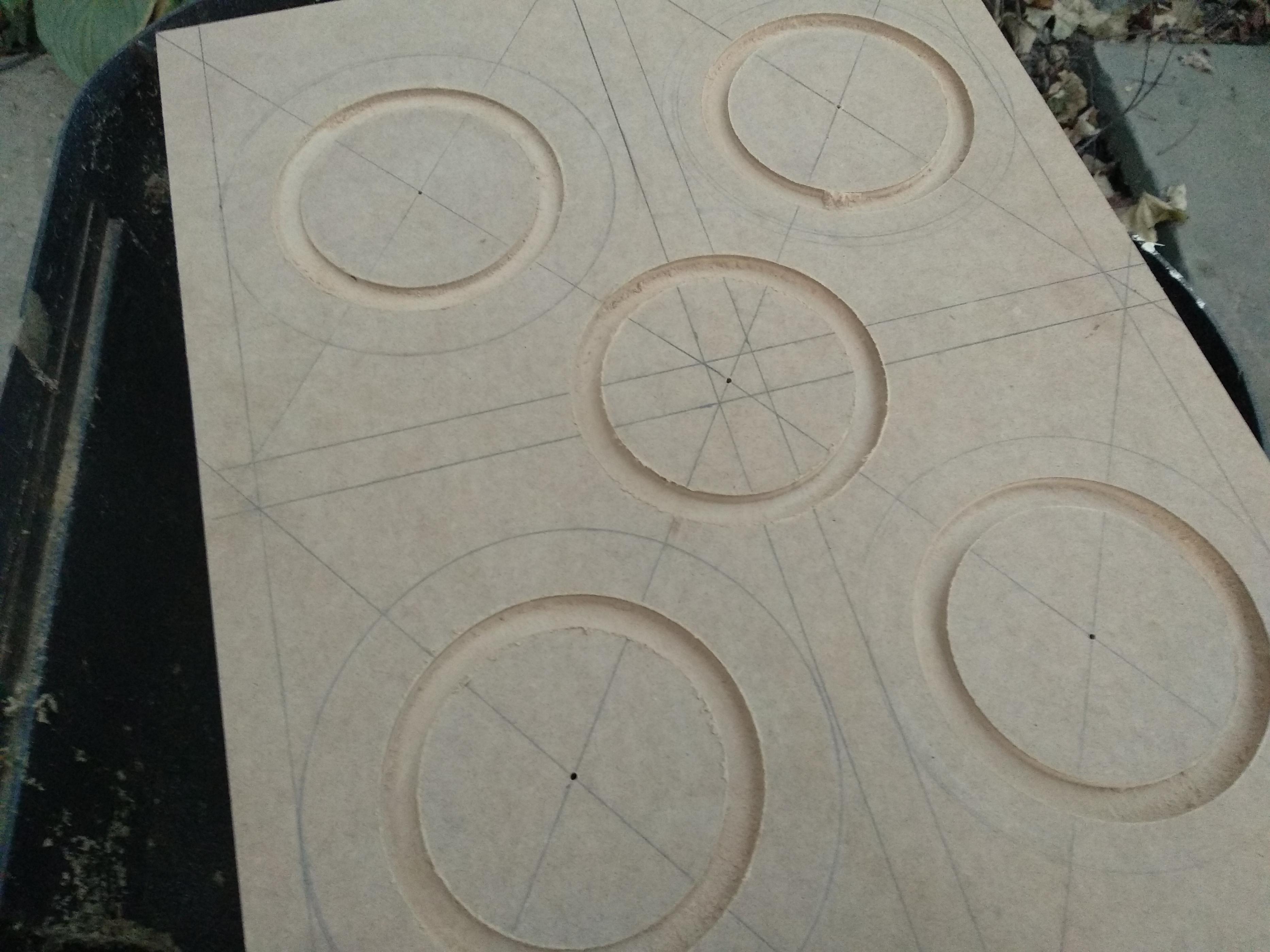

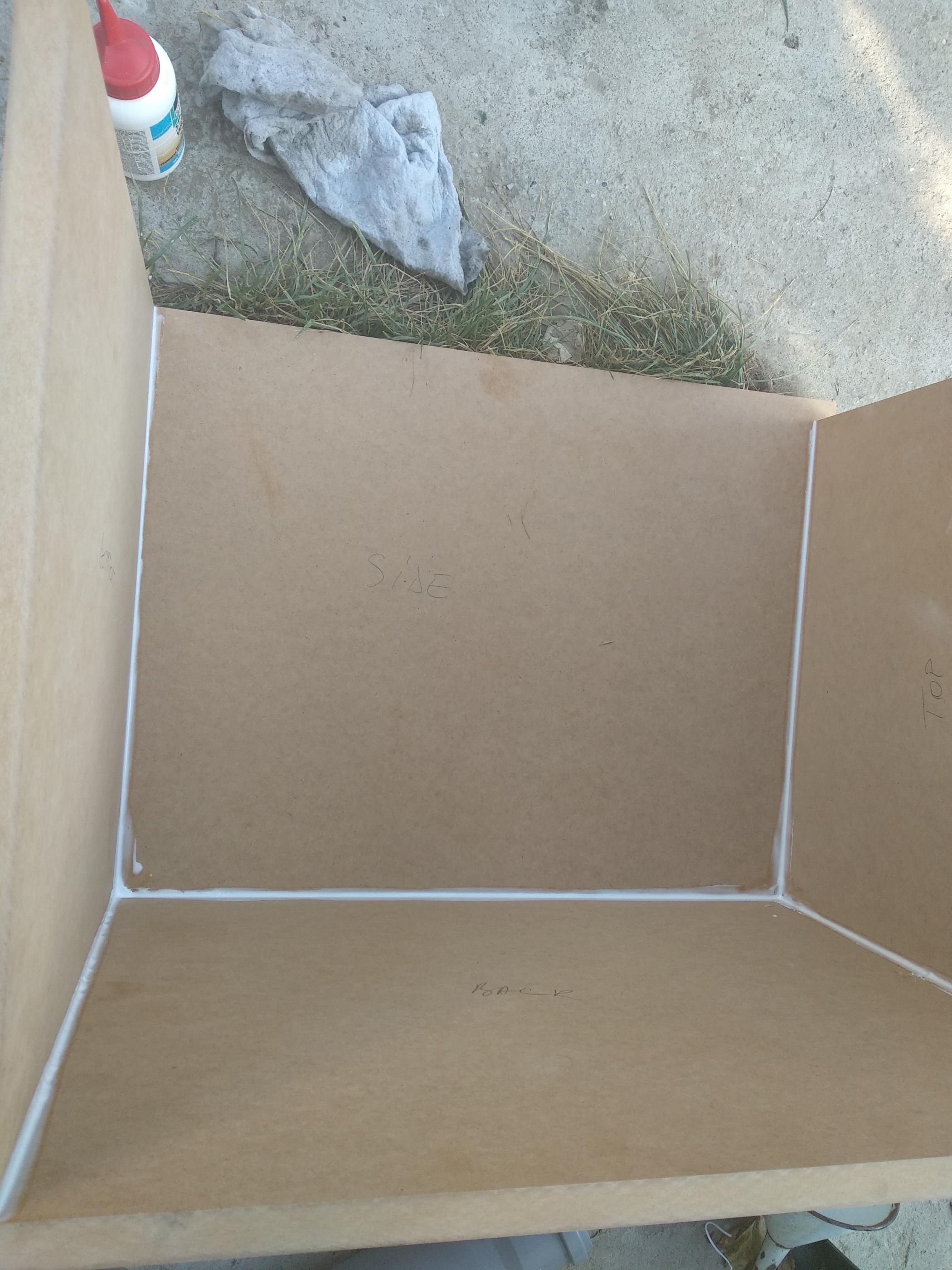

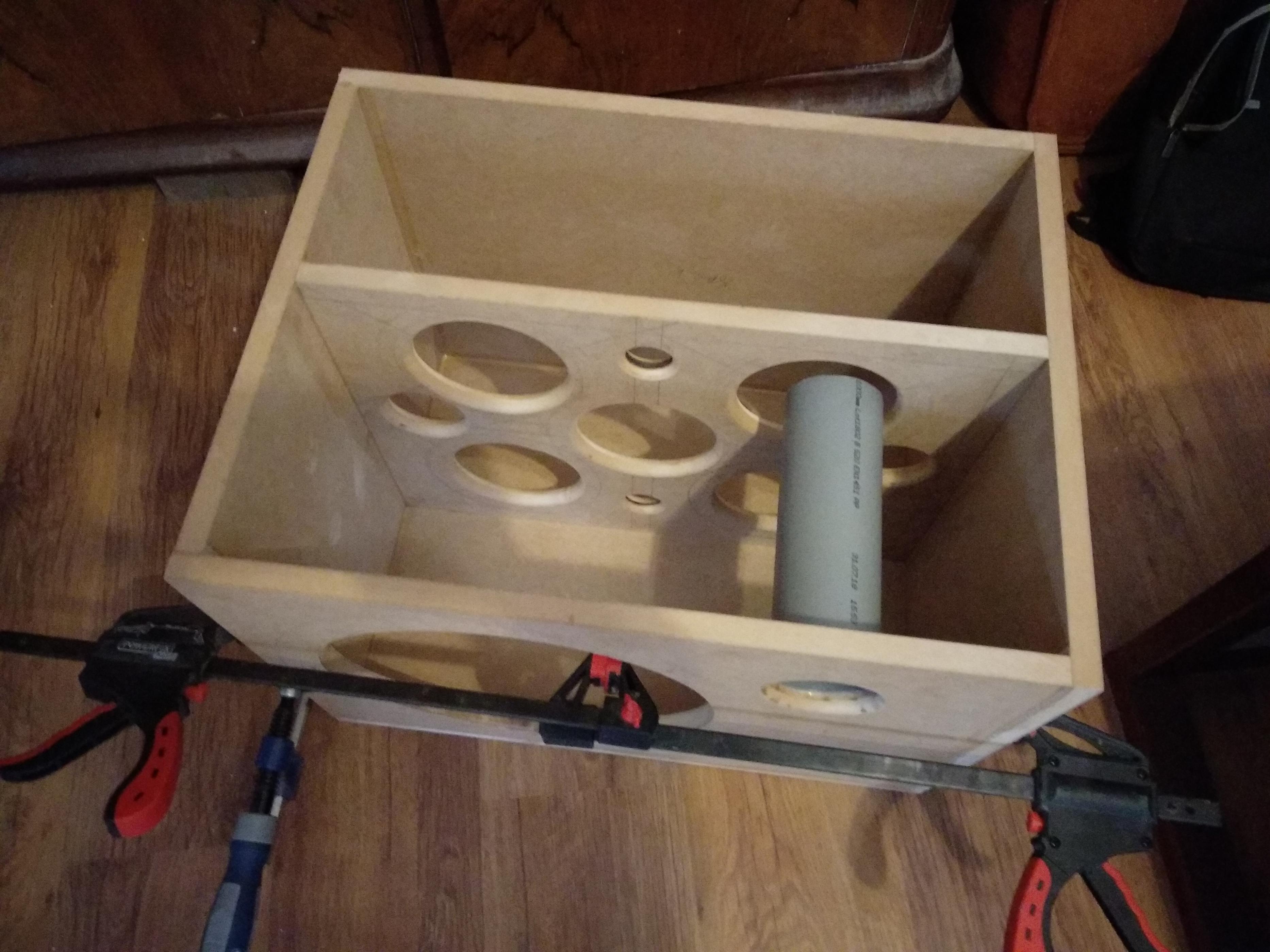

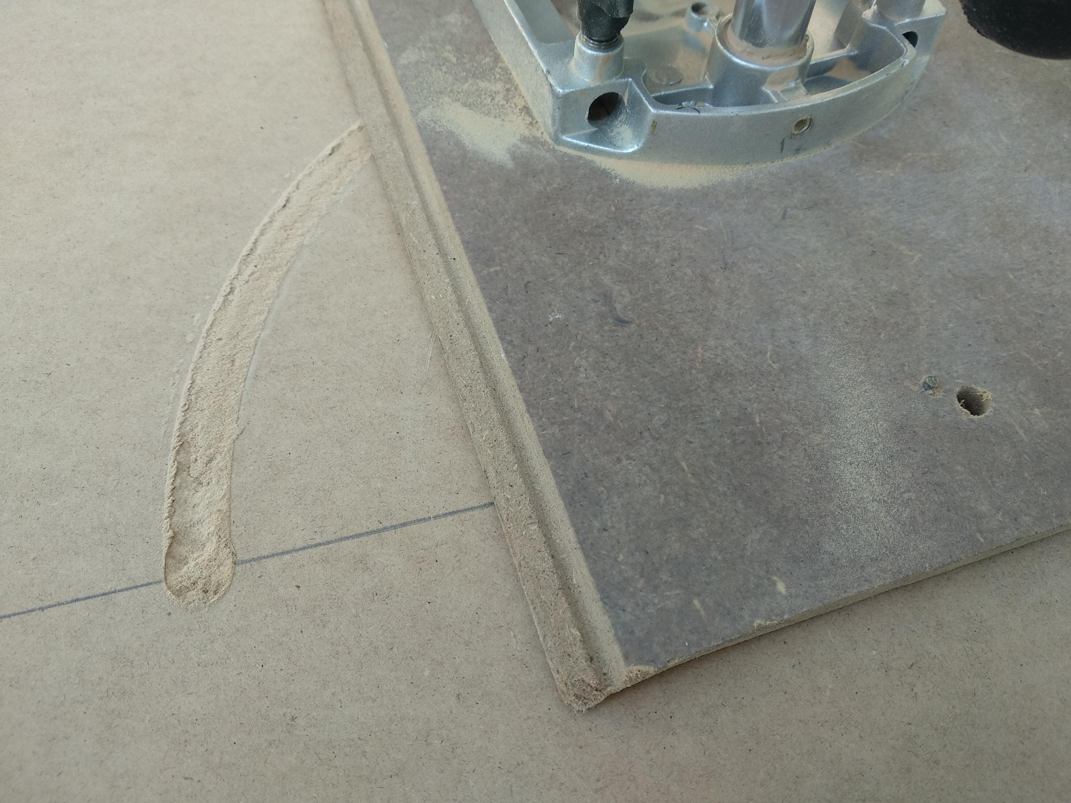

I went with a tube eventually, less of a hassle.

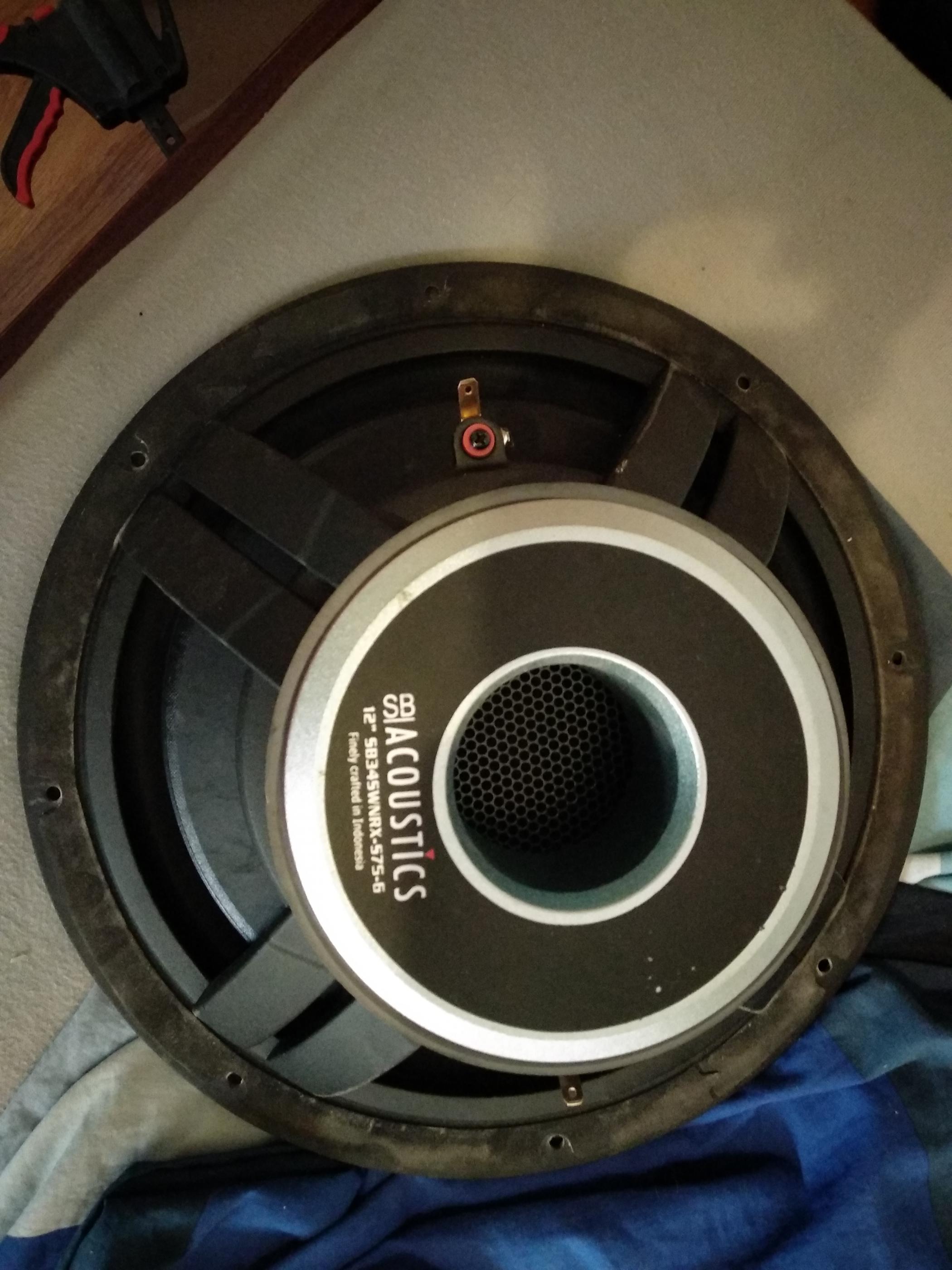

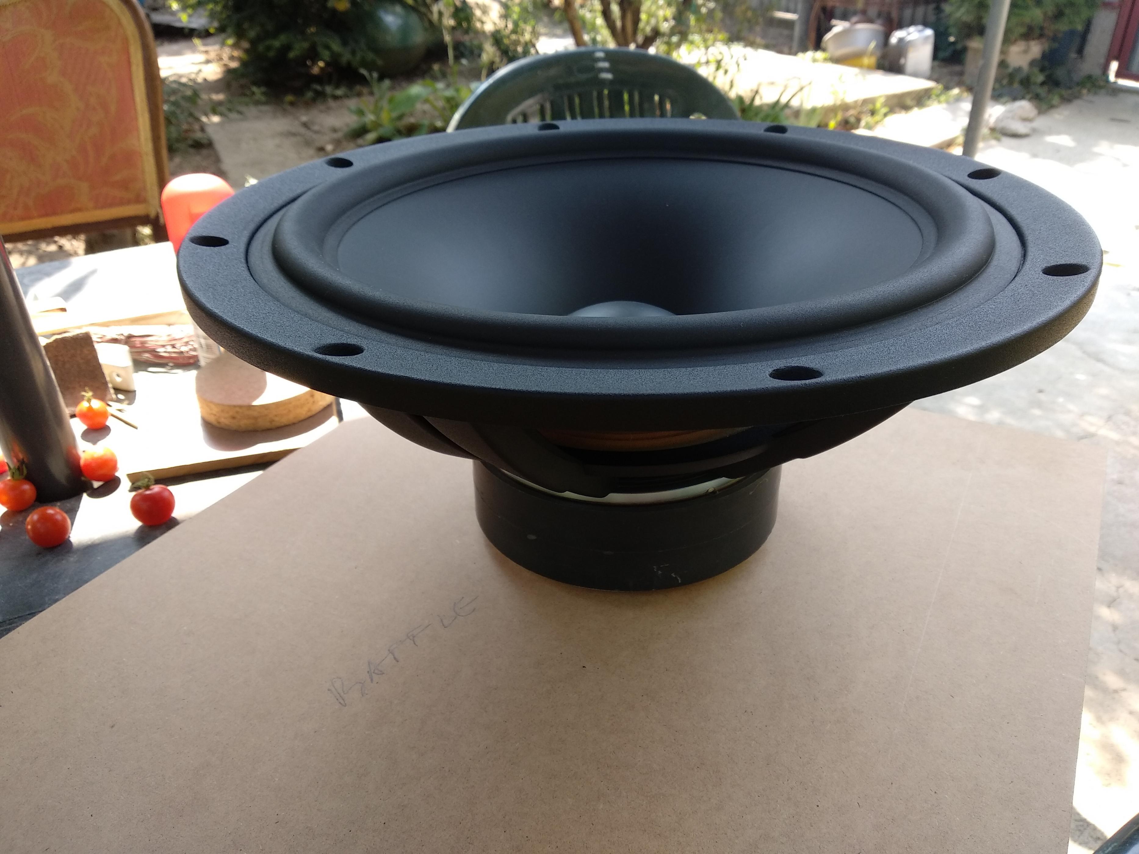

That's one nice looking driver.
The sim shows a flat response above 100 Hz. That's highly unlikely, and I'm guessing that the sim isn't taking the driver's inductance into consideration. Such programs can over-estimate the driver's response at the upper end of the bass range.
Concerning vents, I consider anything below 1/3rd Sd as "small" and likely prone to non-linearities (for one of my last builds, I measured 2dB of compression at higher SPL levels due to the vent, and that vent had a cross-sectional area was around 2/3rds Sd).
Given that rule of thumb, a vent for a 12" driver should be around 167 cm^2, or almost 6" in effective diameter, with a length chosen to achieve the target Fb. Smaller than that, and you'll likely end up with a vented box that has different response curves at different SPL levels.

We'll see how it sounds in the box. I am concerned that the port is too small in diameter, but if it was larger, it would also be too long.
Well, as expected, there is some chuffing. The next pipe diameter I can find is 110mm, which results in about 54cm of port length (longer than it can fit in the box).

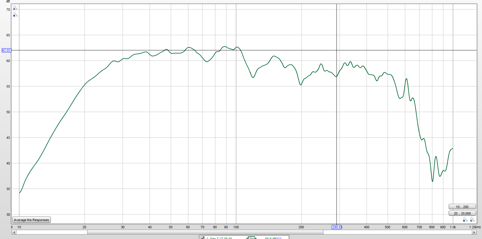

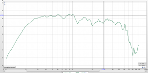

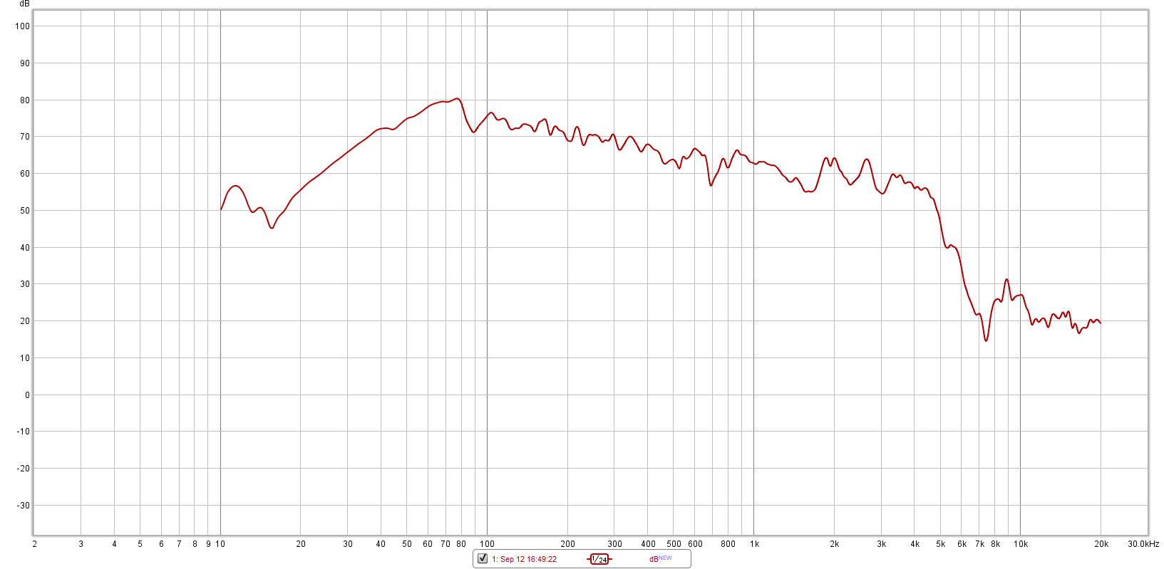

Measurements look decent, I'd say. No break-in, outside, with walls nearby.
Mind the SPL values, I haven't calibrated the levels. It does roll off higher than expected, even though the box is tuned to 23Hz.

Uh, no, it can be longer as it doesn't have to be flush or even extend into the cab beyond the baffle for that matter, just looks strange and if short TL length, then of course needs to be rigid/massive/braced enough not to audibly vibrate.

The 110mm should be good, I typically use 4" port for a 12" woofer and that seems to work fine for most music, not home theater. It looks like the 54cm port should fit with an elbow and maybe mounting it lower on the baffle.

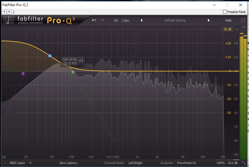

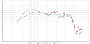

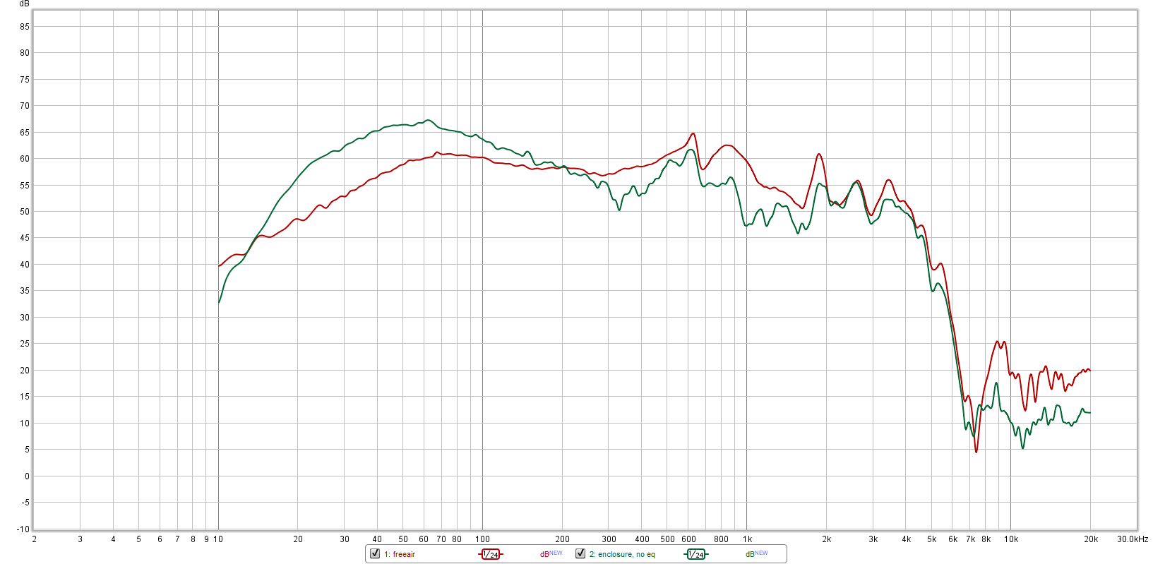

I built a sealed box out of curiosity, 50L as suggested by winisd.
Don't really like how it sounds, I simulated a linkwitz transform curve and still doesn't sound as effortless as the ported box.
