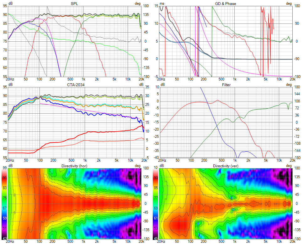

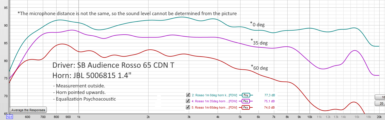

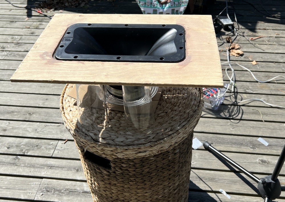

I did buy the SB Audeince Rosso 65 CND Driver. Here are some pictures and measurements that I did outside.
I have not heard them yet but I have searched for a driver that can play down to 800Hz. My waveguide does apparently limit low extension as Troi has measured with his ES-600 horn cut of at 500Hz.

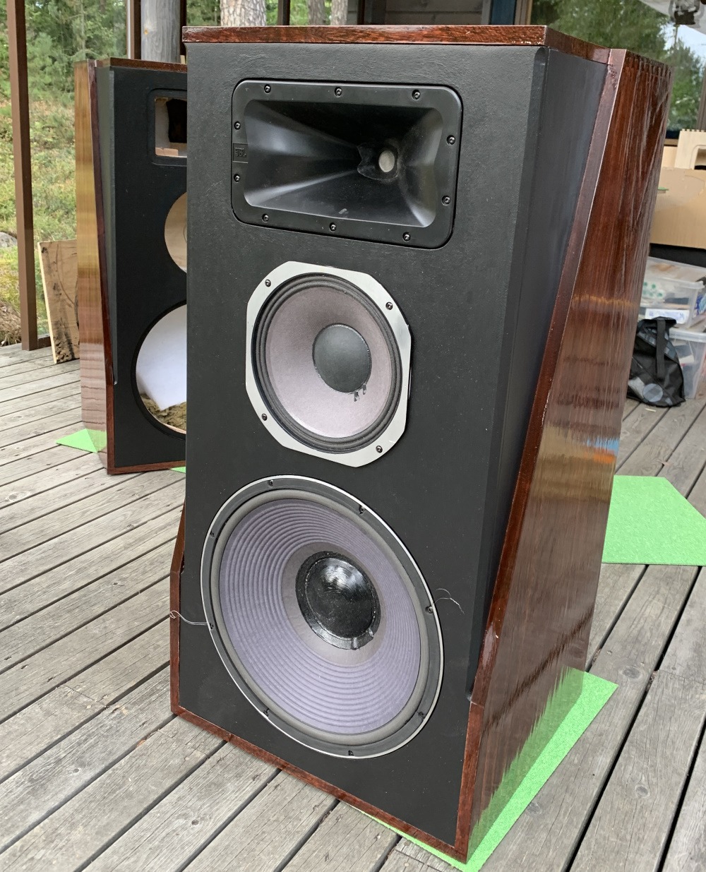

The waveguide I have used in my DIY SP2-JBL speakers is JBL 5006815 1.4 which is JBL use in these speakers:
STX825, SRX812P, SRX815P, VTX-F12 and VTX-F15

My mistake I did write on the measurement picture "Equalisation Psychoacoustic". It was meant to say that the curve Smoothing was Psychoacoustic.Here are some pictures and measurements that I did outside.

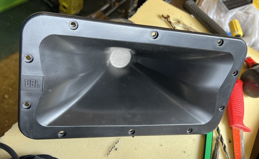

So do you have a #number so that I can compare? I thought that the JBL 5006815 has a 1.4 trout.I wasn't aware that JBL makes this PT waveguide in 1.4" also. I own the 1.5" version of it.
But the WTX-F15 and WTX -F12 use the 2430K D2 Dual diaphragm driver that has a 1.5" exit driver.
STX825 use the 2453H-SL that has a 1.5" exite.
The SB Audience Rosso 65CDN-T has a 1.4" exit and I can now see that maybe it is 0.1" smaller than the waveguides trout.
So it seems that the trout of the JBL 5006815 waveguide is 1.5".
But it is confusing that The Speaker Exchange say --> Set up for 4 or 2 bolt pattern. 1”-1.3” throat
I had a look at mine and yes, it says 5006815. I have some 1.5" 2430 drivers mounted to them and they fit perfectly. Because it looks like a perfect fit on your photography I thought there must be a 1.4" version as well. Sorry for the confusion !

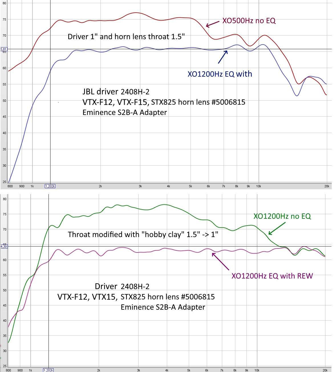

I have earlier used 5006815 waveguides with JBL 2408H-2 driver that has a 1" exit.
I did narrow the trout using black hobby clay. It was easy to apply and see the measurement below how well it did work.
I don't think there is much value in using clay to fit a 1.4" driver to a 1.5" trout. There are many other problems to solve as the measurements look great with no EQ needed.
My goal with these speakers is to have a workhorse to learn how to measure and design FIR XQ and EQ filters. The style is classic JBL monitors so there are some compromises regarding diffraction, driver placements etc.
The mid 10" drivers are JBL 2123 that I found as new unused. The 15" is 2235 that I have recon with massring. The box is closed so with room gain I reach down to 20Hz. I did therefore sell my subs that did not add anything to the table.
