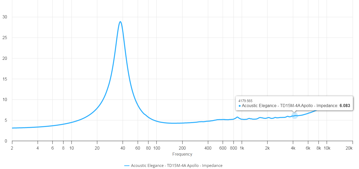

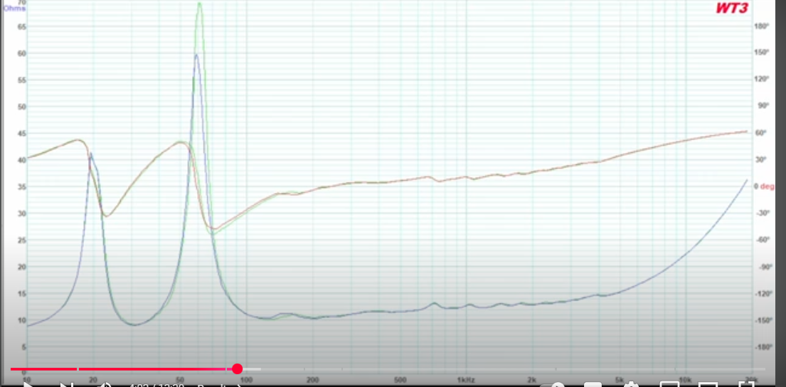

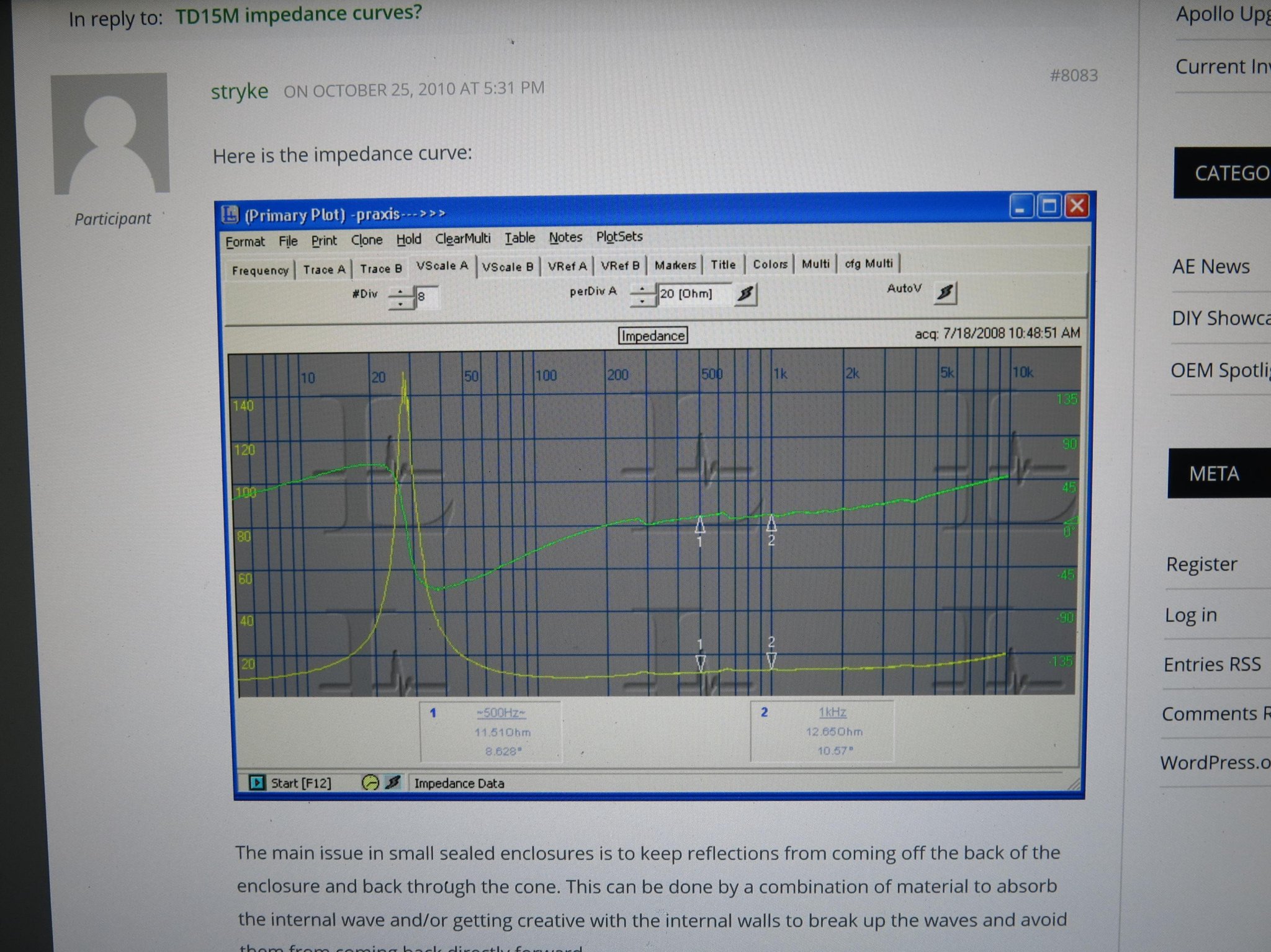

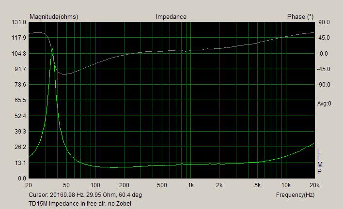

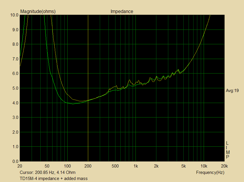

Have you seen any frequency response charts (at a fair resolution) or impedance graphs of the TD15M?

https://www.justdiyit.com/acoustic-elegance-td15m/or impedance graphs of the TD15M?
