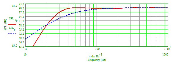

I've taken a quick look; something along these lines should do nicely enough:
Internal dimensions (HxWxD) 48in x 9.5in x 13.5in
Zd (driver centre from internal top of cabinet) = 9.625in
Zv (vent centre from internal top of cabinet) = 45in
Vent = 3in diameter x 7.5in long. May be positioned on front, rear or side of enclosure
All internal faces lagged 1in acoustic fibreglass, F-10 felt, Ultratouch recycled denim or similar.
The alignment is lightly damped; Fb = 22Hz. 4.5in vent length gives a maximally flat Fb = F0 alignment.
CSA is fixed, as is height & location of the driver centre & vent relative to the internal top. The WxD ratio can be adjusted as desired providing CSA is maintained. Attached are 1/2 space plots of the enclosure, not including diffraction effects & step loss, so those will have to be factored into the crossover design, as usual.

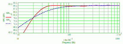

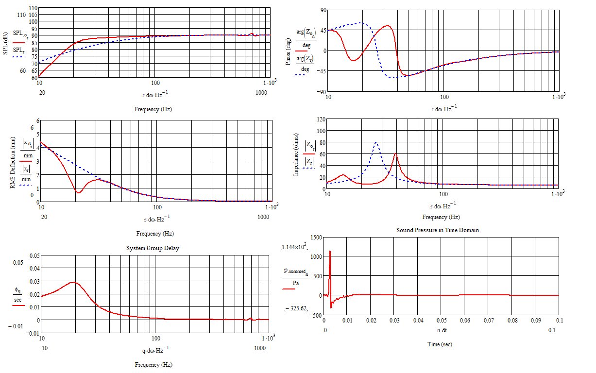

ML-TL for the SB23
Real quickly I modeled an ML-TL for the SB23 using the same T/S measurements I used for the Sonatello design (that I sent to Beau). The line is 60" long with a constant cross-section that's 10"W x 7"D. The woofer's center is located 12" from the beginning of the line and the mass-loading port's center is located 3.5" from the end of the line. I modeled with port dimensions of 2.5"D x 4"L. The first half of the line's length is stuffed with polyester fiber at a density of 0.75 lb/ft3 (about 14 ounces total of poly fiber). The system tuning frequency is 28 Hz and I modeled with 0.25 ohms added in series with the woofer as occurred via the crossover in my Sonatello build. I've attached the modeled anechoic system bass response (red line) for an input of 2.83v/1m (baffle step losses and room effects not taken into account, obviously). For an input of 28 watts into this actual impedance of 6 ohms, the woofer's excursion will reach Xmax+15% (my design default) at a frequency of 40 Hz, and the port's air velocity will peak at just above 17 m/s at a frequency of ~23 Hz, with the system output being ~103 dB SPL above the knee in the response curve. If you make the port's diameter 3", it needs to be 5.5" long, which will lower the port's air velocity to 12 m/s for a 28-watt input and a driver excursion of Xmax+15%. The clearance between the internal entrance of the port will only be 2.25" instead of "1 pipe diameter" that's often recommended, however.
Paul
Paul
Hi Paul.
I didn't make it clear maybe.
Your mltl design was for the Seas CA18RNX, not the SB23...
Your design was for a single woofer, I doubled the cross section and added a second woofer. It's about 100 liters net, so it is a substancial pair of speakers!
Cbarth
Cbarth
