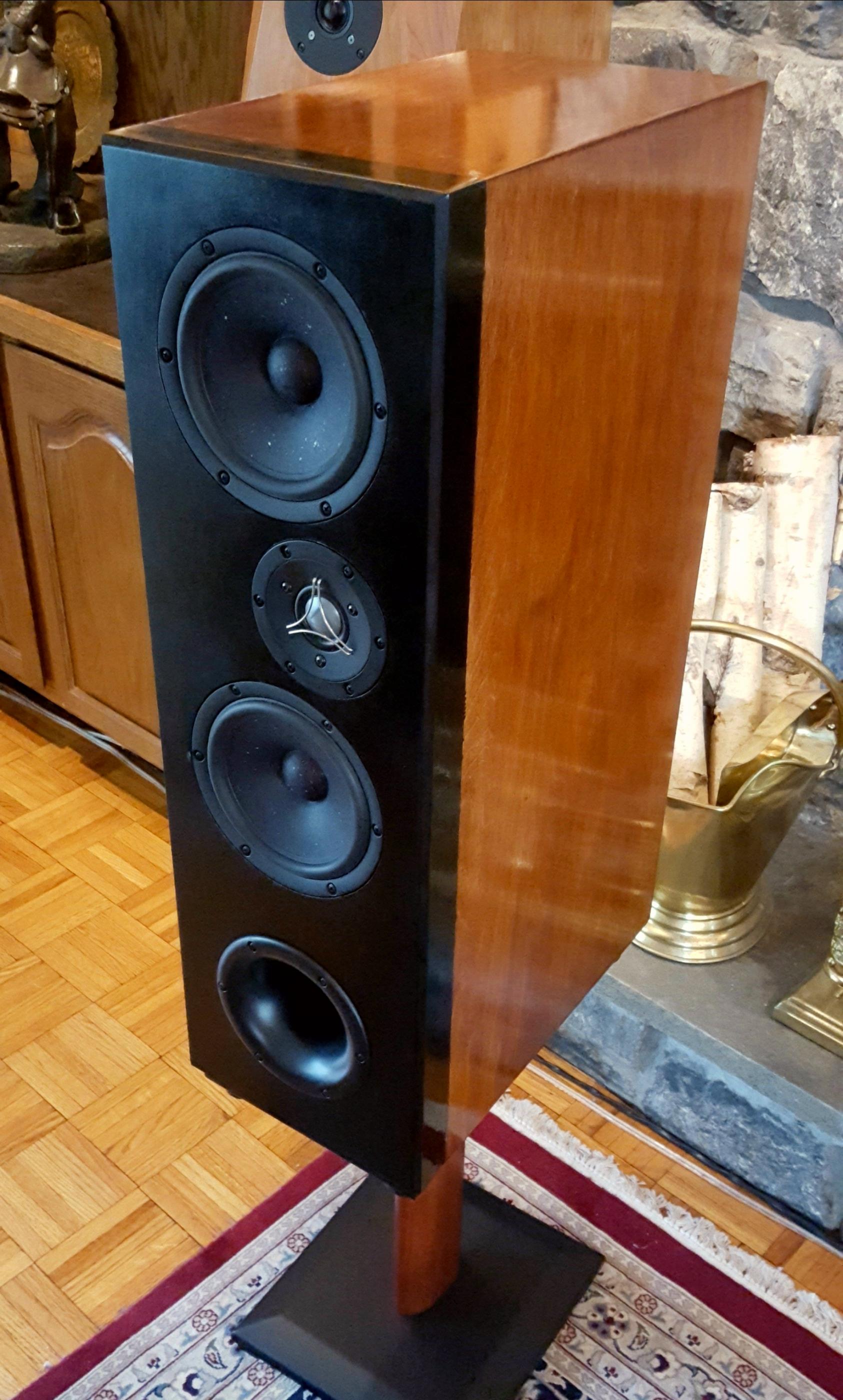

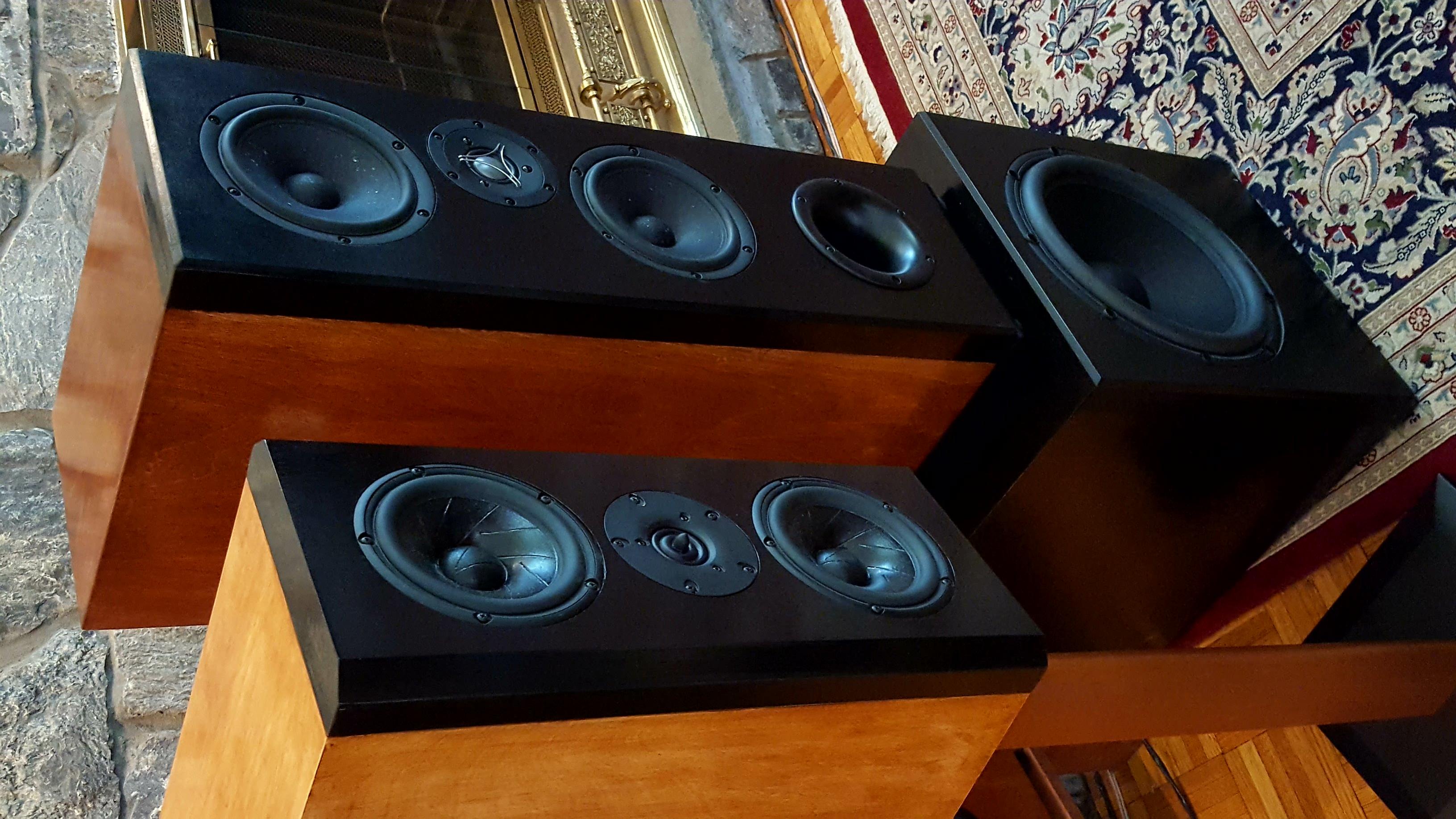

Here's Troels' SB MTM D'Appolito speaker build. Instead of floorstanders, these speakers sit atop a stereo pair of subs. Maintaining front baffle width, the height was decreased, and the depth was increased to yield 40L. The cabinet measures 29.5in x 9in x 15in. Instead of 20mm, 25mm Baltic Birch was used on the sides and back, and 38mm black MDF for the front baffle.
Maturity of sound was achieved after 20 hours of break-in. Prior to this construction, I had built the Ellam D'Appos. It was only natural to compare the SBA MTM with the Ellam D'Appo. I was very impressed with the Ellam D'Appos. However, the SBA MTM is a clear uprade from the Ellam D'Appos offering greater transparency, dynamics, image, extension. The 15W mid is an exemplary driver of midrange clarity, smoothness, detail, and potent bass. Surprisingly, the 5.5in Ellam D'Appo delivers as much bass at half the volume of the 6.5in SBA MTM. The price is efficiency, as the Ellam D'Appo is 4dB less efficient than the SBA MTM-16s. Perhaps, the SBA MTM-16's drier bass could also be from its thicker enclosure and more bracing?
Compared to the heavier coned Scan-Speak 18W and 18WU midrwoofers in my other speakers, the light cone weight of the MW16 also produces faster transients and more transparency in the mids. The lack of compression in the mids at high volume is also impressive. The treble is where the SB MTMs higher sensitivity renders inner detail with more clarity, dynamic contrast. The Be tweeter offers more clarity, air, and blacker background than soft- or other metal-domes. The Be tweeter clearly shows more accuity and definition of timbre without smear or veiling of detail in highs. Overall, the soundstage is open, airy, and spacious. Tonality and timbre are well balanced.
The SBA MTM produces a neutral, coherent, detailed, dynamic, open, airy, spacious sound. These speakers are equally suited for analog or digital sources, and solid state or tube gear due to its spectral balance and sonic neutrality. The high efficiency makes them ideal for my KT88 push-pull amp as the difference can be heard.

Many thanks, LineSource! I didn't have polar radiation goals in mind. However, I knew that the vertical null would be anticipated, as in Martin's MTM polar response. Great information! Besides, I was expecting that D'Appolitos would project strongly in the horizontal plane. I find that one of its attributes is the minimal ceiling and floor reflections. It's best when listening in a fixed seated position, and it's not a speaker for roaming around the room doing errands. 🙂 If you do, the airy magic is lost. The MTM's other attibute is its nearfield imaging at a distance. It's like listening to nearfield monitors at 10-15ft away.
The MW16P and TW29BN are extremely transparent drivers. It's motor structure produces minimal distortion and minimal compression at high volumes. The crossover point is low, so be careful to voice the tweeter resistor. I did change the tweeter resistor to 3.3 Ohm from the recommended 2.7 Ohm for the Be dome. I confirmed this with 3 different setups. Any perceived brightness is now tonally neutral.

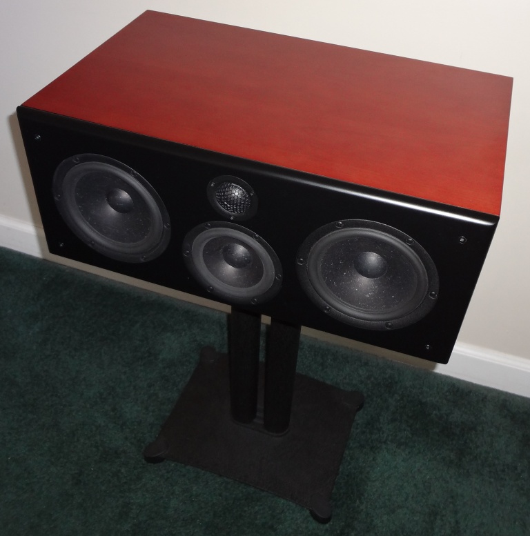

1) SBA Center Channel: (2) MW19P-8 + MR13P-4 + D3004/6040-10 Be

(2) MW19P-8 + MR13P-4 + Scanspeak Illuminator D3004/6040-10 Beryllium tweeter

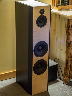

Rick's Ancora (or "anchor" in Italian) features the SB Acoustics Satori 5" and 6.5" drivers, with the Scan-Speak Illuminator dome tweeter

I wasn't aware that Selah was using the same drivers. My goal was to have a matching SBA center channel that was equivalent to Troel's 8008 Center with 8" drivers. The choice of tweeter was based on FR and small diameter. I'm looking forward to changing my current Paradigm Studio Center Channel.

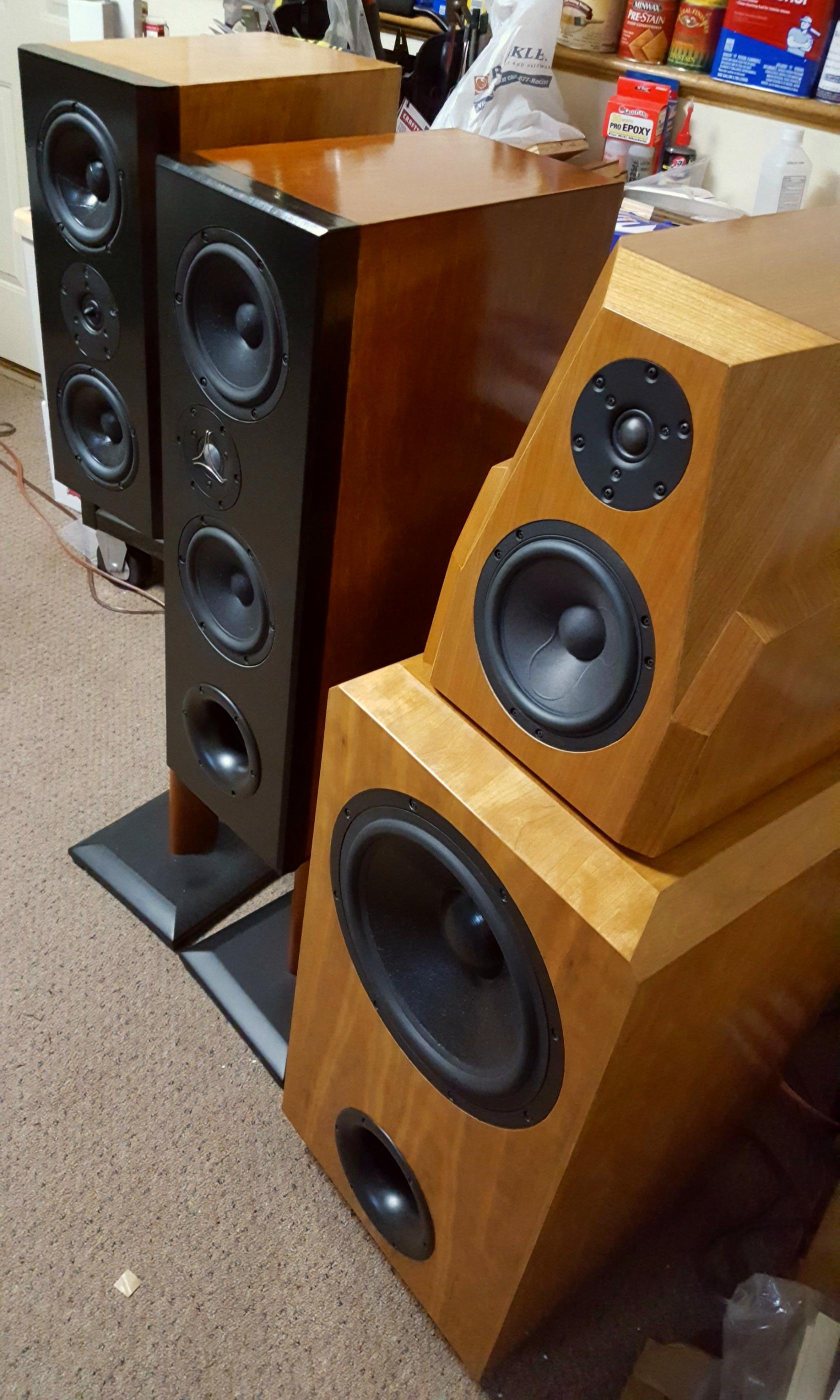

How do they compare with your GeerS eVe II style speakers that you also have pictured which is using the Scanspeak Illuminator mid?
The Geers eVe II uses the ScanSpeak Classic line drivers - 21/8555-01, 18W/8545, D2904-98000 in a 2.5-way, series-fed mid/tweeter, parallel woofer. The Mundorf Supreme Caps sound amazing with the paper/carbon cones. These have more holography, dimensionality, dynamics, and spaciousness than the SBA MTM 16. The high efficiency of the eVes match well with tube or solid state gear. 2.5-way strikes the best balance in sound quality, naturalness, and musical experience. I'm actually going to make a Satori eVe version of this 2.5-way using the ScanSpeak 22W/8851T00, SB MW16P-8, and TW29BN-B.
The MTM crossover includes the Jantzen Alumen Z. The MTM excels in transparency and naturalness. The Be tweeter is smooth and airy. The D'Appolito design yields limited vertical dispersion, but excels in horizontal dispersion - so keep tweeter @ ear level on stands!
The custom 13" 3-way uses Visaton TIW-300, 18WU/8741T00, D3004/66000. Crossover is a series-fed 3-way mid/tweeter with parallel woofer. Large mid caps are the Jantzen Superior Z, and the tweeter caps are Audyn Reference and Mundorf Silver/Oil. These excel in throwing an even a larger image, dynamics, and frequency extension over the MTM. 13in 3-way matches better with solid state than tube gear due to the lower 86dB SPL.
The efficient SBA MTM matches better to my 6SN7 tube preamp, and push-pull KT88 amp setup than my solid state Odyssey Tempest preamp and Dual Mono Amp gear. The
