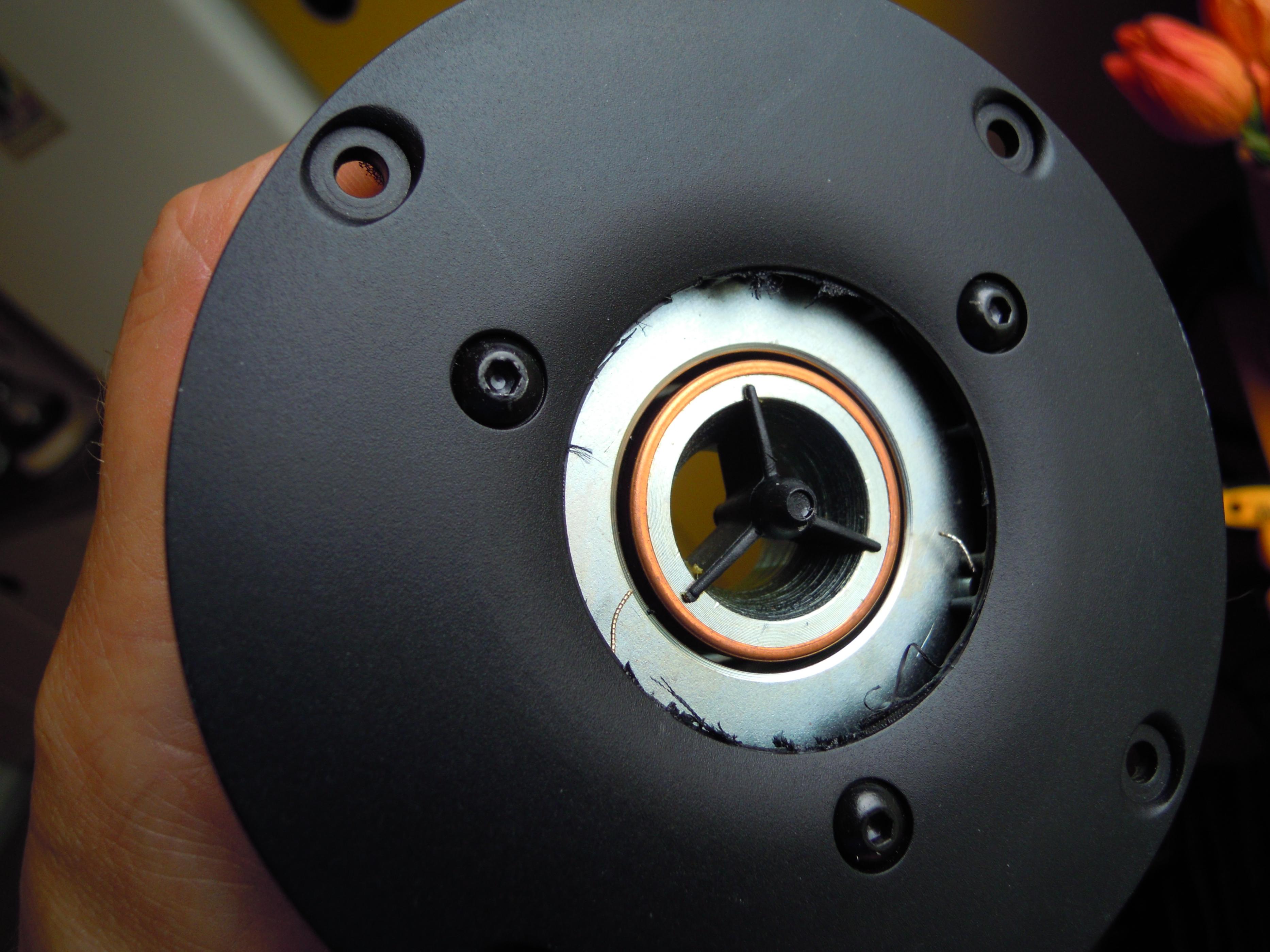

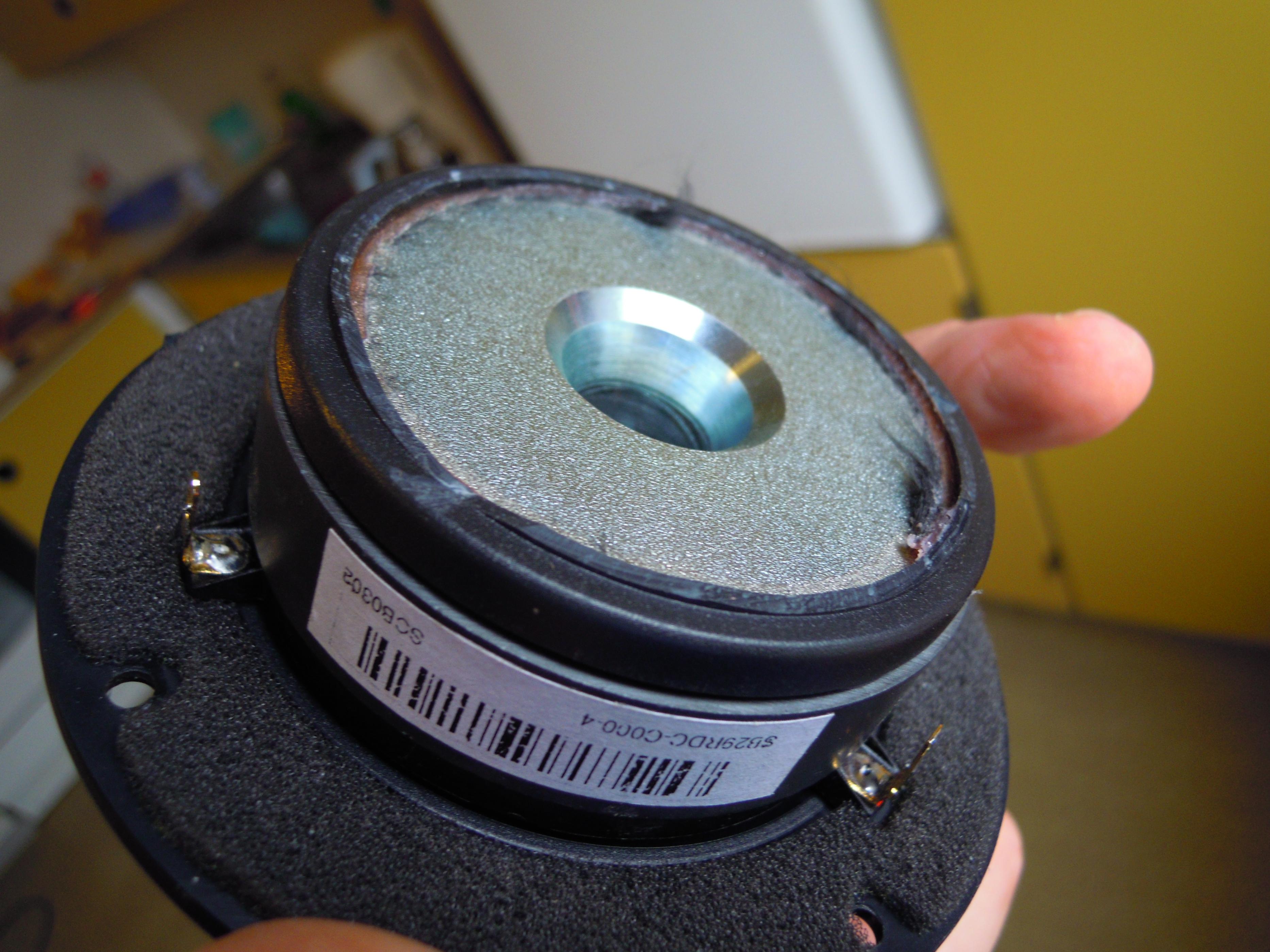

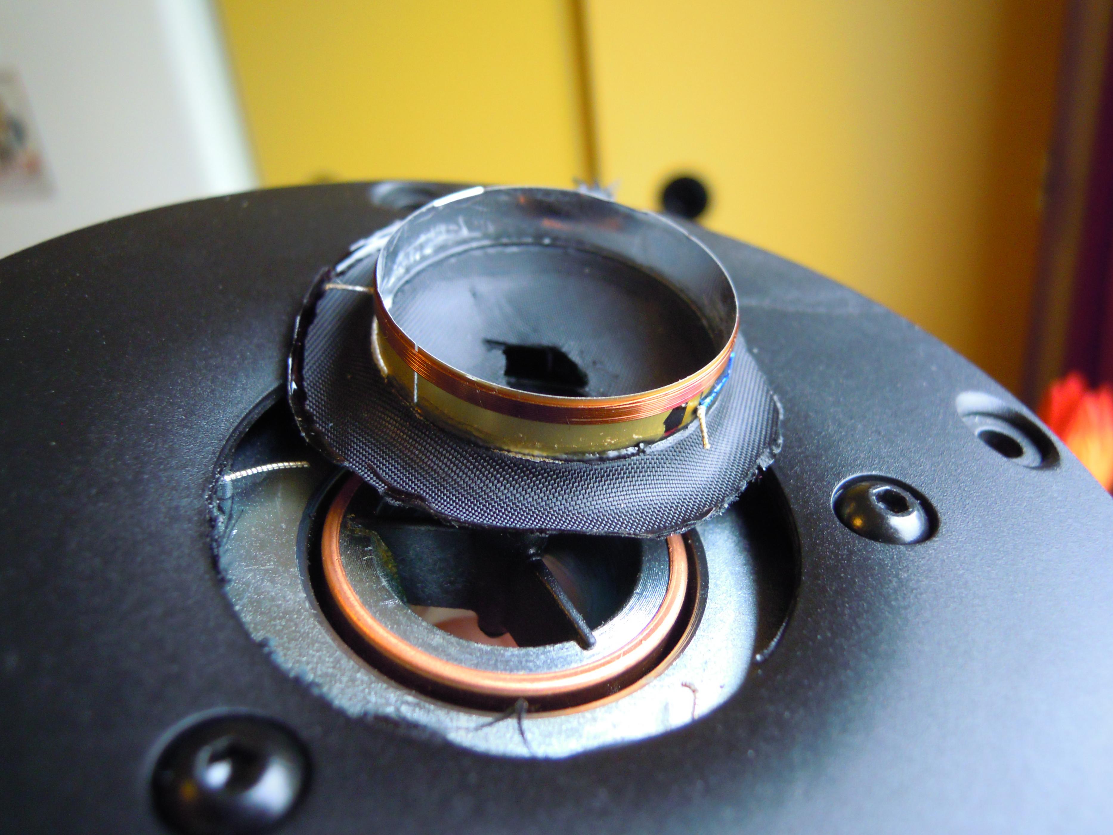

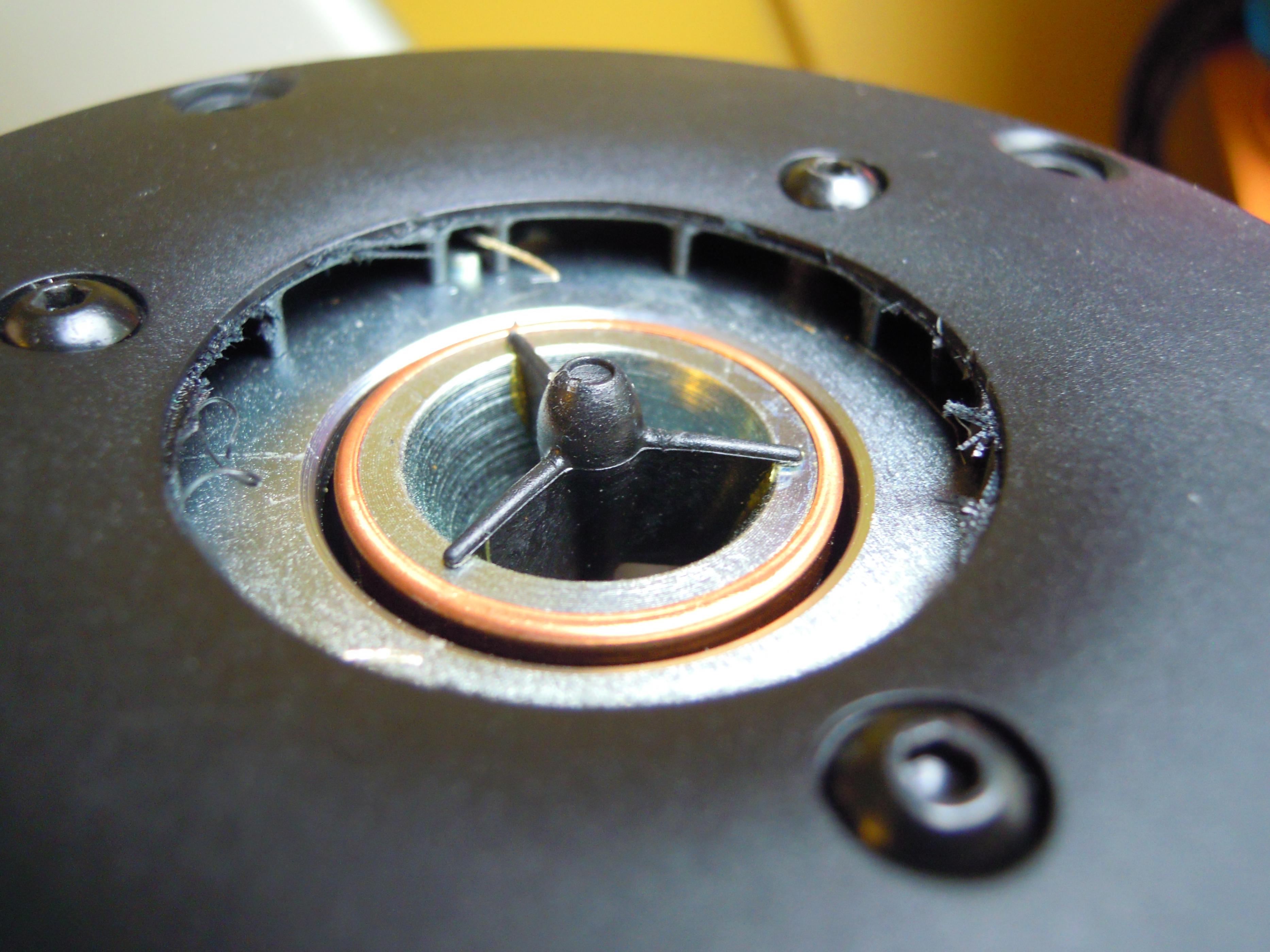

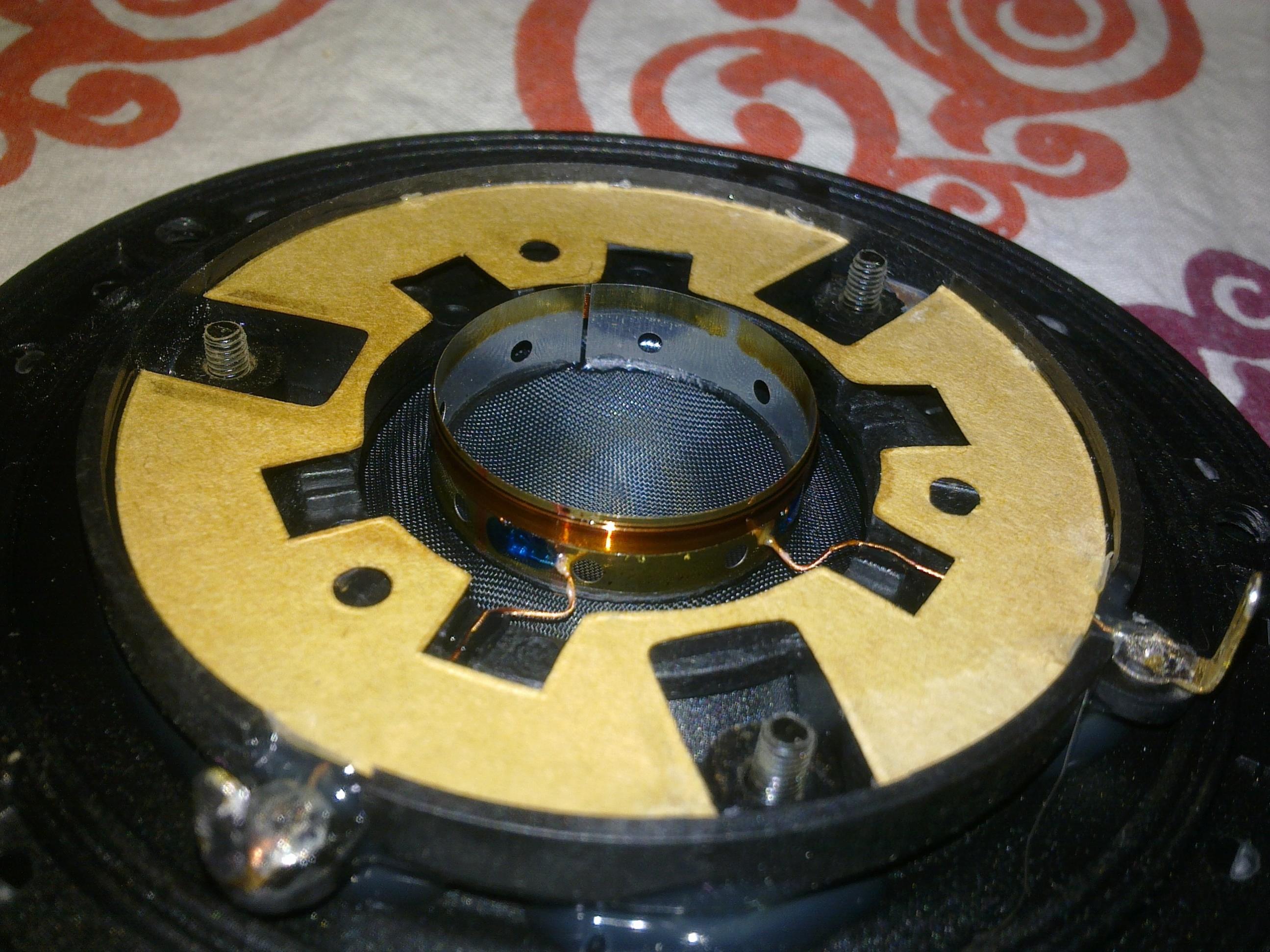

Here I am more then a year later and still nothing so i was thinking why not share some gut n blood pics? I've never seen a SB29 opended up so why not? 🙂😀 As maybe some of you know, they are glued to together so only way to see one inside is to cut it open and that's what i did.

Did you remove those button head cap screws on the face plate?
Yes i did on another one but the dome is glued to magnet. It's only the plastic "part" you can remove..
that's just horrible.
and how come that soft dome popped out?.not from the shipping?
No, I cut it opened cuz the tweeter was just laying around for months... i couldn't even listen to it. SO the tweeter looked alright at arrival but i instantly saw and heard that something was wrong (horrible distorsion) didn't even bother to measure it or take a impedance sweap. I thought ofcourse i'm gonna get a replacement from Europe audio..

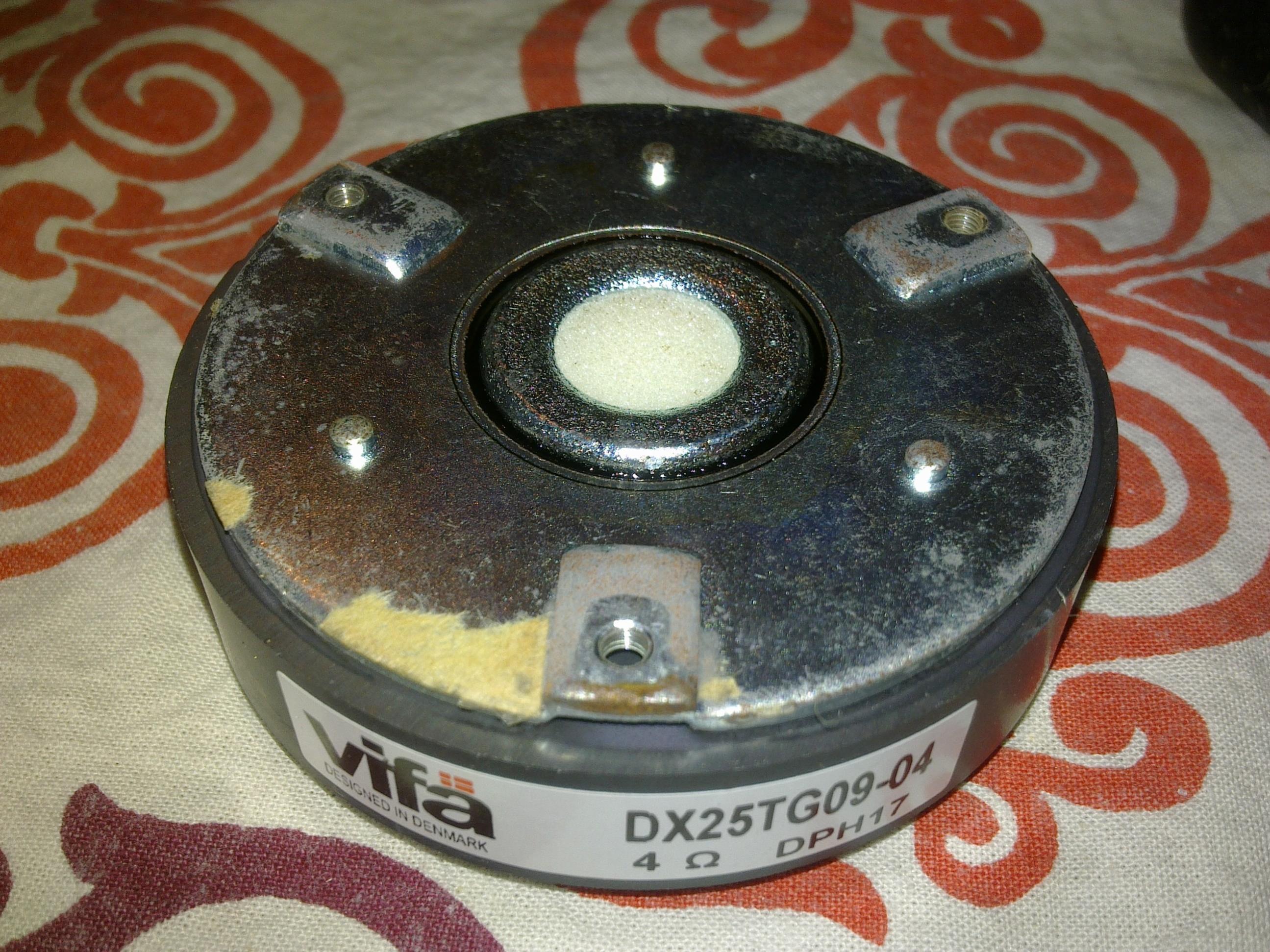

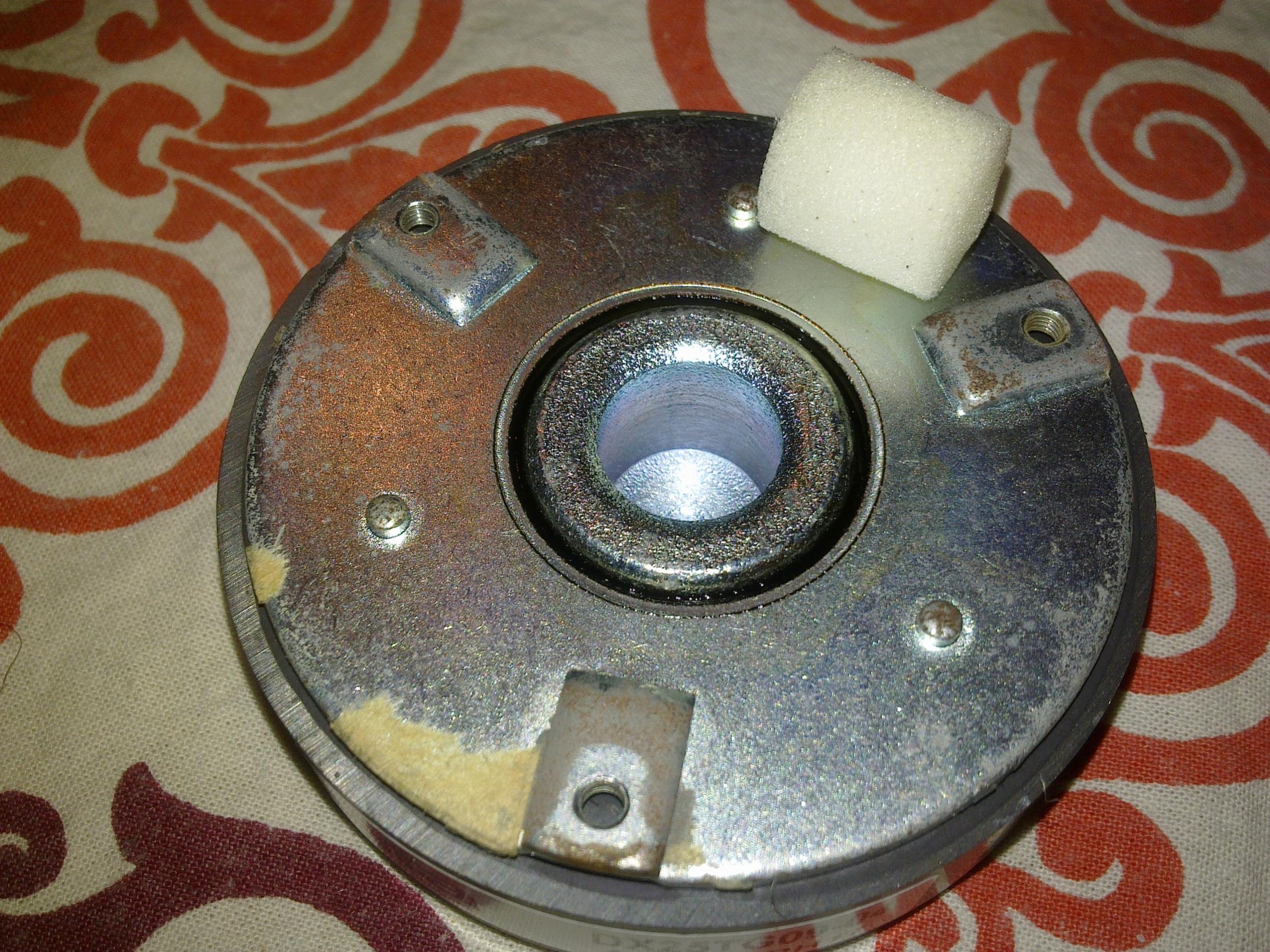

Here is 3 pics of a VIFA DX25 i bought from them too 3 yrs ago. Pics was taken right after package was opened. I've noticed rust right away. Normal??
it's normal if they've been stored in humid storage..you can use some liquids to remove the rust (i forget the name of the liquid)
Rust converter
I think this is the only SB29 dimple dome I've seen been opened up. I like that there is copper ring, (like stated) and most cornes have a 45 degree angle (more or less) and it looks well thought out. Only thing i got surprised about is that there is no ventilation holes in voice coil former ??
The "dimple" was press glued to the middle plastic nose with some sticky glue.

Since this tweeter does not use ferrofluid, + it is well ventilated through the pole plate, there is no reason for voice coil former perforations (it is used with "flat-top" pole piece tweeters with ferrofluid, to reduce air compression effect underneath the center dome)
