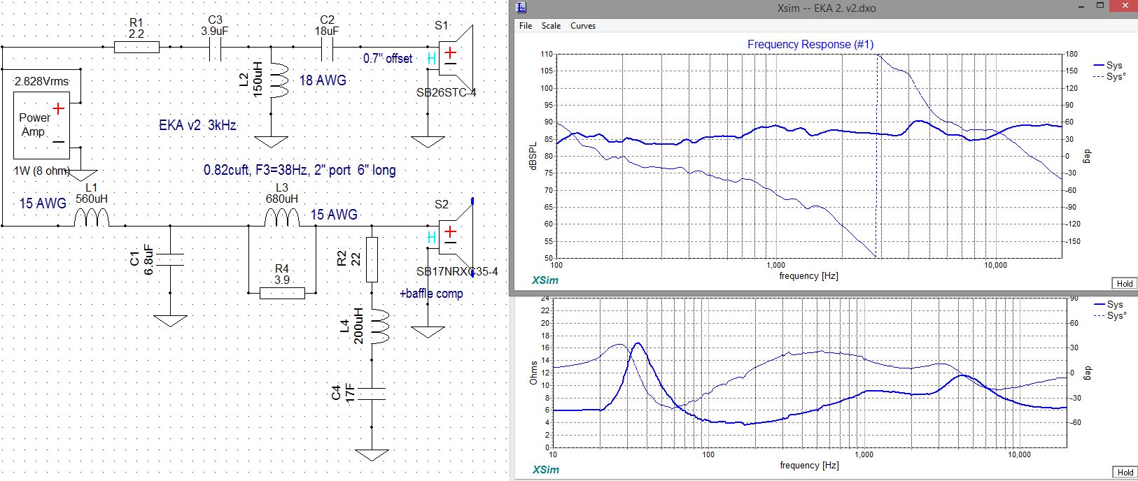

I see nothing wrong with this kit design whatever. This is actually the new Mark II EKA design which adresses any cone breakup from the woofer with a 3.1kHz crossover. You will always trade off tweeter distortion versus cone breakup and take your beating on dispersion.
There is a breakup notch around 5kHz, which does the right things. Looks like an excellent speaker for a smallish room to me. 6" bass is usually criticised for light bass, so wall placement ought to be OK.
I hope you tell us how you get on, kalinowski. Nothing like actually doing it in the end! 🙂
My quick on-axis sim of the SB Acoustics EKA revision2 design including baffle effects shows a midwoofer SPL bump from the paper cone breakup around 4-5kHz.Read discussion forums on crossover points to make an informed decision.
With a 6.5" diameter cone, the 15-30 degree off axis SPL around 4-5kHz may be smoother. Against the wall placement might be assumed common.

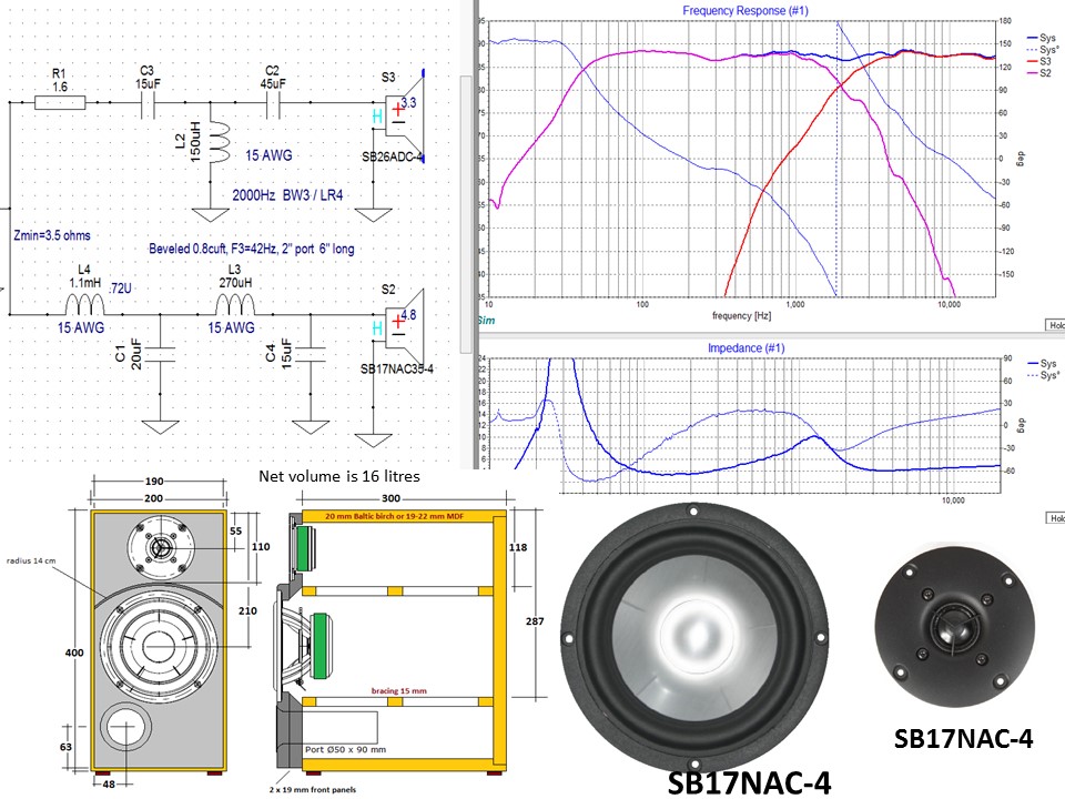

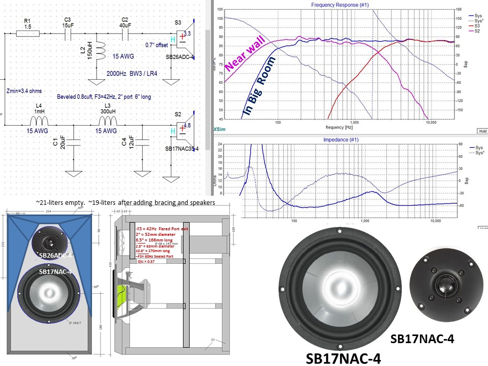

Today.... I would spend your money on the SB_Acoustics aluminum cone SB17NAC35-4 and SB26ADC-4 with a 2,000Hz crossover which tracks Troels' design - can you cut edge bevels? like stepped-baffle tech?
SEARCH for cabinets+crossovers which use the SB17NAC35-4 + SB26ADC-4
Thanks for the advice! I had my eyes on that Troels' design too.
I would rather do a flat baffle with roundover edges.

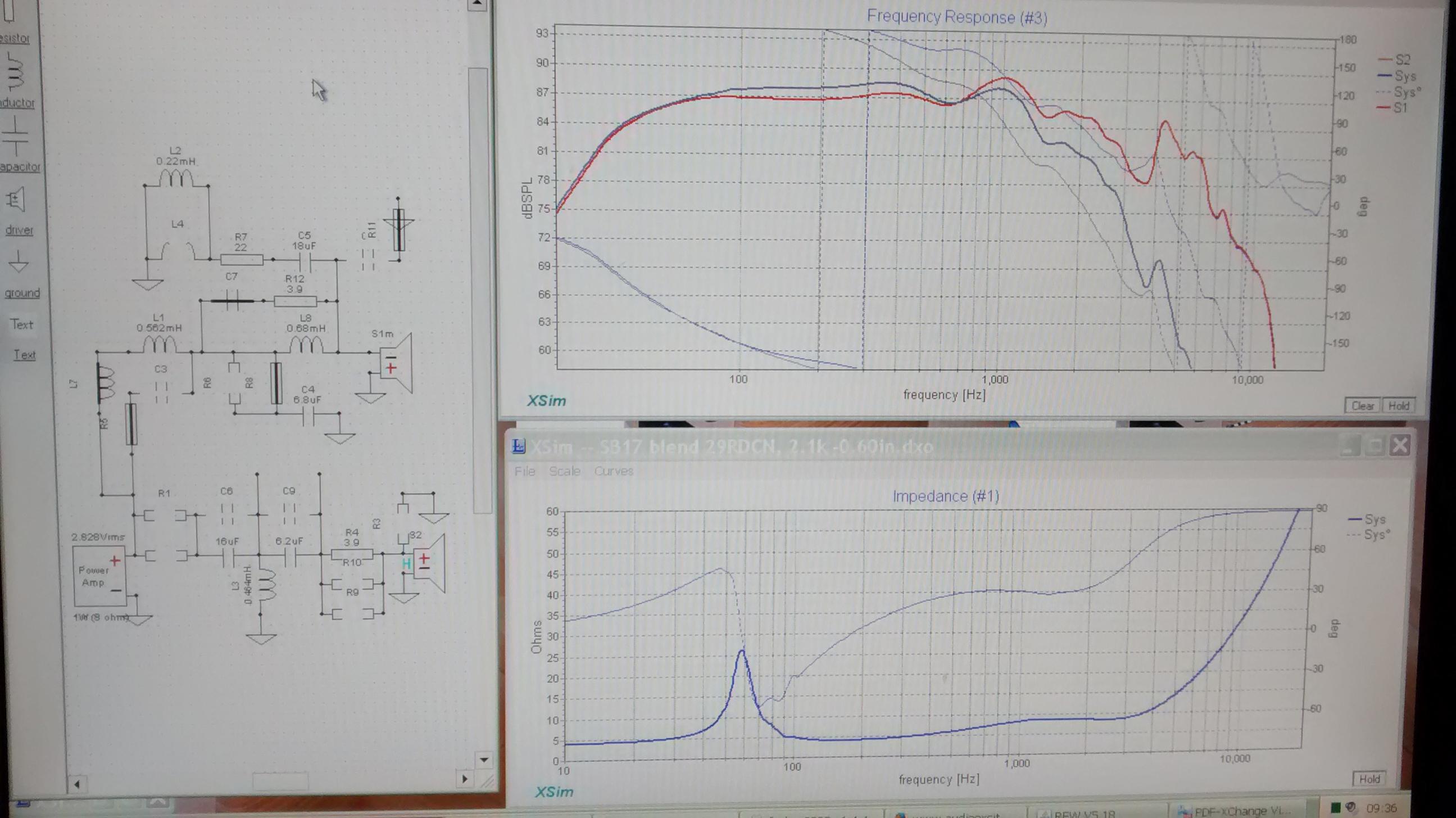

Wow, LineSource I tried to simulate the V2 x-o, midbass section and looks like the 4.2k break up is still there, big hole around 3.6k and bump around 1k. Horrible design IMO, will sound like a pair of headphones by Dre. Are you getting something similar to what I'm describing.
