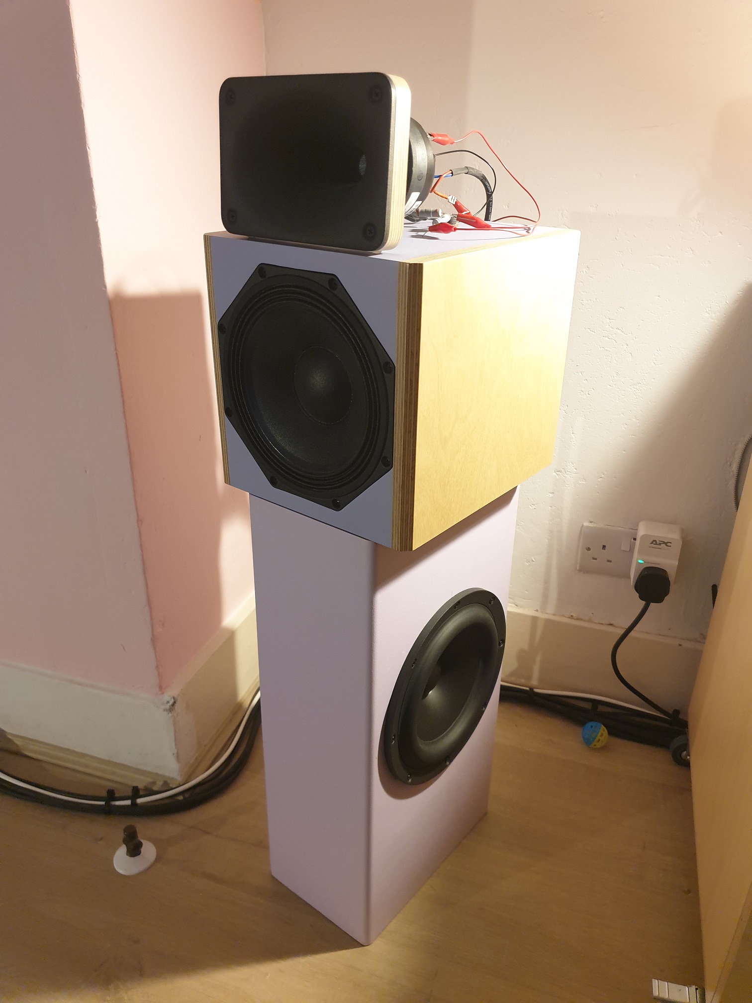

I am planning to have the two subs share a 30L+ cabinet on each side.
Here is the current stack. The sub cabinet is left over from a previous modular system made of MDF. The sub cab will match the 18mm birch ply of the midbass and be mad braced.

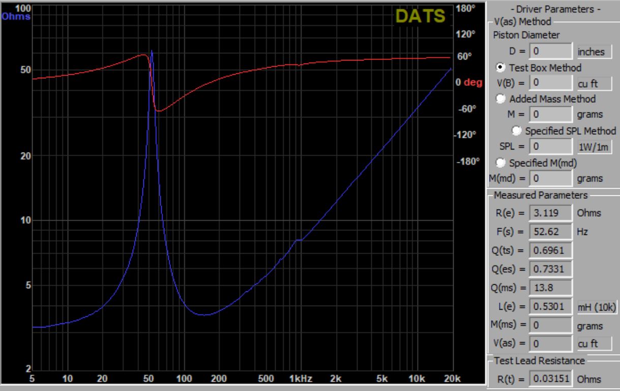

For posterity here is an impedance sweep of one of the SB23MFCL45-4 drivers in the 15L cabinet. With a QTS of 0.69 I might try and aim a little lower in the new cabinets.
attachment.php

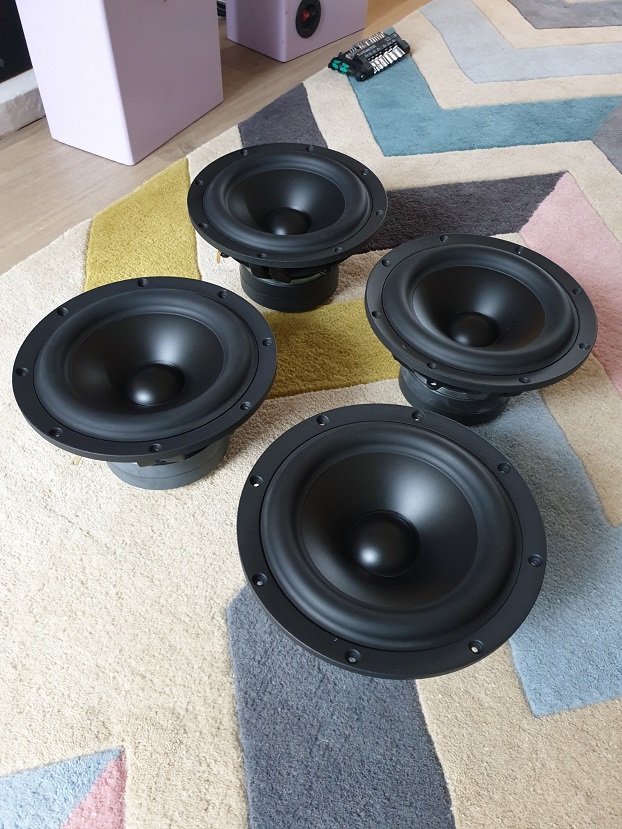

New drivers have arrived!

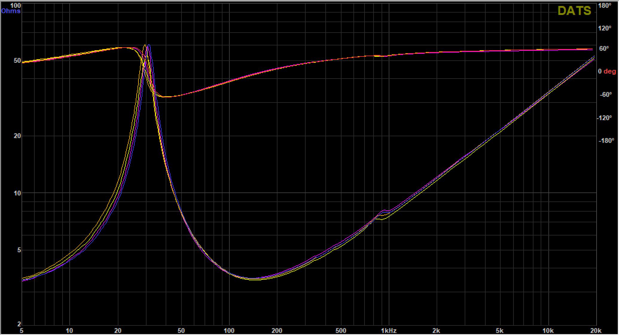

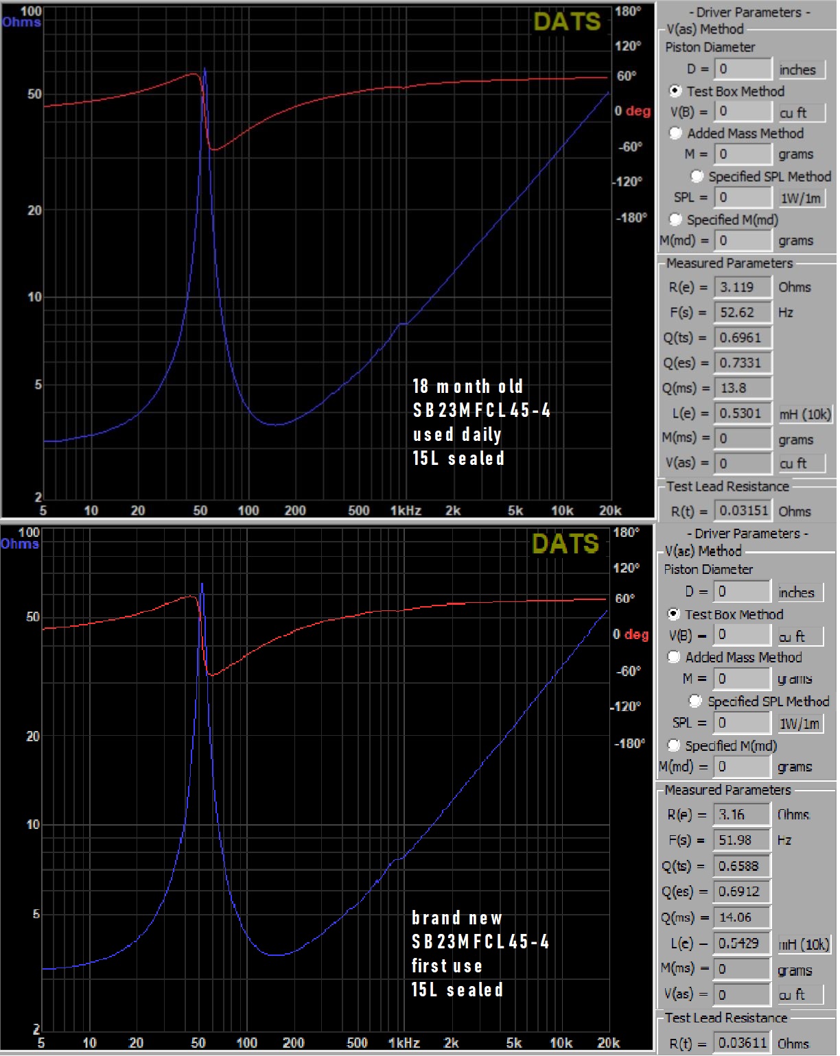

Unfortunately I didn't save the DATS projet from the last measurement but from the comparison image below they differ very little.
For example:
Old Fs = 31.3hz / 30.7hz
New Fs = 30.3hz / 29.6hz
That's close enough for me!
