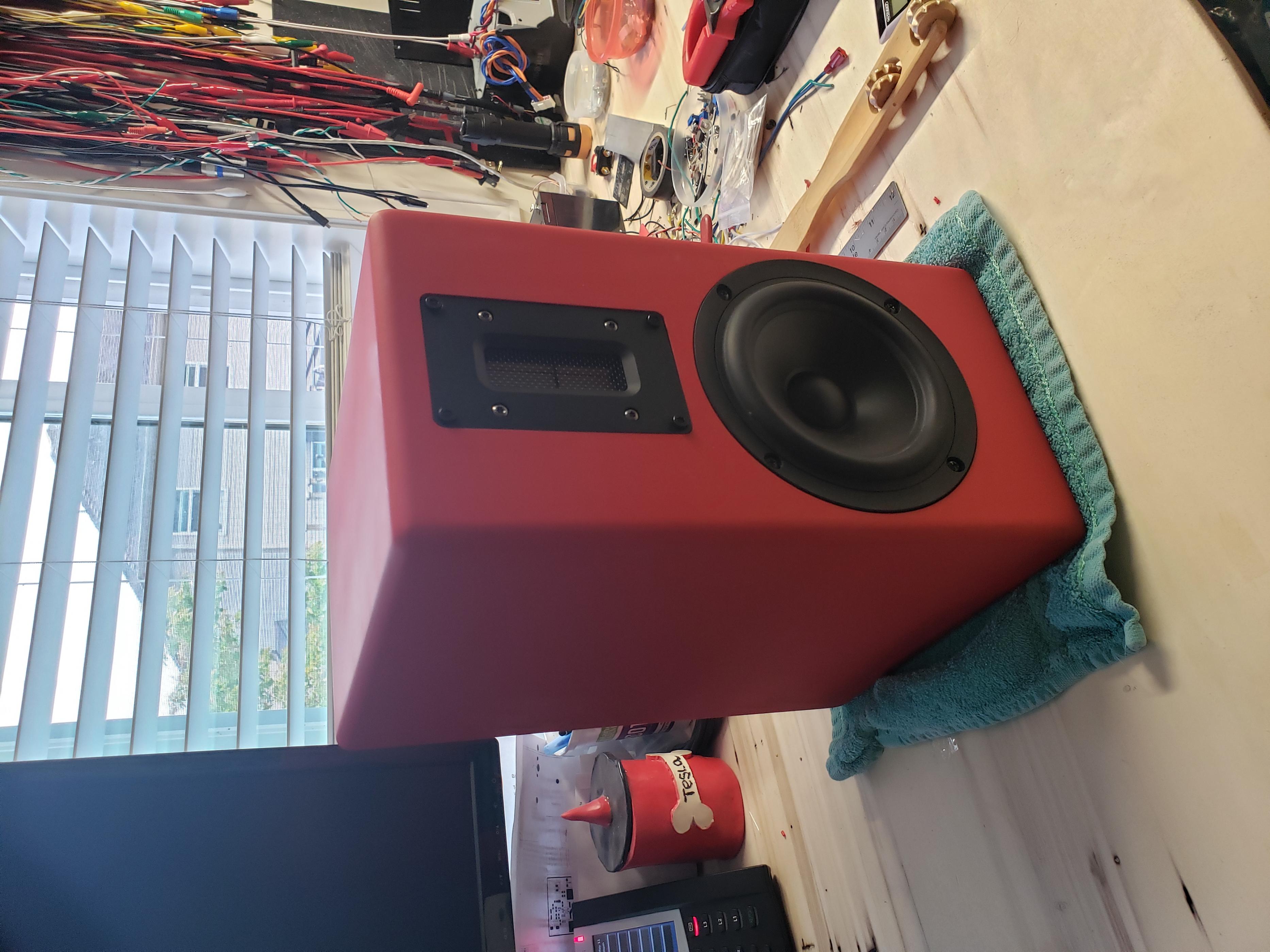

Strange, Jason my friend just build a pair of these a few months ago using the SB15MFC30-8 driver & ribbon.
🙂 : cool Terra cota color and awesome cabinet work : looks like an injected mould one.
