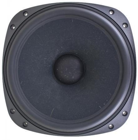

A new summer project in the works..... The SB Acoustics drivers just came in the post from Intertechnik - SB20PFC30-8 8" Woofers.
The build quality is simply amazing for the cost of these babies!!! I am more than excited to finally give these budget drivers a try.
I am going for a 2-way bookshelf design with the HiVi isodynamic RT2C tweeters crossed to the SB woofers somewhere between 4.5 - 5k. Thanks to another diyaudio member, who was kind enough to sell me the tweeters🙂

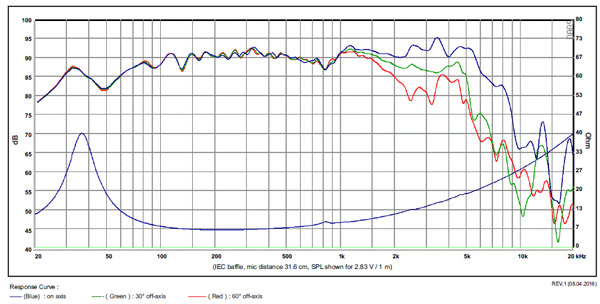

That's pretty normal efficiency for an 8-ohm woofer, after BSC probably be 84-85db.
Good combo, those SB's have really nice surprising deep base and nice mids for the price. I have used the 5" and 6" versions and was impressed. Not sure how accurate the FR is, might need a mid in teh mix??

1- the 8" will be lucky to not beam that high. 8" are really only good to about 1.5-2k before beaming.

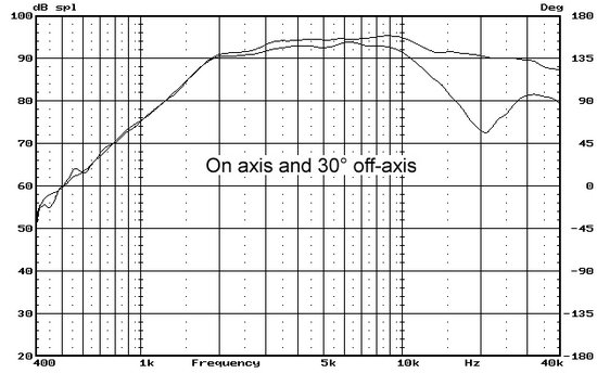

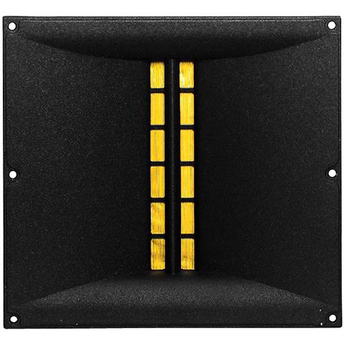

2- An HiVi RT2C is a round faceplate. They are good to approximately 2.3k at the lowest.
3- What you have, do they say Silver Flute, Dayton Audio, yindi, or Dayton Loudspeaker on the back? I'm betting you have Dayton Audio PT2-B or PT2-C. If you have a PT2C, your response graph you posted is not how they measure.

The RT2H cannot xover that low. 2.3k is about the limit of those units. 2k they sound stressed.
OP- then you have PT2C instead of RT2C- VERY different units. The FR plot you posted is for the RT2C, and is wrong for the PT2C. The PT2C (I've used them) is only good down to 2.3k (24dB) at the lowest, and 2.1k in multiples, 3k (12dB) for better usage.
This is the FR of the PT2:
https://www.parts-express.com/pedocs/specs/275-085--dayton-audio-pt2c-8-specifications.pdf
It has a peak before lowend rolloff, and a peak before highend rolloff, and a broad dip in the middle.

Looks like there is a change of plan. The tweeters arrived and they are CRAP!!!!🙁
The membranes are slack and appear to have been overheated and the neodymium magnets have literally disintegrated..... Not only is the coating wearing off, but the actual body of the magnet itself is turning to powder.😡
