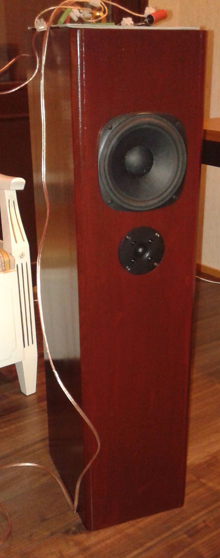

I have 2 projects: One is a competition between 3 of us in the Hungarian forum. The woofer should be from the PFC series and the budget (only speakers) is ca. 130 EUR.
I choosed 16PFC25-8 and 26ST-C000-5. The tweeter is not good, I missed the top and the stage is narrow. I like the 19ST, but would like to cross lower, need a bigger tweeter.

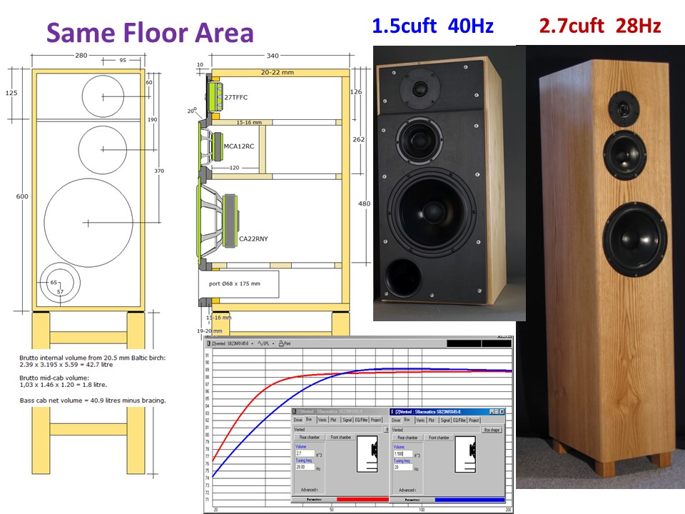

I agree that the 4” SB12MNRX25-4 is an easier crossover match for a single 8" woofer like the SB23NRX45-8. Give some thought to a 1.5cuft stand-mount cabinet like Troels Gravesens 3-way vs. a 2.7cuft floor standing cabinet with extended bass using the same floor area.
The higher efficiency MR13P-4 or MR16P-4 midrange would favor two 8" - 9" woofers, or a single 10" - 12" side mount woofer to maintain a narrow front baffle.
