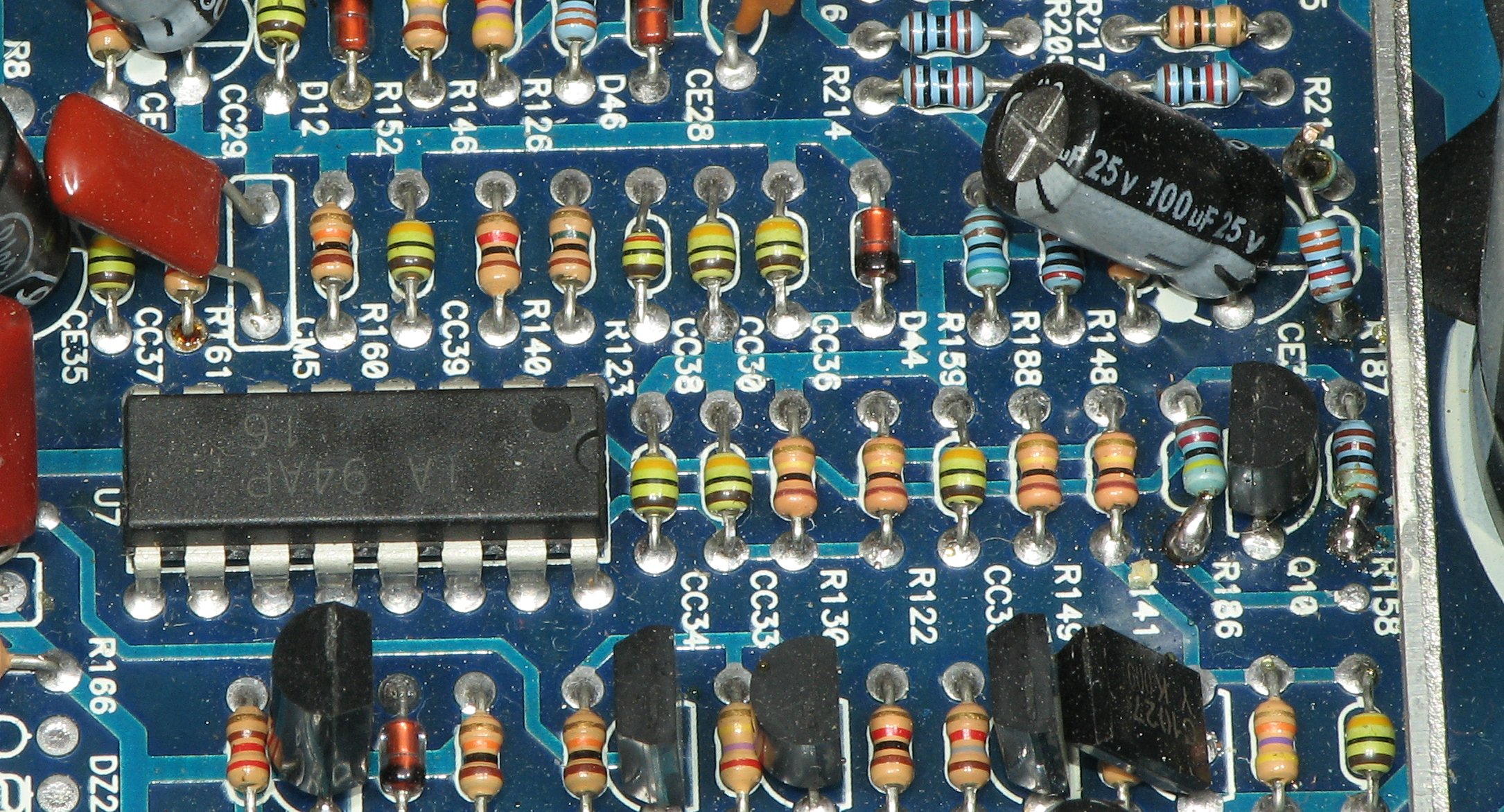

I have a SAZ-1500D V2 to repair. I have not repaired this model before, and some of the internals look questionable. I am not sure if they are standard or not. I have looked at these 2 threads and the first two questions I have look to be normal in the other threads, but I want to confirm.
http://www.diyaudio.com/forums/car-audio/277365-sundown-saz-1500d-help-identifying-zener-diodes.html
http://www.diyaudio.com/forums/car-audio/294369-class-missing.html

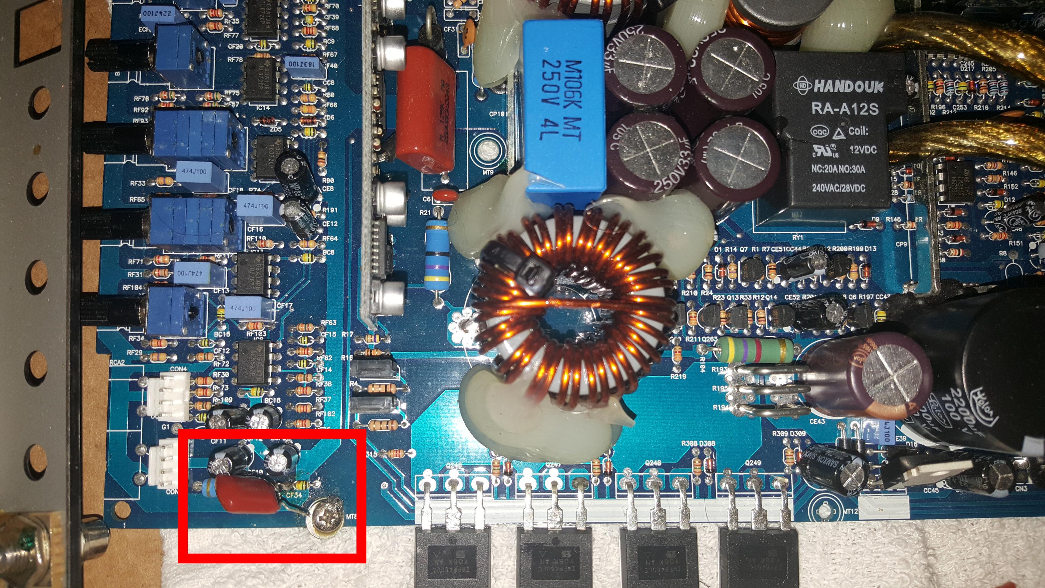

First, it looks like the cap is supposed to be connected to the screw hole, but it certainly looks like a hack.

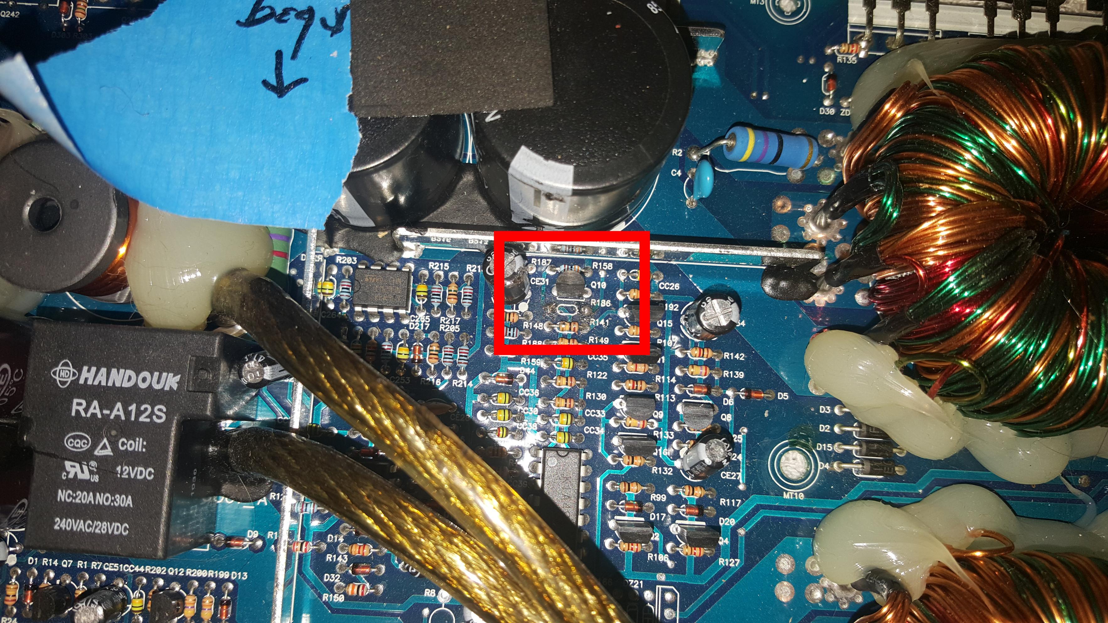

Second, U11 has a component soldered to pin 3. It looks like a decent solder job, but is still non-standard.

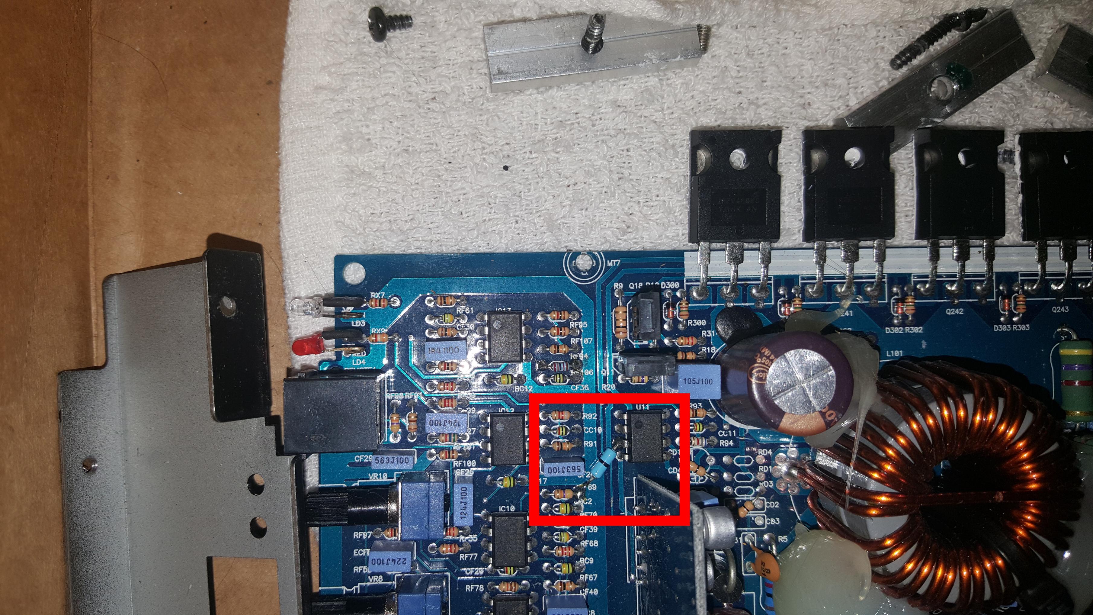

Third, R186 looks like it was floating around the amp. This is the only spot I could find that looks like a resistor was there, but is not now. The resistor I found floating around looks like a 240 ohm resistor, but I cannot confirm where it came from. Can someone confirm R186 is a 240 ohm resistor?
I have not tested the amp farther as I wanted to get the obvious taken care of. Half of the output section is shorted, so I will pull the outputs before I try to power it up.

Thanks Perry. Interesting that the resistor I found floating around is not that one. Also, it looks like I have R186 and R187 missing from my amp. R187 looks like nothing was ever there. Which way do you read those resistors? They look symmetrical in their color banding, and it makes a big difference in the value depending which way you read it!
Thanks again. I'll assume that the 4th band on both is red as it being purple would put it in the gigaohms 🙂 I'll get the right resistors in there, pull the outputs, then see where the amp stands.

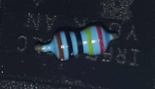

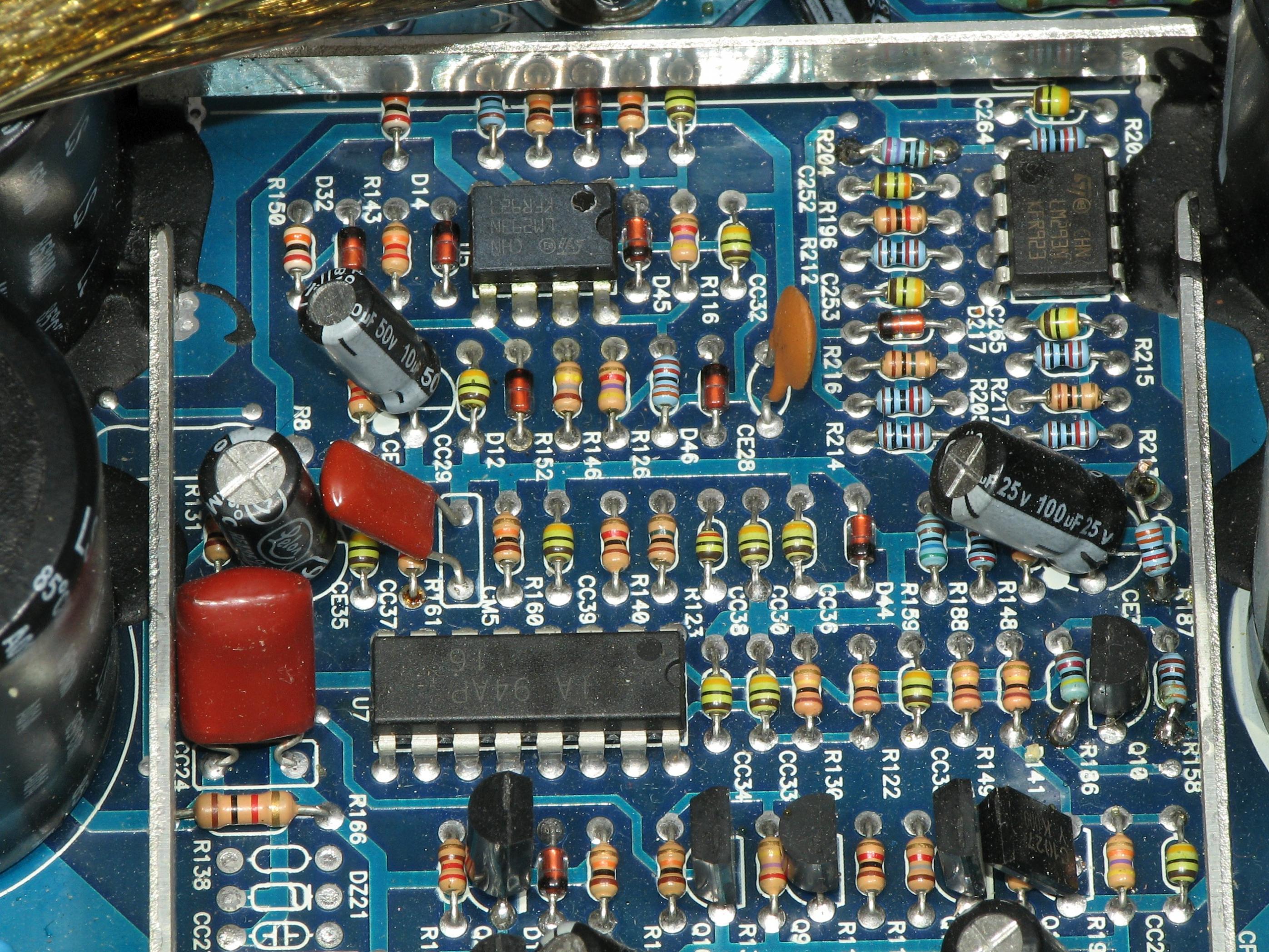

Bringing this thread back. I also found a resistor R204 that looks like it was there at one point but is not anymore. Can you send me another picture with that value? It is just off the screen up and right of the picture you sent earlier. It is right by the LM293N comparator.
Also wondering if you had any insight into the previous post. I will get some parts on order, but I'd rather only replace the parts necessary on that driver board as it can be a little bit of a pain to get to some of the chips.
See attached.
Thanks. I'll get the known resistors on order along with the JRC5532 and JRC319 IC's. I'll go about replacing just the JRC5532 first and see if that makes a clean drive signal at that point.

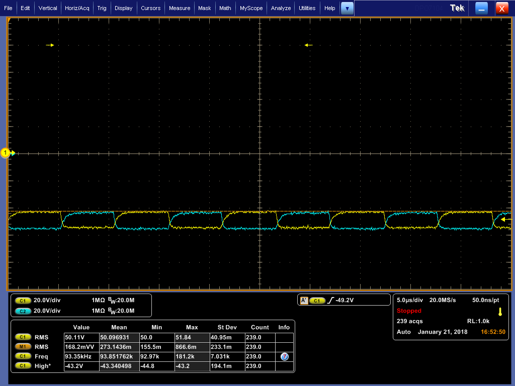

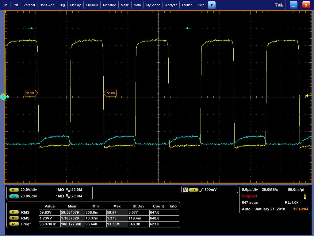

So I got the parts in, but I still have issues. I replaced the NJM5532, the NJM319, MPSA42, MPSA92, and IR2113S on the driver board. The NJM319 was replaced by a LM319, the MPSA42 by a KSP42, the MPSA92 by a KSP92, and the IR2113S by an IRS2113S. I could not find the exact originals so I went with things that I thought were appropriate replacements. Tell me if you don't think that is the case. I did not replace the MC14070B. Everything else on the driver is passive and those parts all looked good.

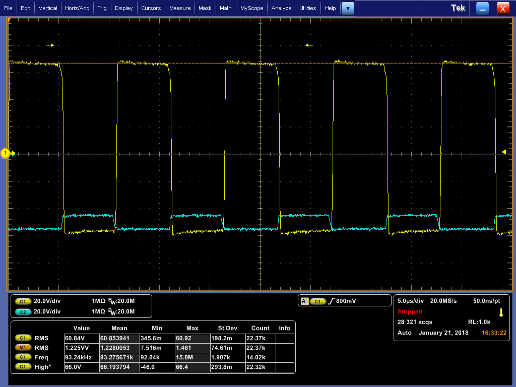

I also reinstalled all of the other parts (rectifiers and the new 4 output FET's). When I power it up, it does not go into protect, but there is a slight squeal coming from the board. I have it current protected and this was with no speaker load, so I felt comfortable with this configuration.
On the top half of the output FET's, the gates looked normal. The new replaced bottom half still looks bad. Channel 1 is top, Channel 2 is the bottom
I looked at the bases of the driver BJT's and they look similar. The bases are tied together between the PNP and NPN's it seems.

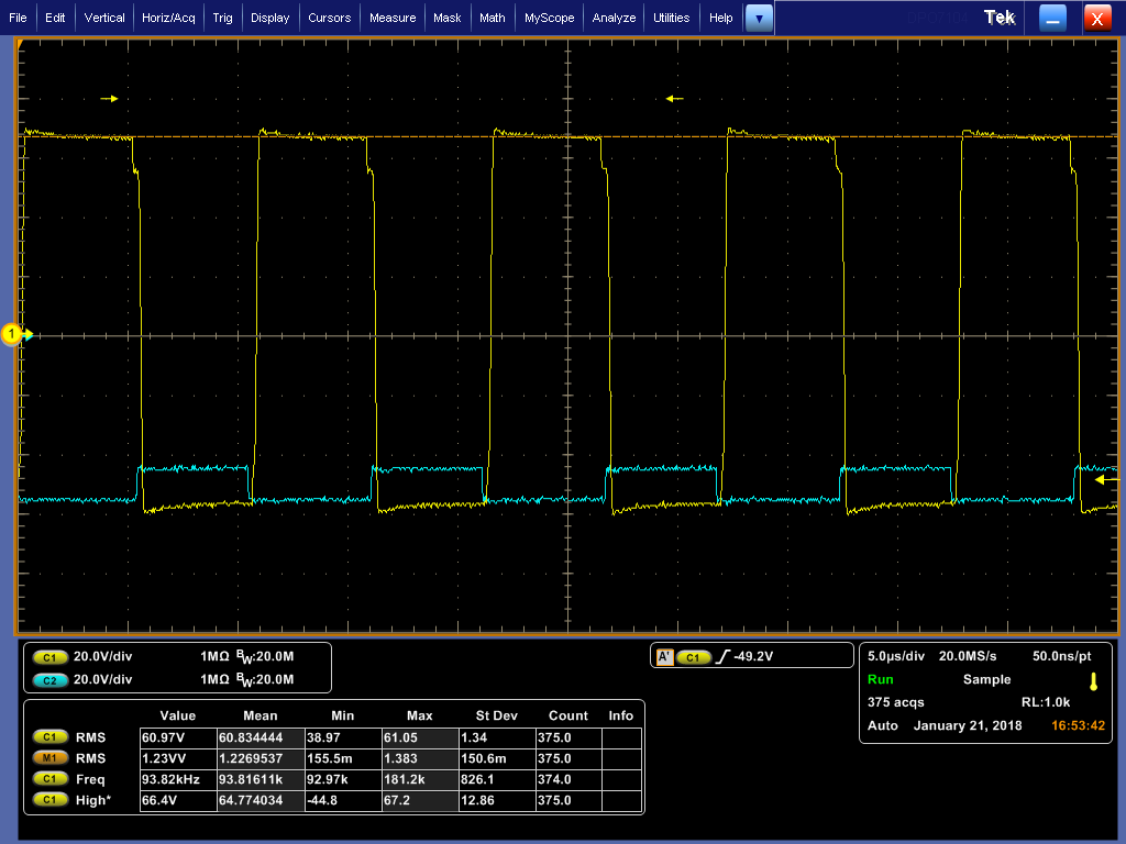

I started going back up the line to the IRS2113S then to figure out where my problem might lie. I checked the HIN and LIN pins of the IRS2113S and they look OK to me.
When I look at the HO and LO pins, I see the problem coming back. I assume the IRS2113S is OK as I just replaced it. I bugged the drivers with a multimeter previously and they seemed OK. They bug similar to the "good" top side. They are the only components I can think of that are still in line that are not new.
