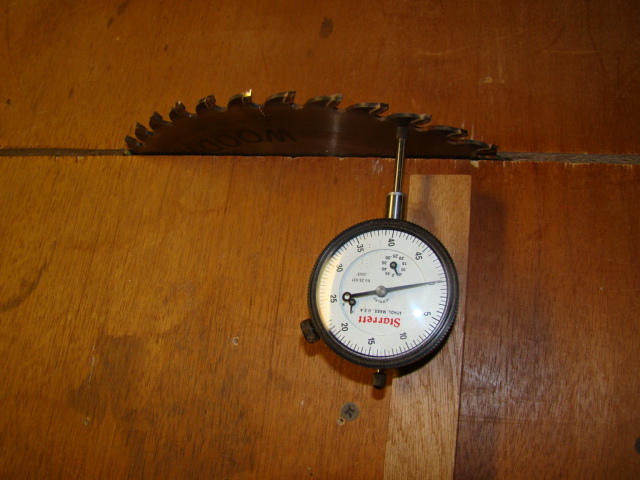

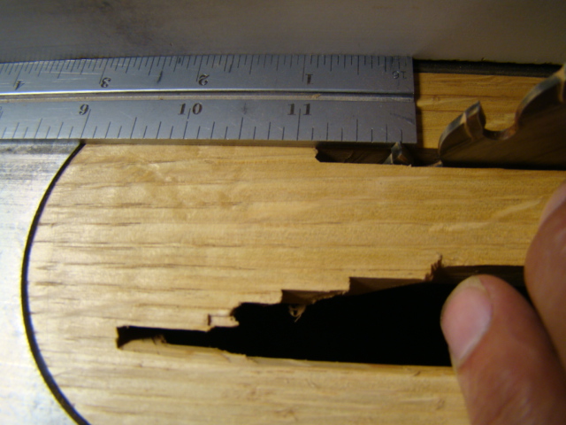

Cal,
Set your saw for a square 90 degree cut in a thick piece, say 2" where the blade clears by less than 1/4" Then clamp the board to the miter gauge and do the cut, lower the blade to half thickness and repeat the cut. Does it follow perfectly or do you get a slightly deeper cut or does it even miss?
That is an important test for any saw that has seen use.
ES
I stand by the fact I get a better result with a thick blade....but my experience is with reasonably stout table saws...and I'm REALLY picky.

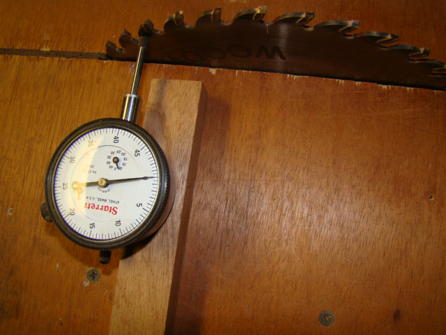

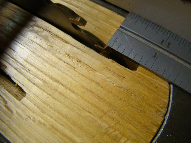

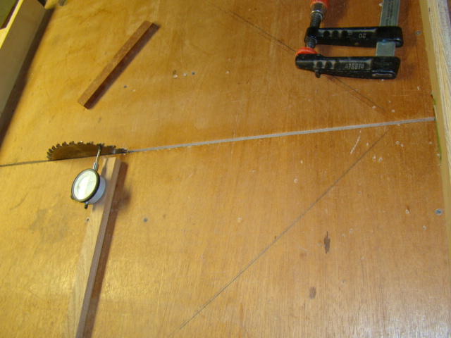

Regardless of the quality of the blade the saw must be set up properly to work well. The slots in the table need to be parallel to the blade as does the fence. If you cut 45s then you need to check that this condition exists not only when the blade is standing up, but also when it's tilted. For me this means measuring - shimming - measuring until I get it just right.
some shots of setting up the saw.

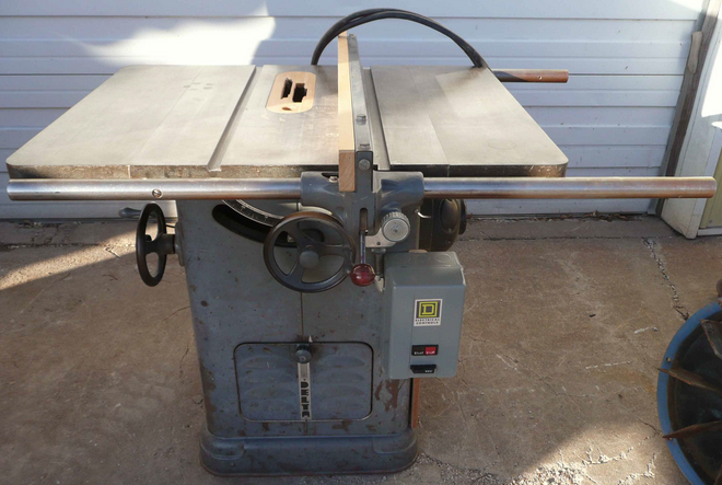

First thanks everybody, a lot of good information.
This thing could be an anchor on Steve Ballmer's yacht. 100 lbs+. I don't think I could lift it myself, maybe lift it off the table and put it back down quickly. The motor is the size of a pony keg.
As far as I know it's limited to an 8" blade. It's a small saw. The top is about 18" x 24". I can't detect any movement in the arbor. I'm going to give it a shade tree alignment today.
The only model # is cast into the side NCS 20. The serial# dated it to 1943 and it is labeled as Delta/Rockwell Homecraft.
It looks like this (but the saw only)
http://www.old-woodworking-tools.net/homecraft-rockwelldelta-table-sawjointer-combination.html

It's been quite the adventure but I have the blade square to the table and the table square to the miter slots in reference to the blade. Whew. It really helped when I found the 'extra' trunnion bolts that you can only see with the table tilted. And when I woke up this morning I didn't even know such a thing as trunnions even existed let alone that they get bolted to something.

Looks like you have a tilting table style tool, which nobody makes anymore but it is still military-spec in its design and construction. Fortunately you can do most of the ordinary processes with it. The machine itself is beyond well built.
