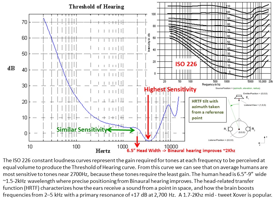

--Hearing research explains why a T-M crossover around 1,700-2,00Hz is a good choice.
