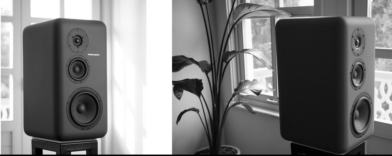

Live and Learn..... I would build 2x thick front baffle and add 1" - 1.5" radius quarter rounds on all front baffle edges. Example: The Telegrapher speaker cabinet.

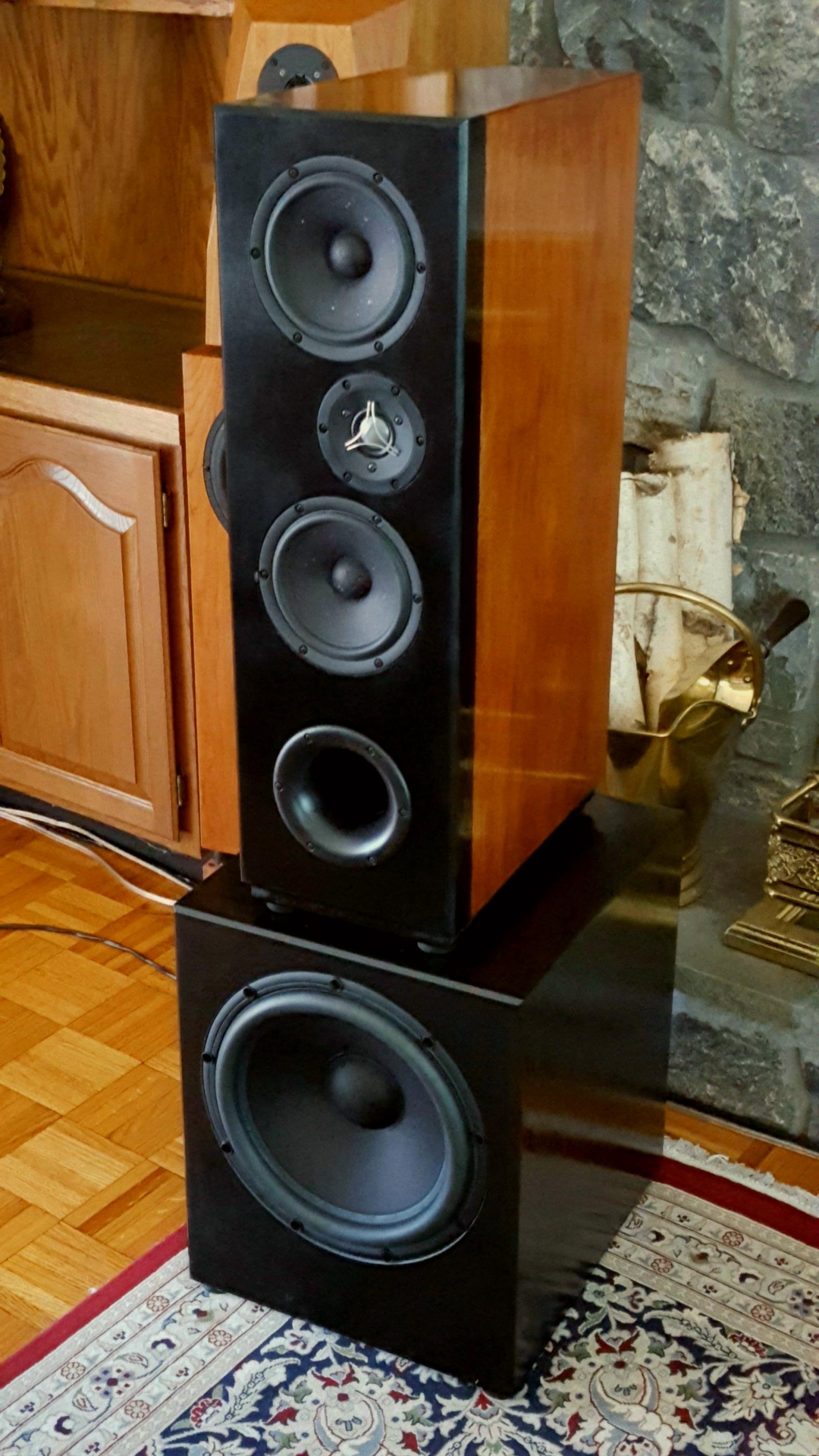

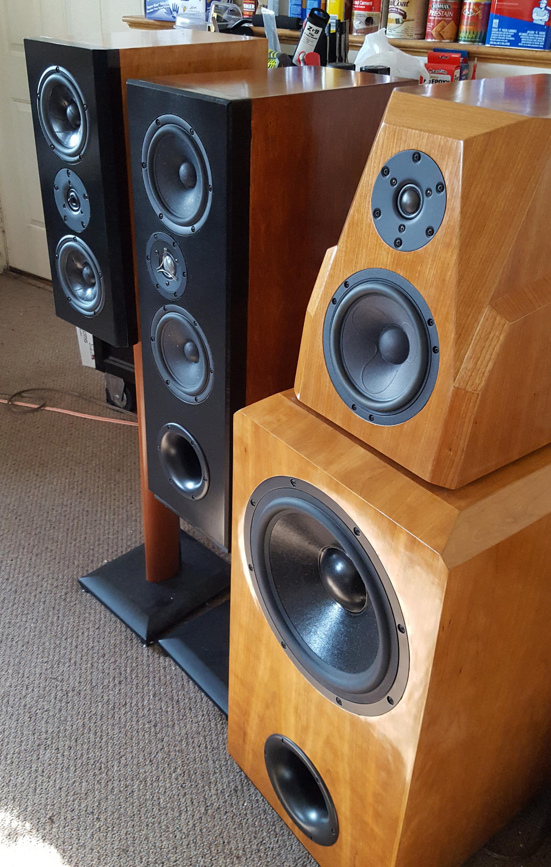

I’ve built the SBA MTM. The level of transparency and clarity is stellar from the MW16P and T29BN Be tweeter. The Jantzen Alumen caps also do their magic. Troels most likely voiced this speaker for tube audio as solid state can sound a bit clinical. So, you’ll have to experiment with the tweeter values. The bass is lean, so I’ve paired it with stereo Scan-Speak 32W subs. You may have to place them near a wall to get max bass effect.
