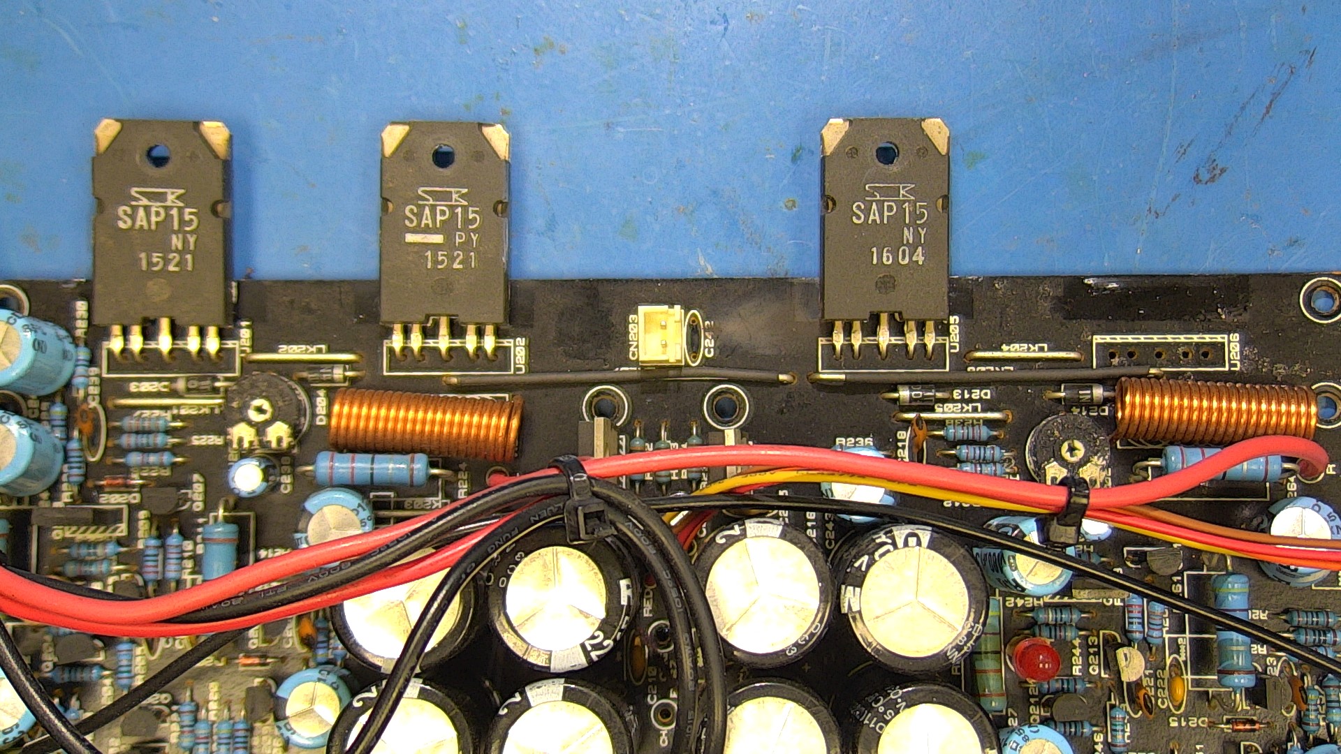

My P's SAP15's have died in my A5 amp the N's seem ok, does anyone know a reliable source for these or is fleBay going to be filled with fakes?

Thanks bud but unfortunately they are the wrong channel I need PY's not NY's

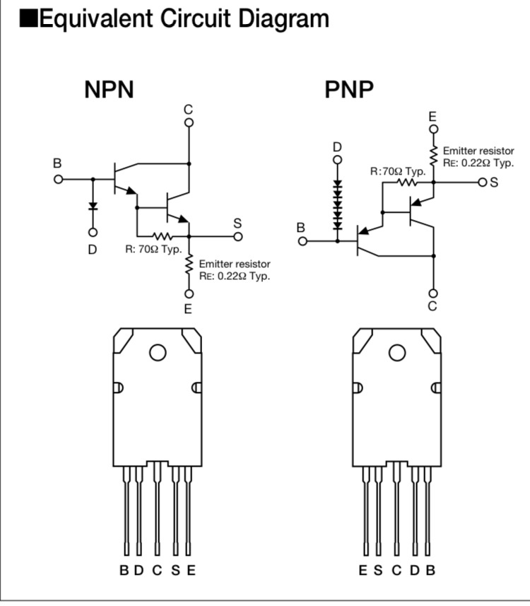

No external diode is as well and rapidly coupled to die temperature as the built in one
Sorry could you explain more?
........Re: emitter resistor (mostly 0,1.........1 ohms) is inside the case of the sap transistors (see data sheet), that is uncommon.
and the thermal tracking diodes are also inside the case - should give the fastest reaction if temperature changes........
Ah I see thank you!
Yes. In the original transistors, the build-in Re used to break too easily on overload, way before transistor itself would break. So they came out with the STD series that is internally identical to the originals, including the clever sense diode arrangements, but without the Re.
So you can replace the originals with the STD but you would need to add the Re resistors externally between two of the pins. It will all be clear when you compare the internal circuitry from the data sheet.

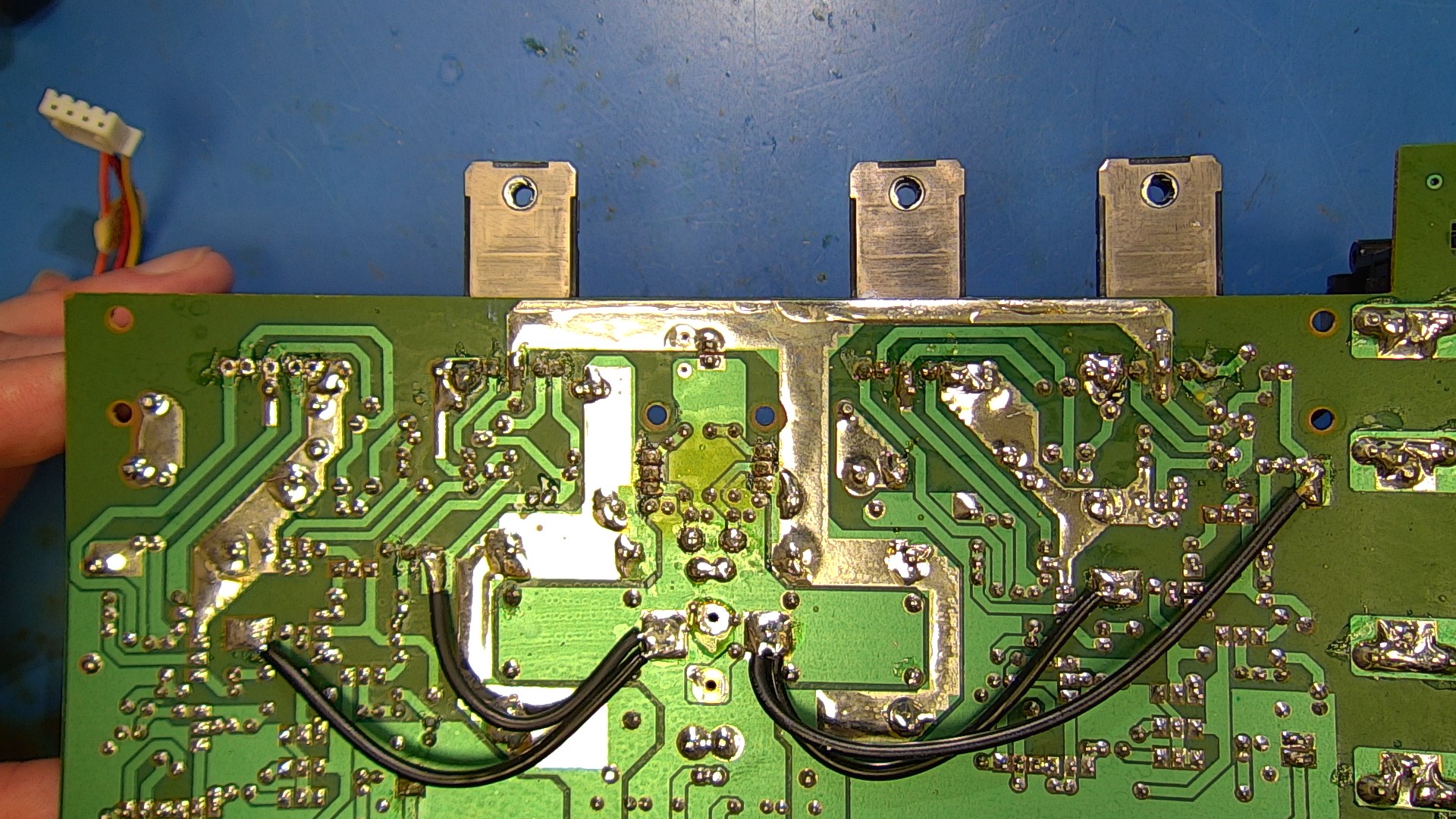

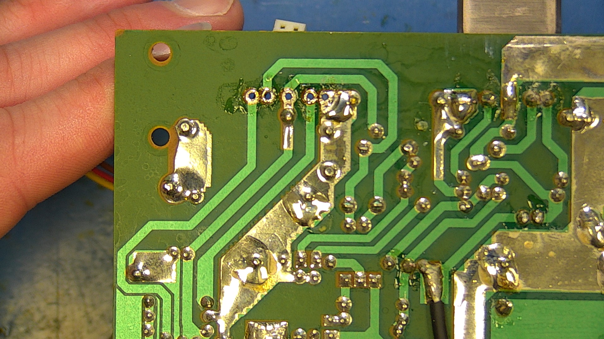

Adding external resistors is *relatively* easy, we need some closeup pictures to see what space you have available.
At least one from component side, one from copper/tracks side, you will need to cut one track and scratch soldermask (the typically green "paint" covering copper) to solder a couple wires to the added resistor.

The re-work will be no issue I am an NPI Tech for a PSU company so everyday I'm putting components and laying tracks where they don't belong!
I will get some pics of the board up asap

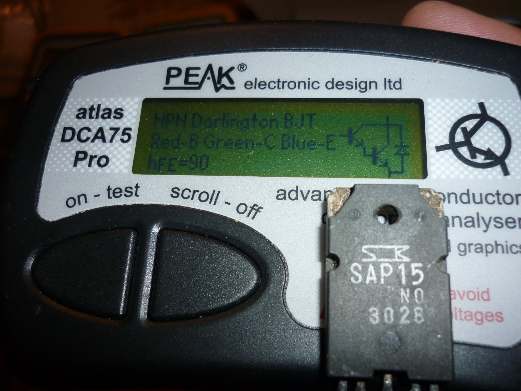

Mine are 15-20 years old. That should answer your question.
Otherwise I can check in a few hours.
