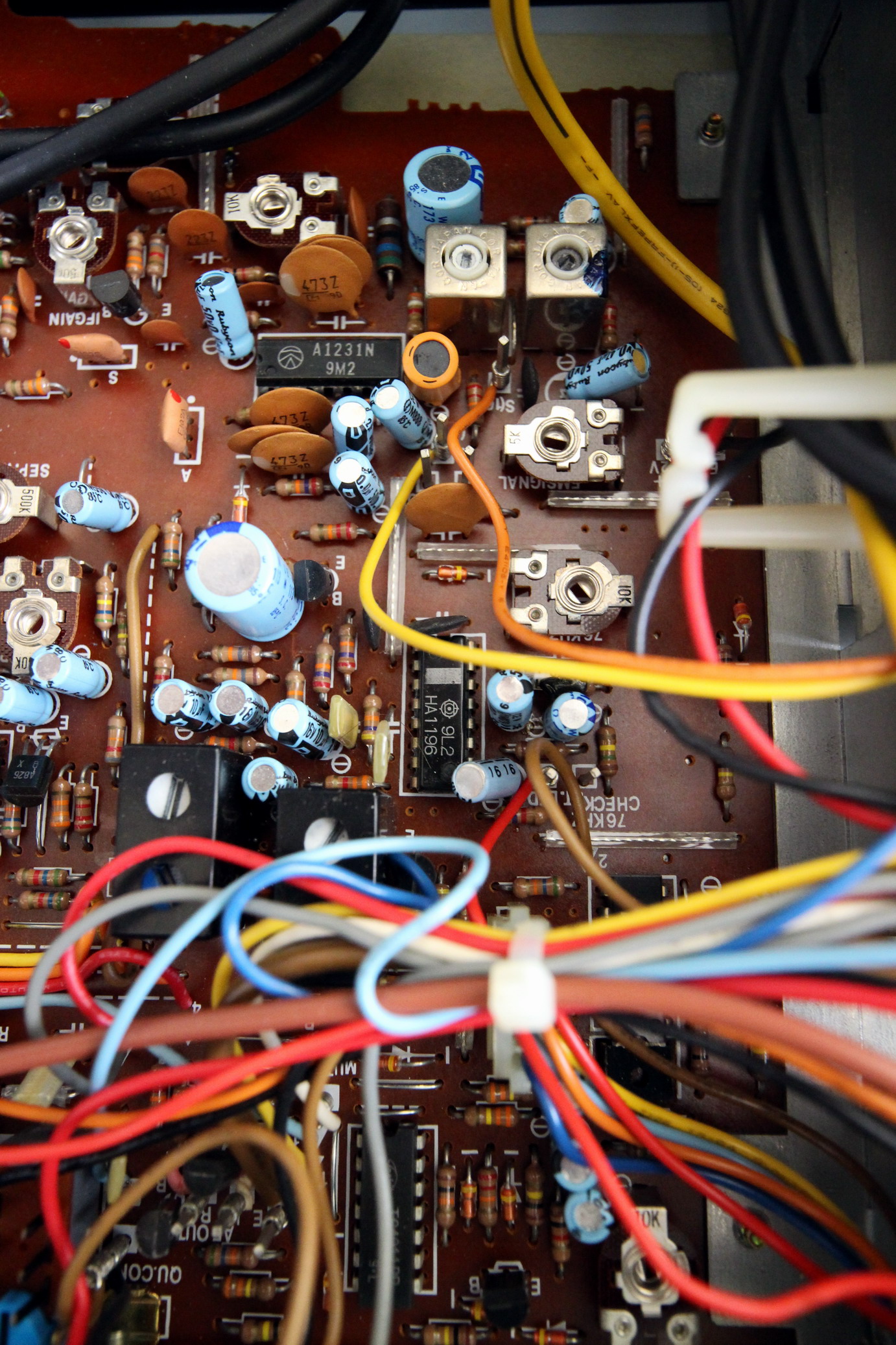

hi Mooly, thanks for reply, yes, that's the way its going to be, most likely. But it is going to be quite easy. Looking inside, these are the chips I see: A1231N (if section), HA1196 (stereo demodulator), LB1416 (signal level meter), TC4011BP, LA1240, and output dual opa rc4558.
Last chips are likely AM section, which I do not care about...
The reason I think the adjustement is going to be easy, because each pot is labeled what it is for!
Right next to A1231N I see 3 ceramic filters, two big poted coils for demodulation, and most importantly IF gain pot, Mute 1 pot, Mute 2 pot, and FM signal pot.
Right next to HA1196 I see 76kHz adjust, and two pots sep. wide and sep. narrow...

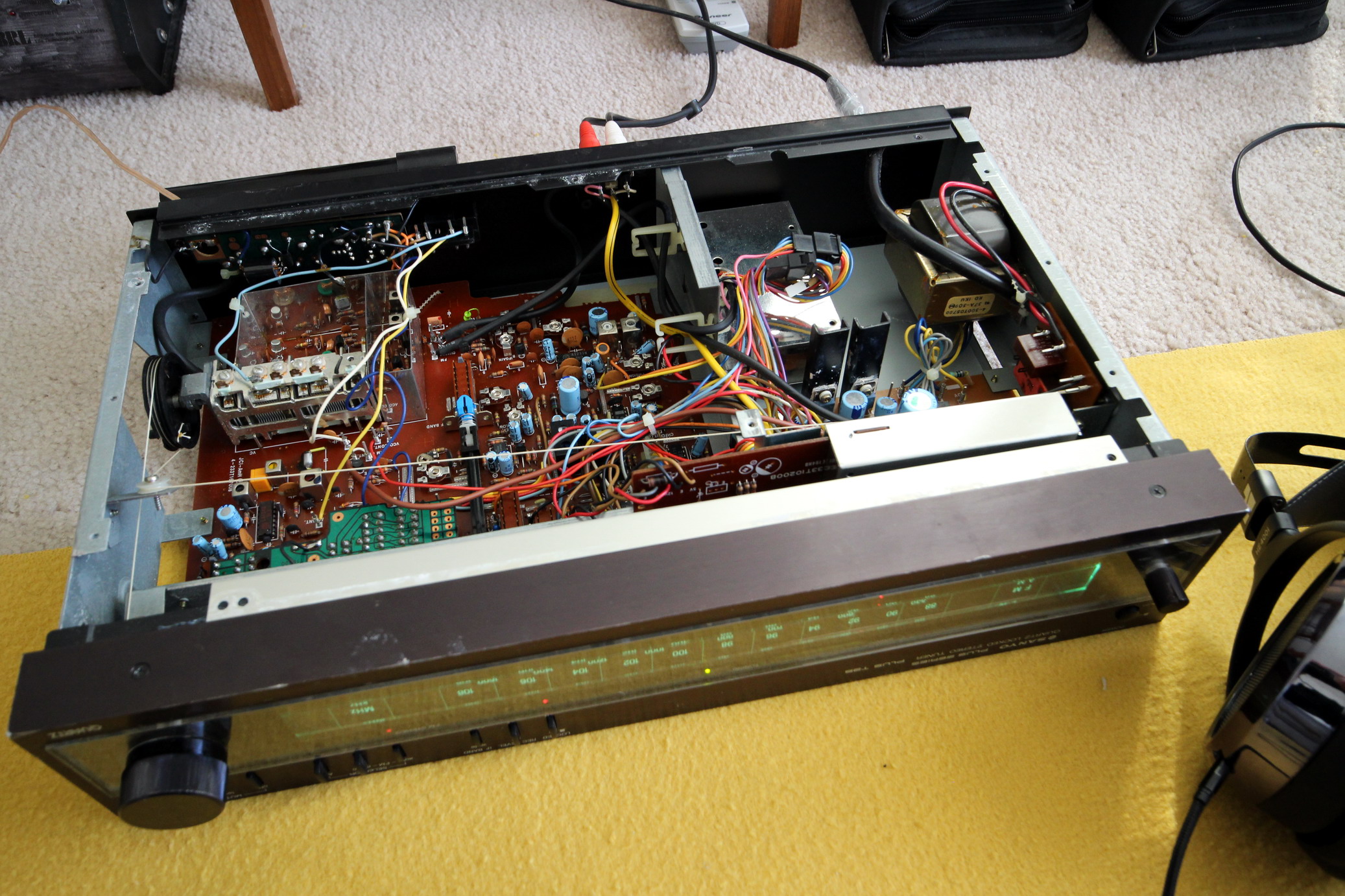

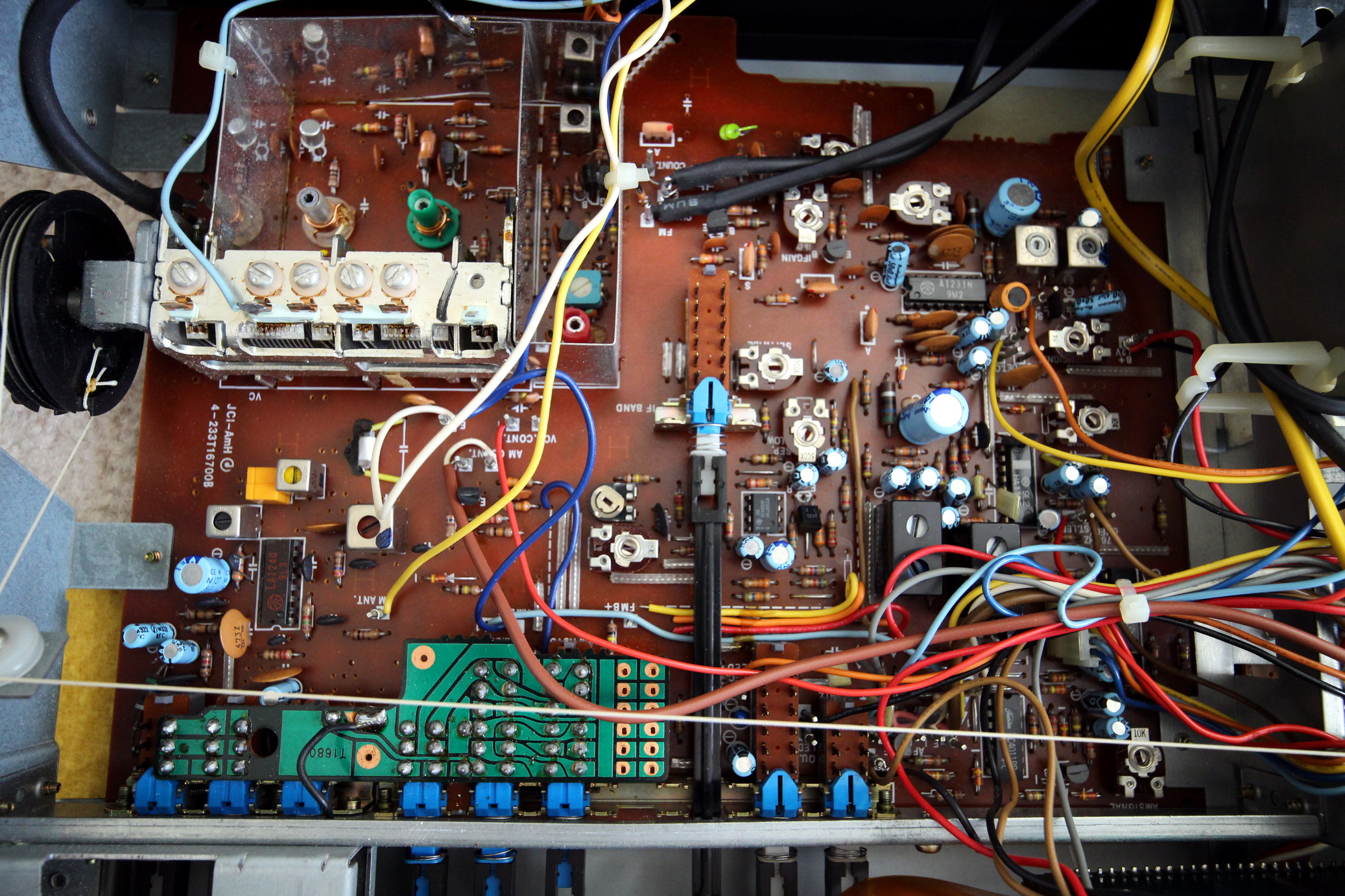

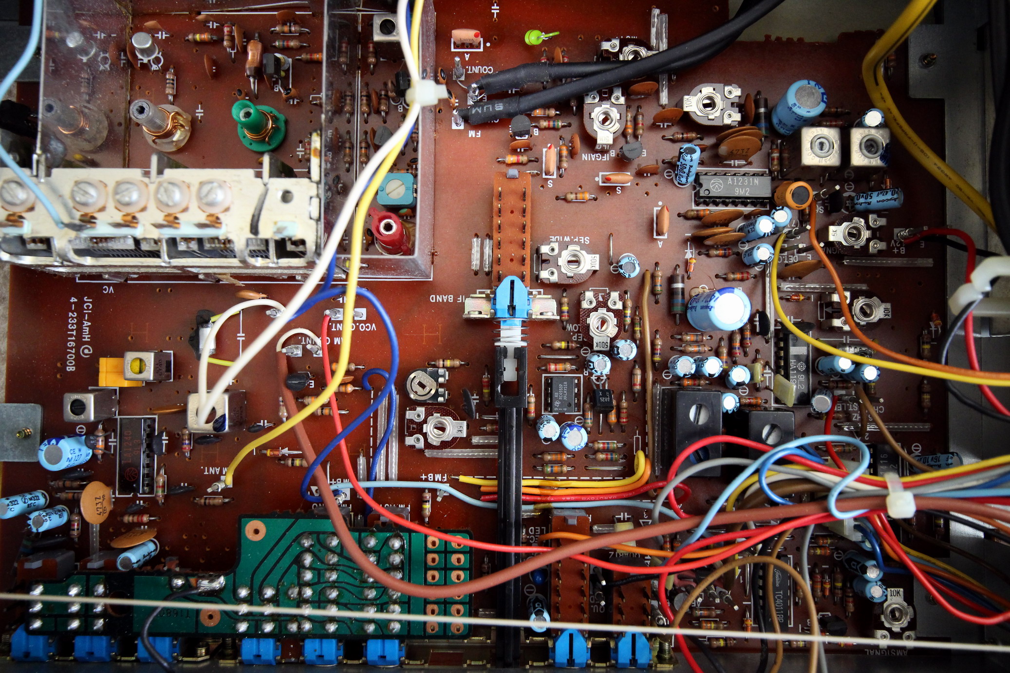

here are some guts!

Hi Ed,
You have a three section tuning cap for FM, one is for the local oscillator. That brings the total number of sections to four.
To me, that doesn't look like a bad tuner at all. Does it have a narrow - wide filter setting? You may actually have a 4 section IF filter set there. Each filter has a number on it that tells you what the width of the pass band. You can cross reference the number to the value. Common filters are 250 KHz, 280 KHz and 330 KHz.
-Chris
A surprising number of presets for a tuner like that. Maybe all those little 'screw things' need tightening up 😉
Its important that all the ceramic filters have the same 'colour spot' if you replace them (same as in all matching such as red spot, white spot etc) as that specifies the centre frequency. Doesn't matter what colour you fit but they they must all match.
Come to think of it, I don't think I've ever had need to replace one. And change that 4558 🙂 they are horrible.
