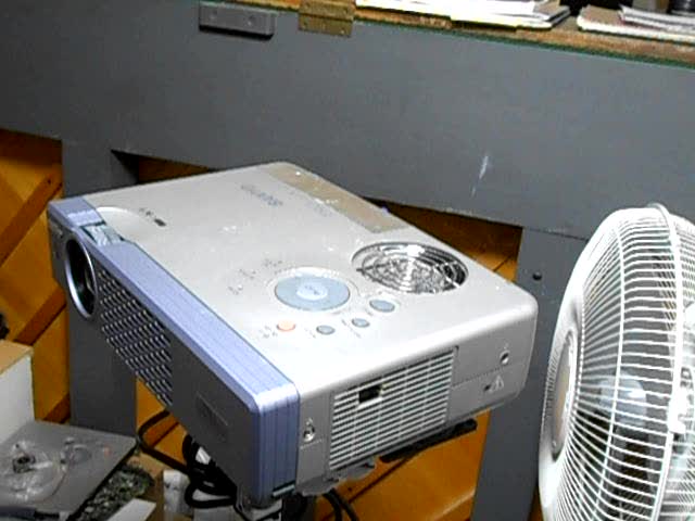

I got myself 3 Sanyo plc-xu41 projectors of ebay as a batch for £30 including postage. One was completely dead, the other two were working fine, but very dirty. I deep cleaned them thoroughly before proceeding.
I wanted to replace the expensive lamp and use an LED module instead. I only did it for fun and the challenge…….and to watch movies, anime and what else without sitting in front of my computer when I have a comfy sofa to sit on.

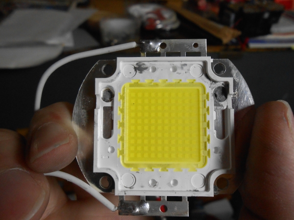

I looked for the highest and manageable LED out there, and I found a 300W LED cob chip from E-bay. It ran of 36V at 8Amps.

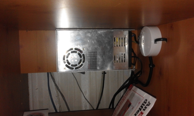

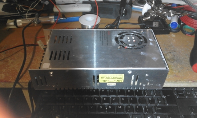

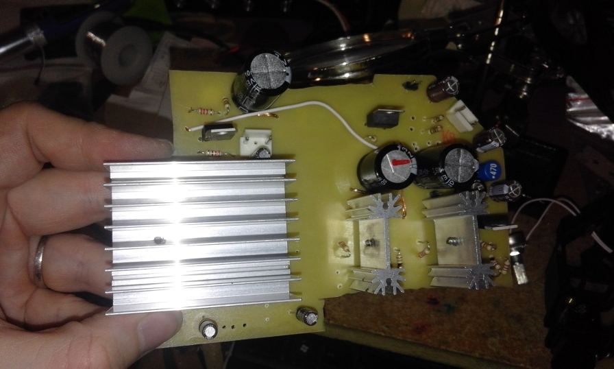

One big issue was the power. The original power supply in the projector would never power the 300W LED chip, even with a boost converter. I had to order a 350W power transformer and then rewire the projectors own power supply to run of this new power source and scrap the old one.
I did not want to have two power connectors to the projector. I decided to attach the power supply under my desk and run the power cord to the projector with the HDMI cable and sound. It is much more safer then connecting the projector to the mains and it would run the projector and LED at the same time.

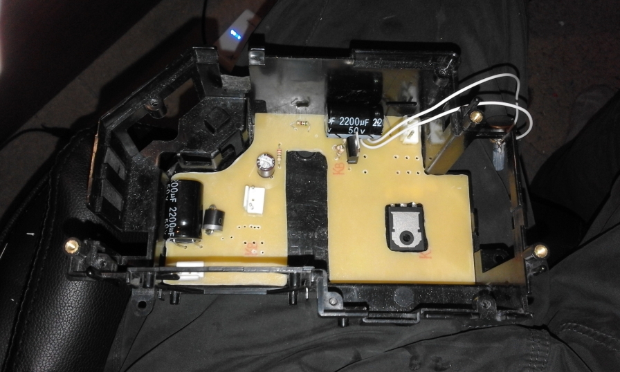

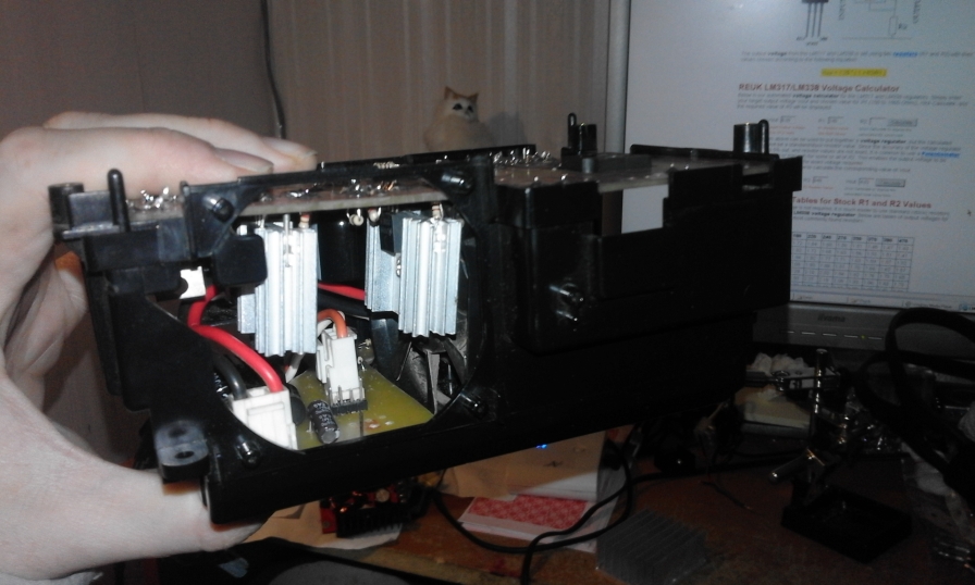

I had to check all the power rails for the projector and create a voltage circuit that would give me 6V –6V and 15V for the projector. I also created a dimmer switch for the LED and a temperature controlled fan speed controller to control the speed of the fan depending on how hot the heat sink got.

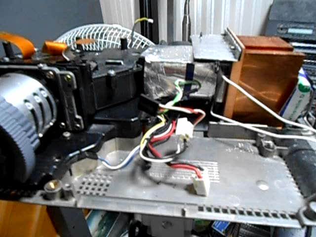

I then trimmed the light tunnel down to size, removed unnecessary light filters and lenses, replaced the BLUE LED lens with a clear one, as that had a UV filter on it. I noticed the blue UV filter blocked some of the blue light and since the LED did not let of any UV light, it was not needed. I also removed the wire mesh plate as this did cut the LED power by half.

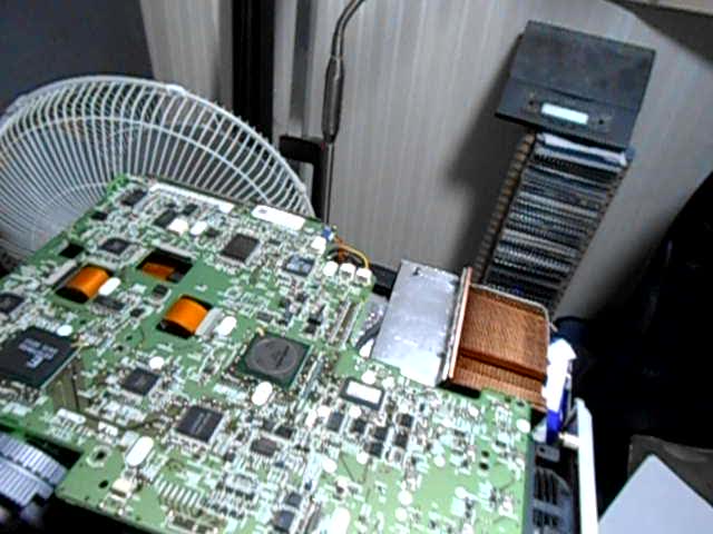

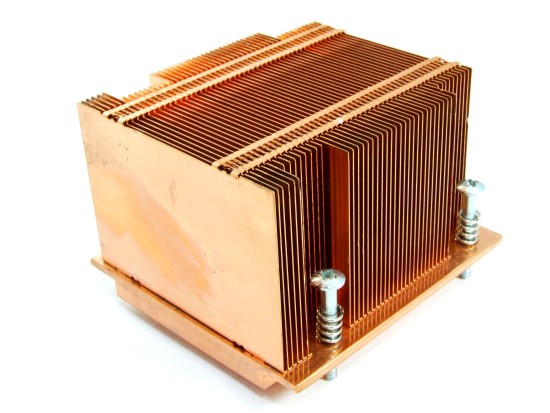

I then attached the LED to a copper Dell passive heat sink and stuck a 5000RPM fan to the underside of it. But the fan controller only runs the fan at low speed as the temperature sensor monitors how hot the heat sink gets. Surprisingly the Dell heat sink works like a charm and keeps the whole thing cool.
I created a bracket to mount the LED to the case and then isolated the light tunnel with a ….. food box and self adhesive foil tape.
I have had lots of problems before I got to this stage, I used a 100W led, but they only lasted for a month before the LED elements would fail and the LED would flicker. I will cover this and its cause in the video. I also had power problems. Blew up a 300W flip chip that cost me £100 and burned another £20 300W led… Not to mention nearly fry the projectors main board and cutting the case too much… All fun in learning.
But the picture brightness is very good… and the projector can be used happily to see films and documents. I am testing at the moment to see if the LED will last past the one or two month before the chip itself dies. It was a heat issue before and with this new heat sink and LED cooling techniques combined together I might have solved this and the LED should outlive the projector itself.
"I then attached the LED to a copper Dell passive heat sink and stuck a 5000RPM fan to the underside of it. But the fan controller only runs the fan at low speed as the temperature sensor monitors how hot the heat sink gets. Surprisingly the Dell heat sink works like a charm and keeps the whole thing cool."
300W, even 100W is a very high power for LEDs. and it produce much more heat comparing to MCUs.
Ever check the temperature right at the LED case and at the sensor point, and see the difference ?
That was one of the biggest problems I had to contend with... 100W LED in my earlier mod got too hot and damaged the LED. I then moved to 300W LED and tried and tested all kinds of heat sinks, even made my own copper heat sink and that failed. But for some reason, this Dell heat sink keeps the temperature no higher than 40c with the fan cooling it from underneath. The LED datasheert says the LED operates just fine from 45c - 60c. The copper fins on the heat sink are very thin and there are lots of them at nearly 57mm length. The LED die does get extreamly hot, but I am using the projector fan to cool it directly. So far all is good, but I am still testing and keeping a close eye on things..
The copper heat sink is dissipating a lot of heat quickly into the air, I have cut a hole in the top of the projector and plan to cut a metal grill once I find my cutters. This allows the heat to enter the bottom, pass through the heat sink and out the top quickly.
Here is an image of the heat sink: Passive Full Copper Heatsink Copper Cooler Socket 754 939 940 84 mm x 80mm x 57mm

"this Dell heat sink keeps the temperature no higher than 40c with the fan cooling it from underneath. "
The temperature of the cooler or LED base?
If it is the cooler temperature, it is still good assuming thermal resistance between heatsink and LED is not too bad.
if you look at the second image on my first post i can easily touch the led base fins and the heat sink easily and its not very hot.. i cant touch the die though, thats to hot and the light beam and lens...
