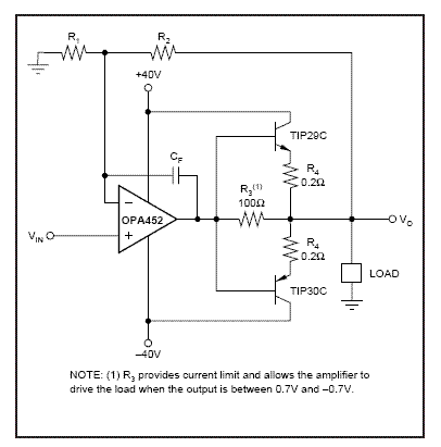

Also ,What if I do like to put current booster trannies at the output like the attached schematics, will it provide more distortion?

I can't say how well the circuit with output driver transistors would work for audio, but again if you want 15 volt rails, go with the above mentioned chips.
One comment - kind of slow op amps - slew rate of .15 uV/sec - probably high distortion for high frequencies and may add problems if used as a driver. Looks like good for low powered projects and experiments, but not worth putting with expensive parts or extensive modification. Just my 2 cents.
^ agreed, these will sound terrible and along with the idea for more output power, it's much, MUCH better to pick a different chipamp chip.
