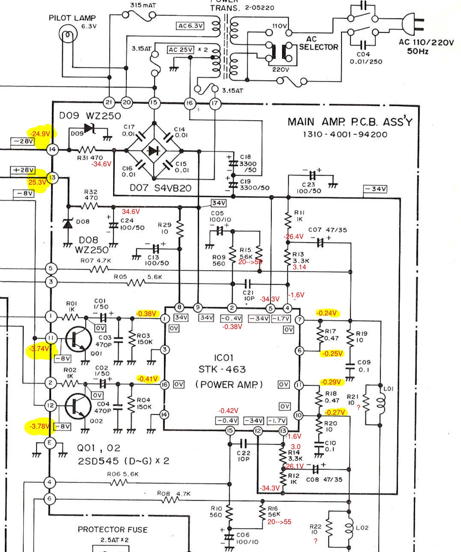

So I measured he DC Voltage on the speaker terminals at zero volume no speakers attached and got following result:
left channel: -240mV
right channel: -277mV
If I understand correctly this amp is working in class A so a higher bias is expected but does this look reasonable to you? and what about that 37mV difference?
I can't find any pots on the boards nor in the circuit to adjust bias.
attached the schematic. I can't find the service manual on the internet.
Any thoughts will be welcome.

hi
This Sanyo amp is a cheap amp made in Portugal at the time! This is not a class A amplifier, class A is not suitable for this kind of power integrated circuit because in class A the heat release is very important! On these integrated circuits there is no bias adjustment and the voltage difference on the outputs terminals without signal is normal and within the tolerances of 300mV! Finally, there is no time delay for turning on the loudspeakers, so it is completely normal to see the membrane move when the power is turned on (the famous pop at the output when the power is turned on)! You can equip it with a protection circuit found on aliexpress.

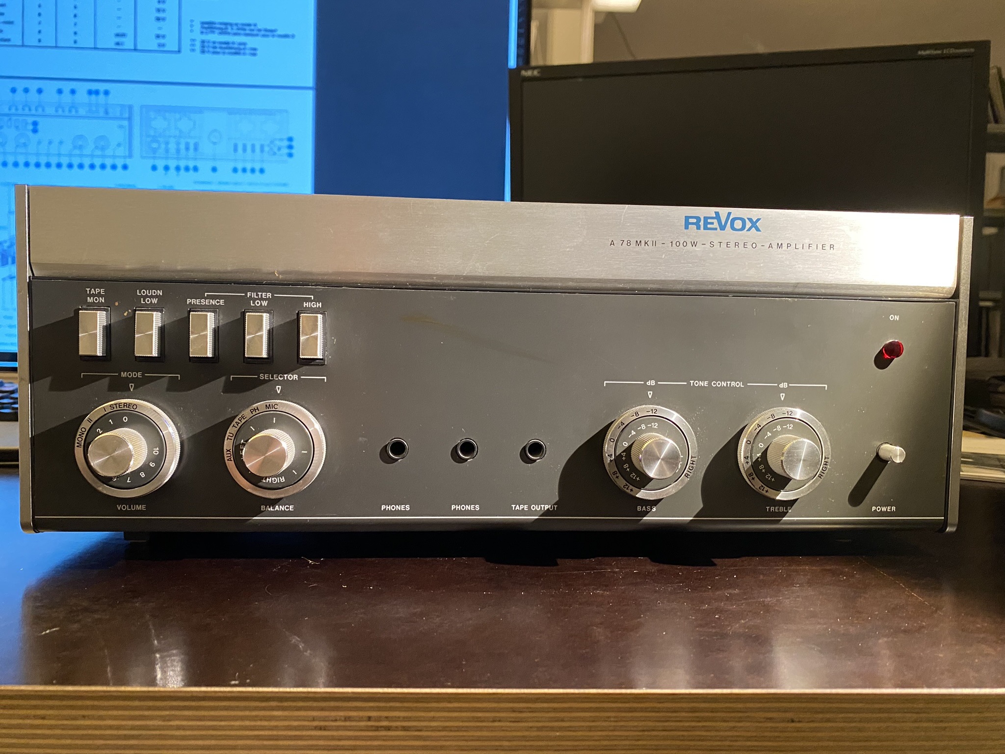

I had a feeling this can't the best class of equipment but liked the look of it somehow. Anyway I found a very good deal of a Revox A78 MKII and started to put my time in that one, leaving the Sanyo as it is for the moment. The protection circuit is a good input, I'll probably go with this option another time.
The build quality of my new Revox is astonishing, making it much more fun to work on. There is also much more documentation about it here in Europe.

Hi Mongis
thanks a lot for the suggestions!
I replaced all the trim pots and electrolytic caps as advised by people doing revision work on that particular model because on one channel I couldn't get the bias in the right range. Waiting for the 4 big filter caps also.
This protection circuit, where exactly will it be placed in the original circuit? I'll order 2 or 3 right now.
Tnx again.
EDIT: never mind, I just realized it's well documented on that product page..
Tnx again.

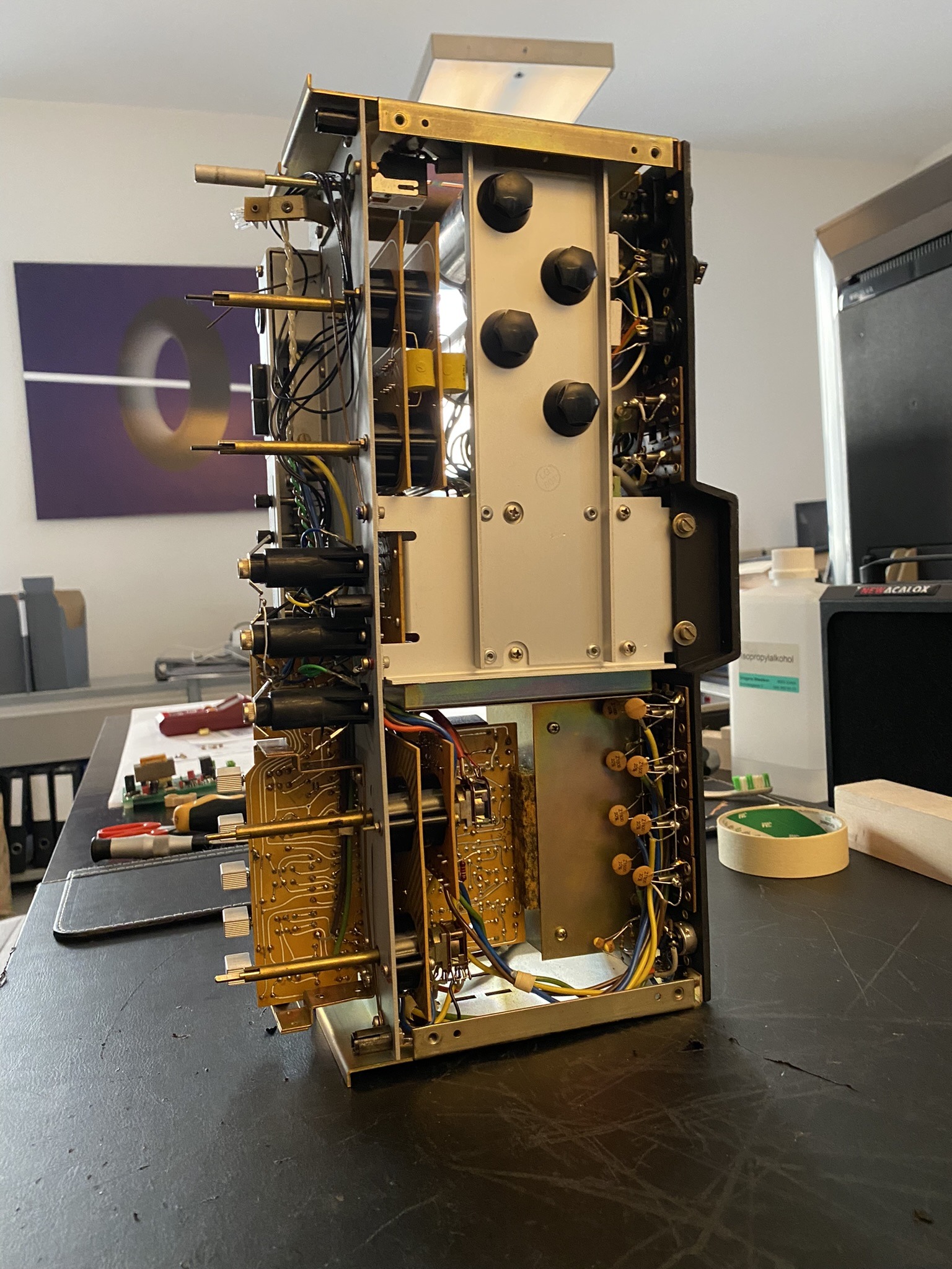

BTW: Even after recapping all electrolytic caps I couldn't get the bias right in one channel. I first suspected Q503 after measuring in circuit, desoldered it, but it was good then. It turned out the collector pins of Q503 and Q504 were shorted together over the shared heatsink! The heat transfer plastic somehow was not in a good shape. Or maybe the mounting screws were touching the heat transfer plate of the transistor from the side. Anyway, I found some new pads from other transistors, adjusted bias and bias offset, hooked up the beovision speakers for the first time and everything is working fine now. The Revox now sounds pretty good in my ears.
