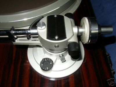

The VTA is adjusted by raising and lowering the rear of the tonearm. This is achieved by turning a small knurled screw on the right hand side of the tonearm base to unlock it, and then pulling up or pushing down on the tonearm at the pivot point. The knurled screw is just to the rear of the black knob for setting anti-skating (see the attached picture). Clamp the tonearm to its rest before you start. Turn the knurled screw anti-clockwise to unlock the height setting adjustment. After setting the height of the tonearm, turn the knurled screw clockwise to lock the setting. The idea is to make the tonearm roughly parallel to the surface of the record. After that, it can only really be set by ear, apparently. However, it's really only a happy compromise, because records vary slightly in thickness.

Thank you very much for the instructions and picture...I saw the small set-screw on my arm base, but was hoping there was some type of fine vernier adjustment instead...My old Linn LP-12 had the same set-screw mechanism; very awkward and imprecise...
