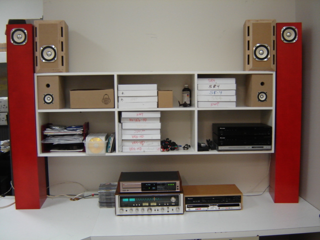

All this talk about Sansui, I dug my old 7070 Receiver out of a dusty wood shop and cleaned it up. I bought it new in 76, and haven't used it in 20 years.
It works fine, better than I remember, it's nice with the full range speakers and the triple tone control.
Q. Will any of these lamps work on a 7070, there are a few out along the top.
