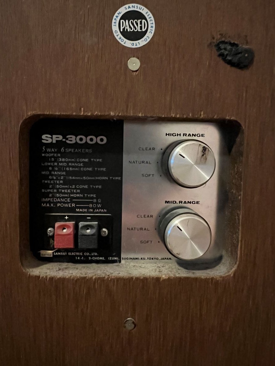

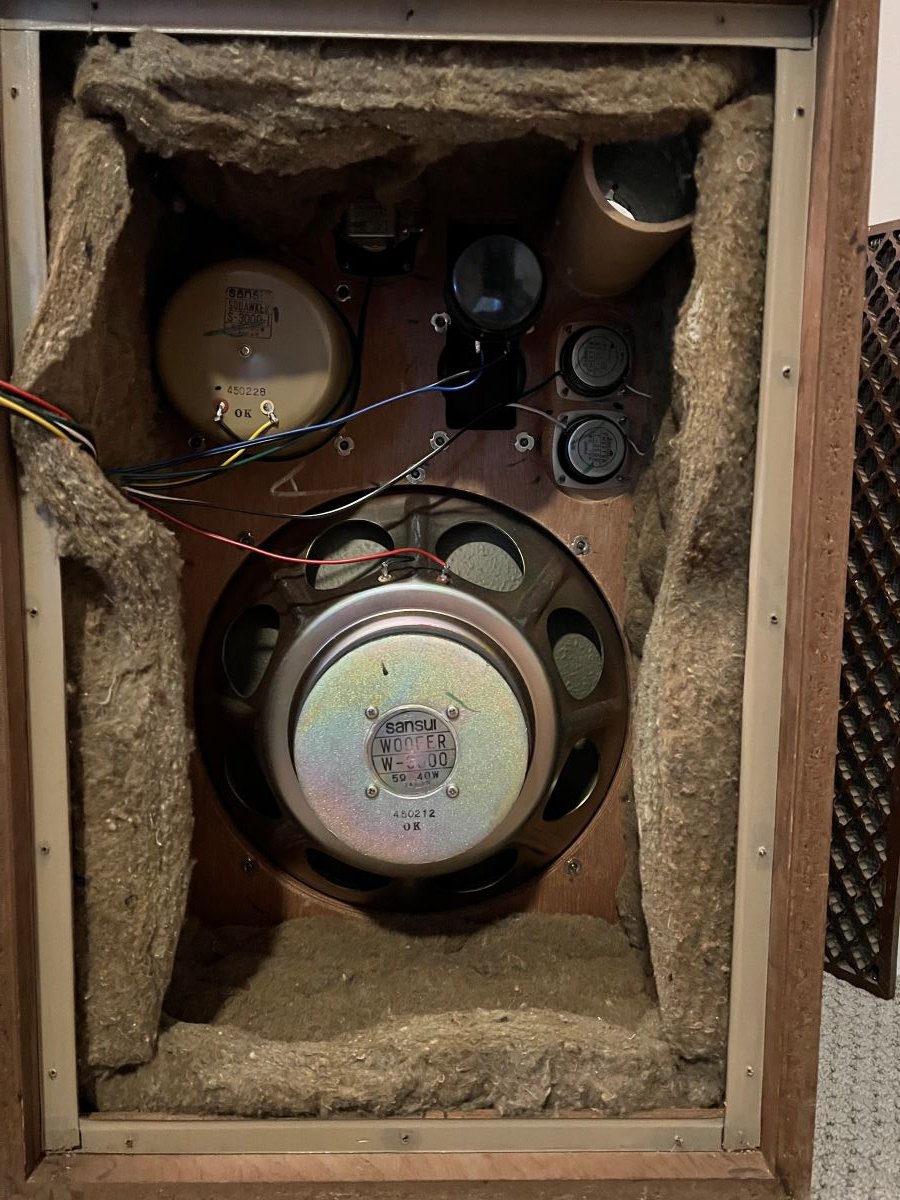

I'm looking for some guidance on assessing vintage crossover networks. My time on DIYAudio has been focused almost exclusively on Solid State Amplifiers. This is my first forray into the world of speakers and crossovers.

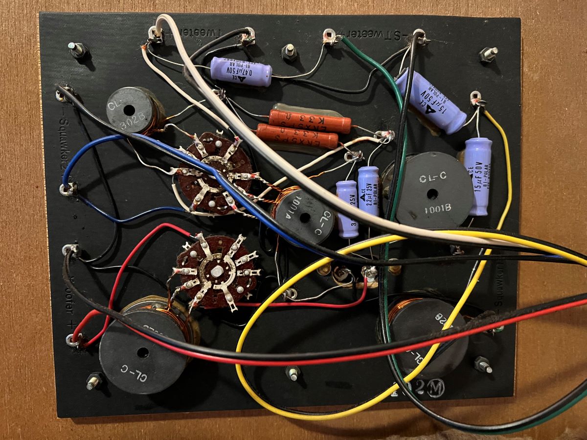

I've had them stored in the corner for the past few years and am finally getting around to putting them into use. I think they sound good, but maybe a bit hollow? These are likely from 1975 and are now 50 years old. The crossover network has four bi-polar electrolytic caps. Given their age, should I assume they are dried up and are due for replacement? Or should I pull and test with a LCR meter? If I do replace them, should I use bipolar electrolytics (like Nichicon UDB series) or consider replacing with film caps (like ClarityCap PX Series). I've read that swapping Electrolytics for Film caps can had unintended negative impact due to the lower ESR.
I also plan on replacing the funky cheap connectors with 5-way binding posts.

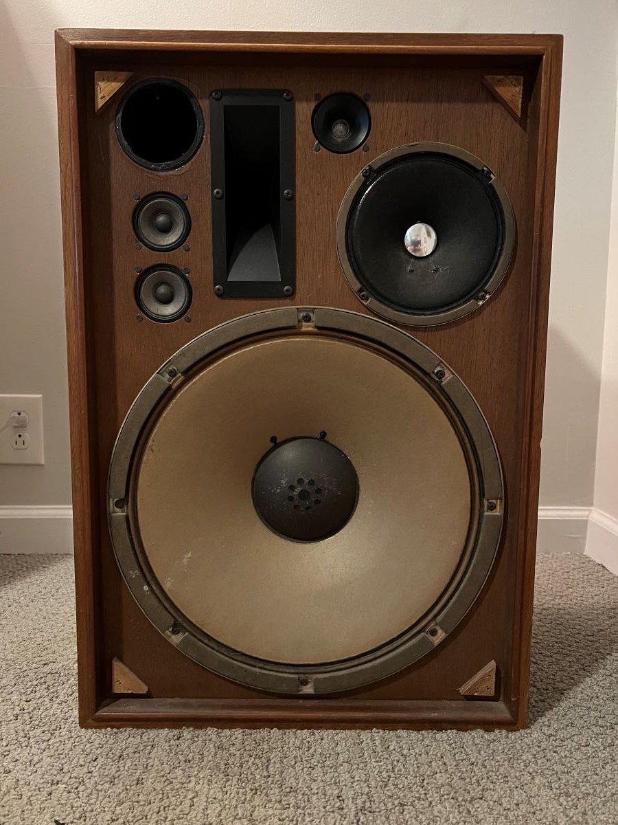

The cabinet and speakers themselves are in excellent condition. Cones have no visible damage and the surround is still intact and pliable.
3 of the four "tuning" knobs turn well. One is a bit sticky. I'll need to look at it to see if it can be smoothed out... unless someone has any advice on this

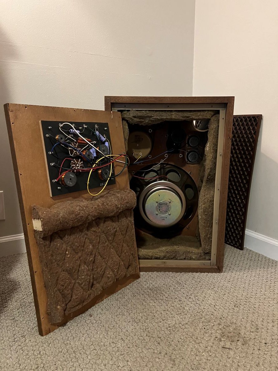

Anything else I should consider looking at? Any changes to the fill I should consider?

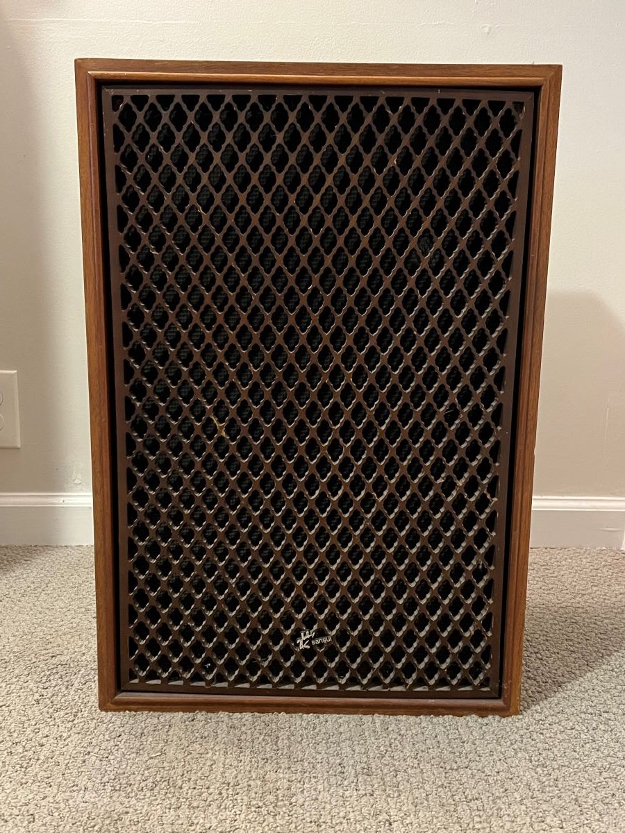

BTW - how crazy is it that those fragile wooden grills are still intact on both speakers with no visible damage.
https://www.audiosciencereview.com/...rade-in-crossover-is-it-audible-part-2.12447/
In the above link you can read about old (35 years) capacitors compared to new capacitors measured in crossover. It is in section 'C'.
It also has other capacitors measurements.
But as these are old parts one has to measure what they have personally to confirm 100%.

They're made of some kind of plasticBTW - how crazy is it that those fragile wooden grills are still intact on both speakers with no visible damage.
The woofer is '5Ω' like the one in the Kenwood KL777; the capacitors are the same brand. They were still holding strong ...10 years ago.
