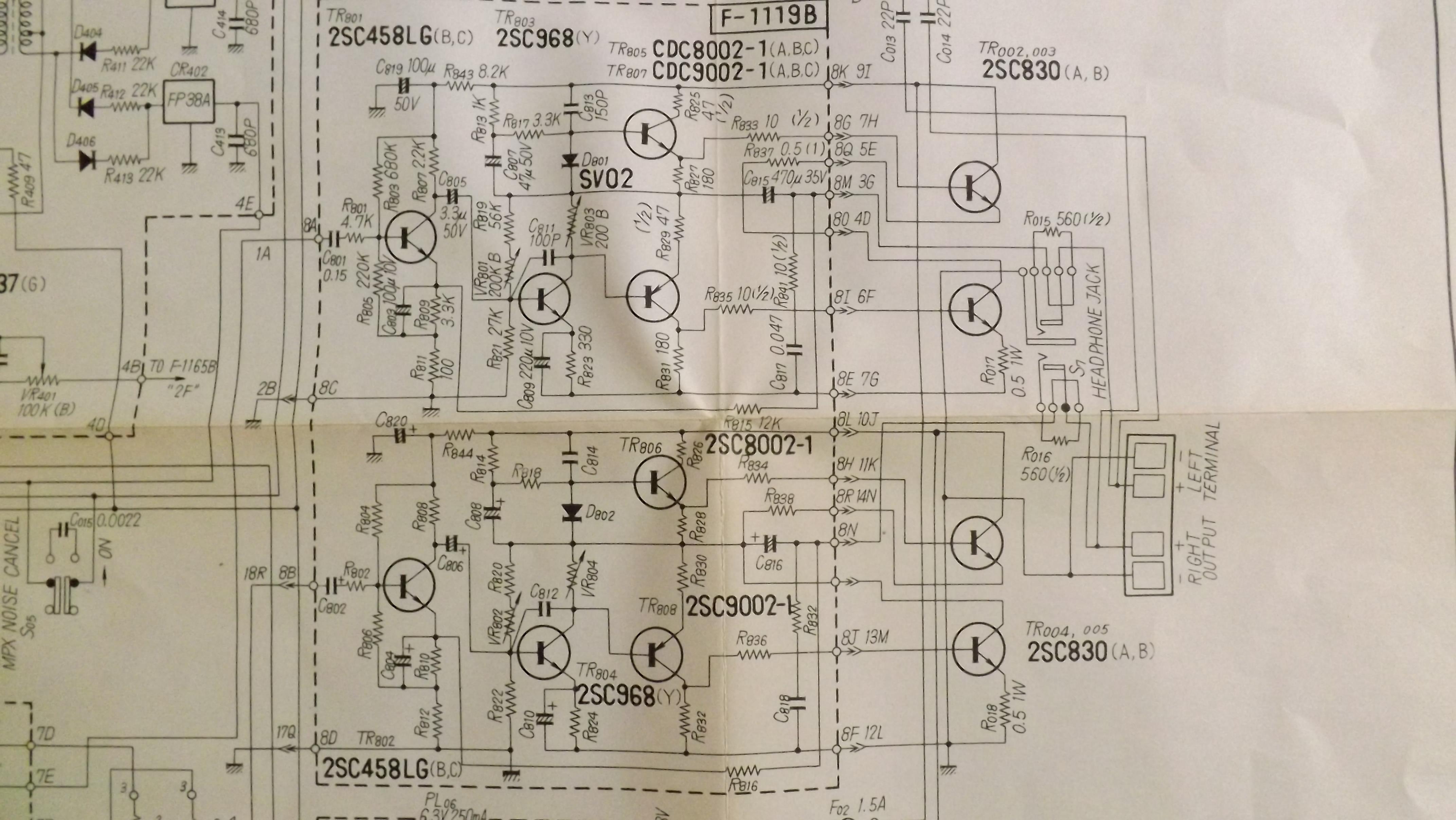

I have a Sansui 300 receiver from around 1970/71. It has been in storage (in original box) for around 20 years.
I have cleaned it all up and it all works lovely. A few bulbs are gone and the pots need a clean, the main problem I have is noise, like background FM radio hiss noise coming from one channel.
Turning the volume knob doesn't change it, its in all modes (radio, phono etc) mono and stereo.
Bass and treble however seem to have a slight effect on it.
Any ideas? Failing cap? I have the schematic and service manual but wouldn't know where to start.

Work backwards, (Output towards input), with your oscilloscope to find where the noise stops on the faulty channel. If you have no scope, use another small amplifier feeding headphones and with a decoupling capacitor of say 10nF, trace the noise back from the output.
Its got 37 transistors in total of varying types, if this is a noisy transistor would freeze spray help locate it under these circumstances?

Guys, from what I can gather the pinout are the same, can you verify this in case I am reading it wrongly?

That's assuming the 2SC458LG are the same as the ones in my amp, the service manual and schematic both state them to be 2SC458LG.

Perhaps you don't look at technical illustrations too often but surely you don't need others to confirm that the pin sequence shown on either of the 2 datasheets is the same. If in doubt due to a mental blockage or whatever, quickly redraw either from the other's viewpoint for yourself.
That's what I thought Ian, but I have been also told on other threads that they are reversed.

2SC458 (LG) is ECB as is KSC1845.

Quite confusingly, 2SC458s existed in both ECB and "classic" EBC pinout, same for their replacements. No problem as long as you've got their right ones, anyway. This particular type is quite notorious and should be replaced. And as mentioned, 45-year-old Japanese electrolytics are not to be trusted either.

The schematic doesn't list any BC109's , The transistors listed on the schematic are,

So I'm not sure why that was in there, is there a chance that anything else was changed to accommodate this transistor?

It wasnt originaly there but it will have the same operating point as the original, difference is that the BC109 is only 20V but at this location it is a lower VCE voltage, a better Proelectron replacement is the BC550 wich is the same device but with 45V VCE, or eventualy the 65V BC546.
Other than that those Sansui have a sound of theirs (i have the 800 wich is about the same design), not the best sound i would say but quite decent and reliable generaly despite the old school design.
You will never see a BC / BD type transistor in a Japanese amp, so this one has been butchered by someone. Get that junk out of there, it may even be the cause of your troubles.

They are in and its back up and running. Whoever replaced the transistor before had removed some of the pcb track so it was a bit tricky but it all fell into place quite quickly.
I noticed that before when I switched it off it would take 5 or more seconds for the sound to fade out, now its immediate, apart from a hum.
The hissing noise is gone but it revealed a low hum from the same channel that the hissing was on, the balance control has no effect on this humming.
