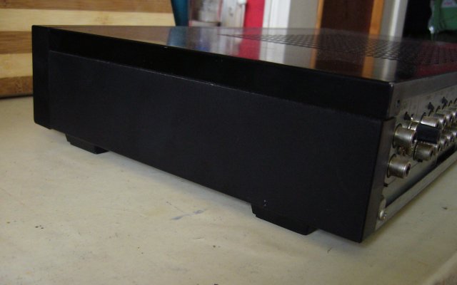

Sansui Au-G11X - problem with the case
My new – old AU-G11X needs to be repaired. I have a problem with the top plate. How to remove it? There are only two screws at rear panel (cover). The both sides aren't connected with the case. The top plate seems to be connected with plastic front panel in the central part. Can You help me?
fonon

In 'cases' like this, I take out every screw I can find, till the whole lot falls appart. No kidding.

Hi Fonon,
If it has wooden side panels, the other screws are under there. Some have a top panel that will slide back if you undo those two screws.

How many screws are still in place? It is perfectly possible that you need to remove the front.
Look everywhere, top, bottom, sides. I'm sure you must have missed a screw or two. 🙂

I have experience with audio units, but this case is simply strange. AU-G11X is a very rare amplifier. There is no information about the case in the service manual. Some parts are made of fragile plastic. I'm afraid to cause damage to something. I'm looking for a person (like Gandalph) who has this amplifier or other similar unit.
