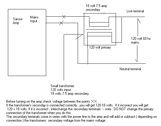

A possible solution.
You might be able to get a local transformer 18 volt secondary 7.5 amps or there about ( 7 to 10 amps !).
It will be a 180 to 200 VA transformer and quite small and inexpensive.
The secondary placed in series with the mains ( Line ) lead will add or subtract 18 volts from the mains supply.
here's a picture.
CAUTION : You are dealing with LETHAL voltages.
Turn off the power at the wall socket or remove the plugs at the wall socket before making any changes or connections. IF you make mistakes with the power ON it can KILL you . I am saying this not because you don't know all this but because ""we all tend to forget or take things easy sometimes"".
