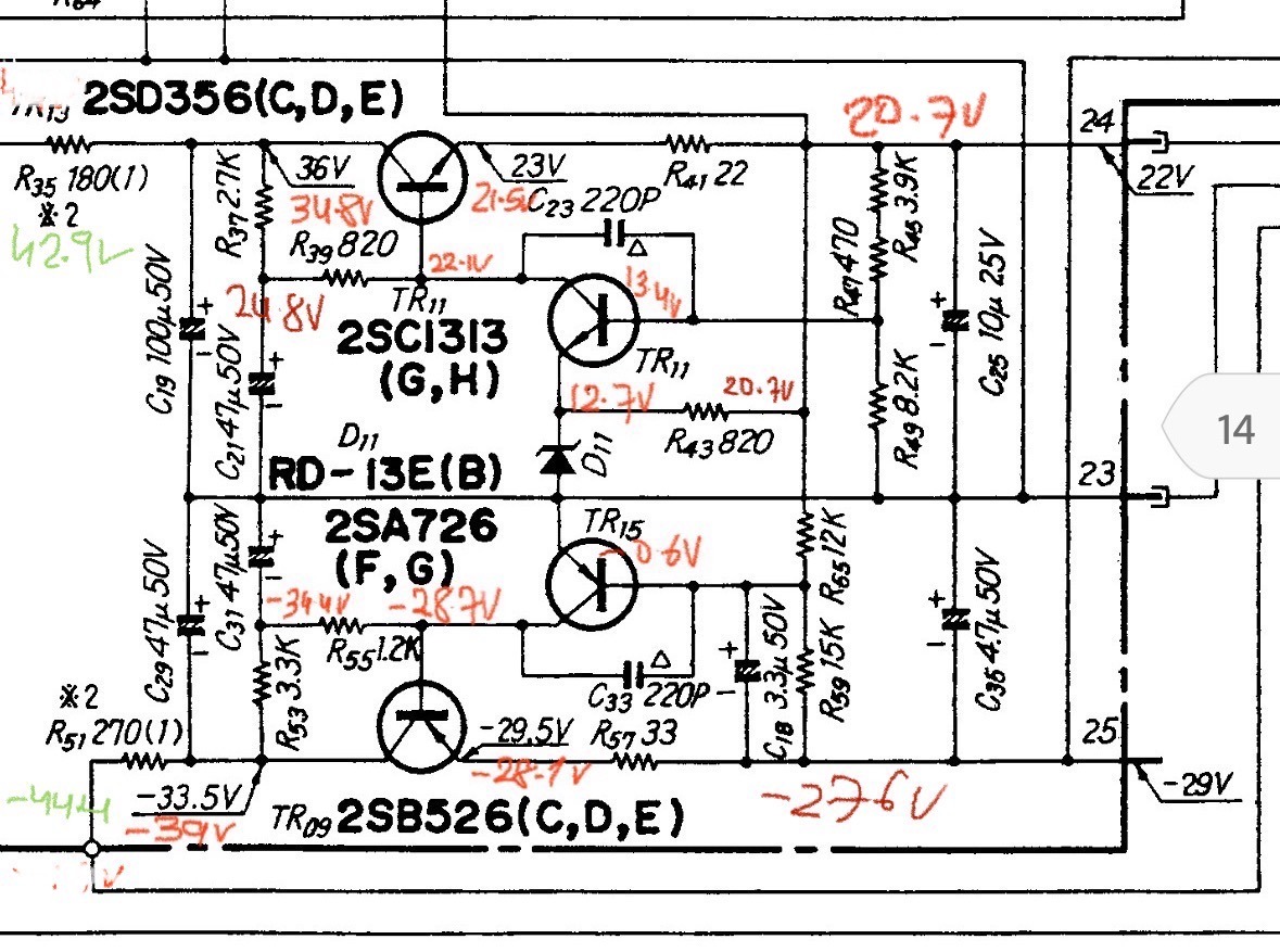

I restored recently my AU-5900 that is replacing electrolytic caps, replacing small signal transistors and diodes , fuse resistors etc. I’ve done it in the past on the same model for few friends with success.
On the power amp side, result was ok will all voltage levels good and bias set up right.
However during testing I noticed that the quality of sound had degraded and specially got a background HISS noise on the speakers even if the volume is at minimum.
I further investigated and confirmed the noise being from the preamp.
I also noticed the following:
1. On F2604, the collector voltage of both TR03 and 04 was 6.7V in lieu of 9.2V as written in the service Manual. All other voltages on the transistors seem ok. Note on preamp I used KSC1845FTA and Nichicon KZ , ELNA silmics
2. On F2599, the voltage readings are somewhat lower at the outputs: 20.7V and -27.6V in lieu of 22V and -29V.
Please see in attached photo complete voltage measurements on the preamp voltage regulator.
For components on this regulator :
- A726 and C1313 was replaced with KSA992 and KSC1845
- E Capacitors was replaced with Nichicon KZ and FW type
- Zener diode RD-13EB was replaced with 1N4743A
- B526 and D386 replaced with A940 and C2073
Could you please assist as I am really stuck with this since over a week.
I do not understand as I have checked again everything
Thanks and regards
AL
Sorry for not getting back to you in time, I had e-mail notifications on my DMs turned off.
These are the perils of shotgun replacement. Sometimes the semiconductor parameters just aren't as close as one would like.
I would put the original RD-13EB zener back, and pick some well-performing 2SC1313s from those removed for TR03/04. (The resistor values are all OK and match up with the originals?) That should hopefully return voltage levels to where they should be.
In addition to that, a few mods to make the thing quieter:
1. Add a big ol' electrolytic capacitor in parallel to the zener, like 1000-3300 µF / 25 V. It doesn't have to be super close physically, but I guess if you have to run some wires it won't hurt to twist them.
2. If you do not want to modify the grounding, you can try splitting R03/R04 on F-2604 in a different ratio, e.g. 12k + 56k, with like 10-22 µF of filter capacitance to local ground. Or 6.8k + 61k with some more C. That being said, if you can give the filter capacitors a dedicated ground wire to F-2598 instead, that still ought to be the best solution... one for both should do.
