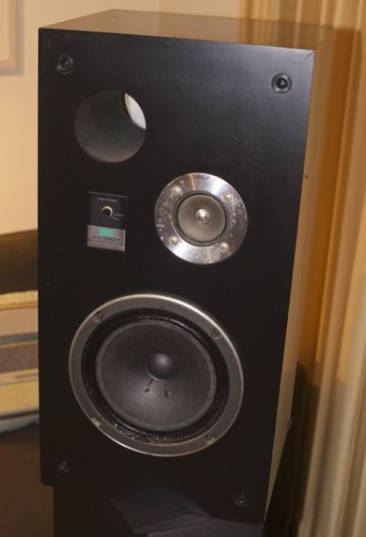

I have some Sansui AA3900 speakers that I think may be worth some TLC and experimentation. Think they date back to c1979 and cabinets and drivers appear to be very good condition. I haven't fired them up at all as I want to gen myself up first. Can anyone give me any first hand experience of their merits or otherwise?

EH! I think I caught the right pic from the web: Sansui AA3900 corresponds to a
two drive unit, fairly big for today's standards....maybe not- considering the floorstander speaker type.
Being this a freestanding one, it has a huge baffle. The port is also huge.
Tweeter's huge 😛
And the woofer : the inverted surround is a good thing
The metal rings are for cosmetics, but (should) harm the sound
Talkin' about sound...check tweeter's extension >16 kHz
A good mod ( after checking the crossover 🙄 ) would be a supertweeter
or change the tw to a performing one
or put a big ( same as woofer's diameter) waveguide to a strong dome ( Al) tweeter, given the fact that a 8" requires a low crossover freq.

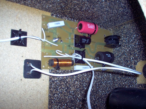

I've not yet played them. Would you recommend the crossover is looked over before any gentle signal is applied, or just start gently with small amp and keep fingers crossed? I've had them in a dry garage for several months, but brought them into the house to make them feel a bit more loved ahead of any testing.

Looks fun. These sort of speakers benefit from a proper 2nd/3rd order crossover rather than the usual single 3.3uF to the cone tweeter.

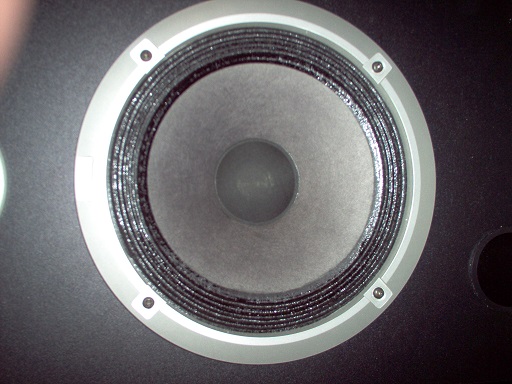

Can't see what the bass surround is, often tarred cloth, sometimes rubber roll, but condition is important. What is it? 8"?

Sounds like some wisdom there Steve. Woofer is 8" to outer ring and surround appears to be tarred cloth. Surround is very tacky and drive unit seems to be quite free to move, so figuring all that sounds positive? Tweeter is relatively large. 56mm across to a casual measure. Assuming the crossover will be healthily low, avoiding seam in area where our hearing is most sensitive. But wonder how much upper frequencies it will muster. I've not fired them up as thought I'd get some gen from forum first. Great also to see that Hampshire is hotbed of hifi knowledge. You obviously talk with some authority of adjusting crossover. Was original crossover overly simplistic, or too complex, or do you just think this will suit modern tastes? best regards Beachcomber

I like those old tarred cloth bass units. Here's a sony one. I also like cone tweeters and proper crossovers. You can get a belting sound out of those Sansui AA 3900 units with a bit of modification.

Hi Steve, OK you do sound officially knowledgable now 🙂. Are you the person wielding the soldering iron for this work? Am I right that tacky tar is a good thing then? i.e. hasn't dried out and become immobile. Should I just give them a few watts and see what happens or do you recommend I get someone to look at crossover first?

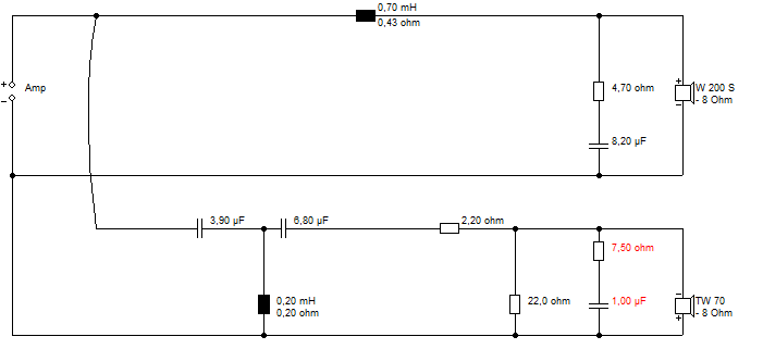

Here's what I did to a Sony E44 much like yours. Good sound. 3kHz steep crossover.
You could probably use that circuit. I skipped the red components in the end.
Originally it just had a little blue 3.3uF electrolytic on the tweeter. Sounded a bit rough.
