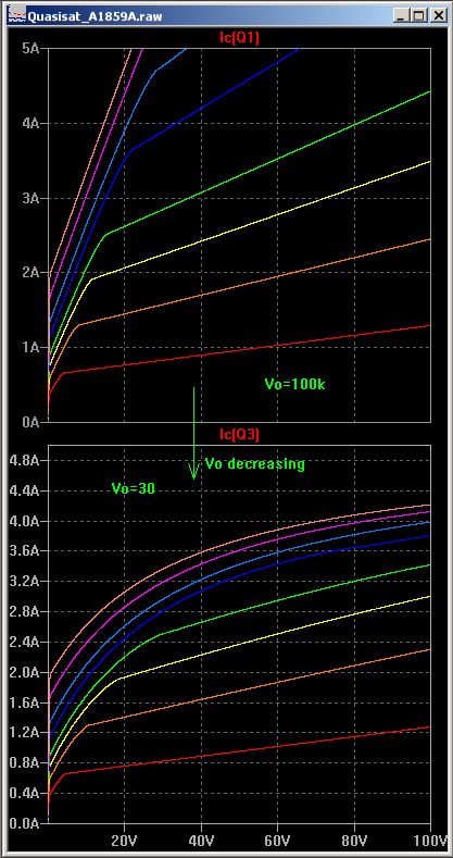

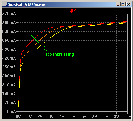

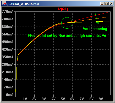

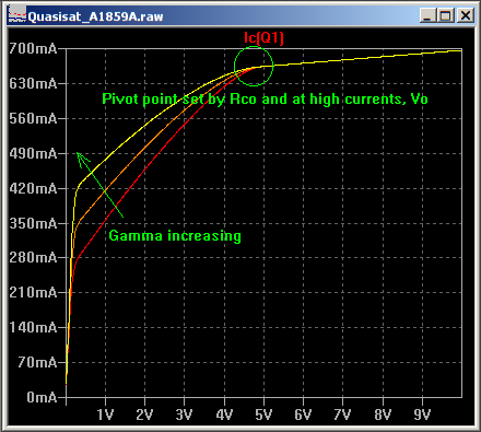

I adjusted the quasi-saturation parameters and collector junction parameters to match the Vcesat charts in the datasheet. I found some app notes that helped explain the quasi-saturation parameters and what they do. It's not hard to understand after you find the nearly nonexistant documentation. Here are my notes on the quasi-saturation parameters:
Rc is the constant part of the collector resistance. This sometimes defines high-current Vcesat.
Rco is the variable resistance of the collector epitaxial region. It rises to this value during quasisaturation.
Vo is the saturation curve that the quasisat curve branches off of. Usually this is high enough it doesn't matter.
Gamma determines the slant of the quasisat region, pivoting around the corner set by Rco.
Qco is the dramatic drop of Ft when in the quasi-saturation region.
I use Nk to get a better match for Hfe, but since the Hfe charts and Vce charts actually don't match, I didn't bother trying to get it perfect either way.

I thought I had saved those references to my computer, but I can't find them. Such is life. There was one amazingly good paper that had conceptual diagrams of the Vce chart showing the effect of the quasi-saturation parameters. After seeing the charts it was pretty obvious.
Since I can't find the original source I've made my own charts which should be just as good to understand the conceptual affect of these parameters.
