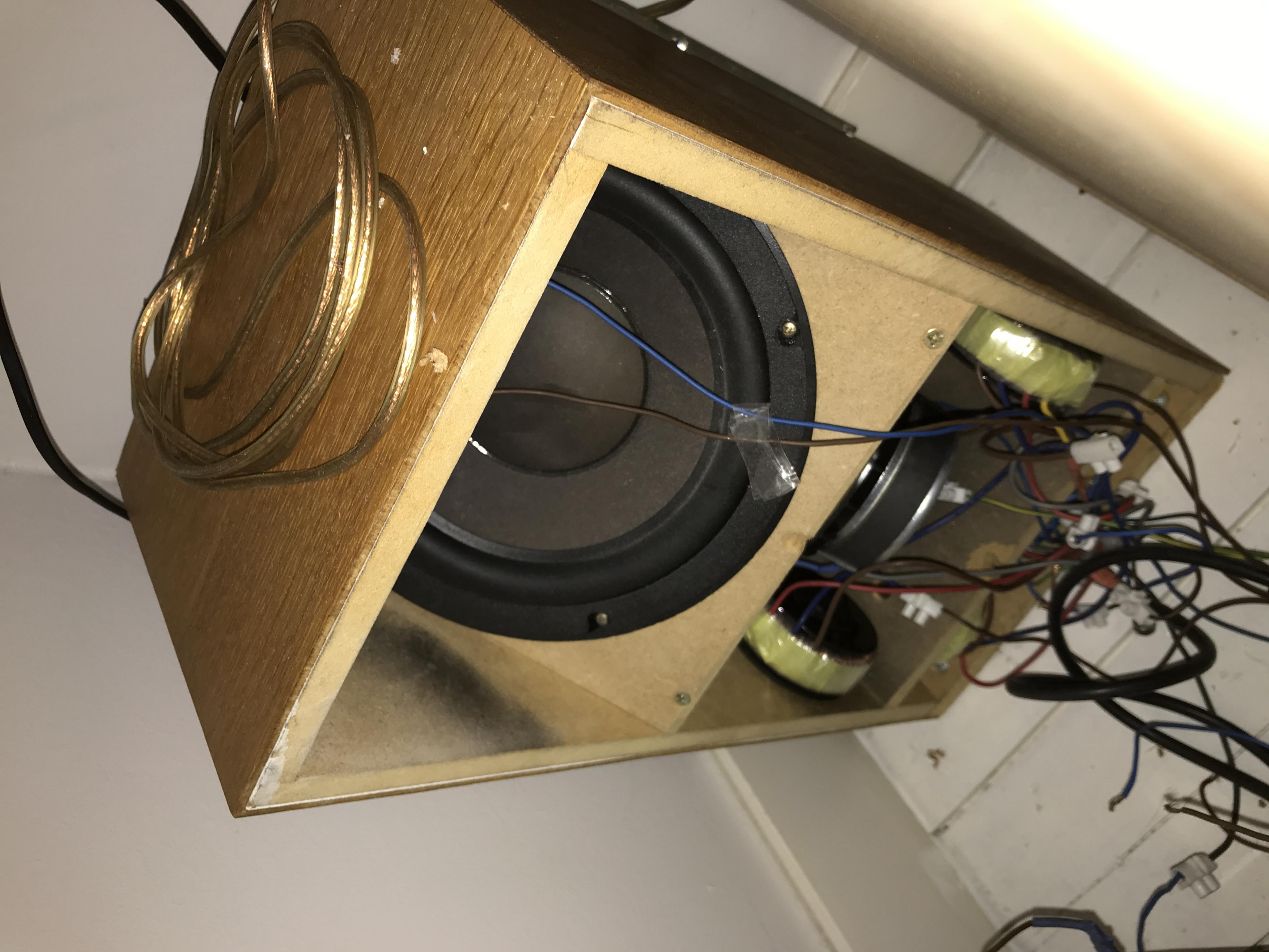

What are the speakers in your avatar?
Those were my first ESL's built in 2008 using perforated metal stators. My latest speaker shown below uses segmented wire stators:

Nice work Jeronimo. I see a pair of transformers stuffed in there so there must be an ESL panel somewhere-- would love to see it.
