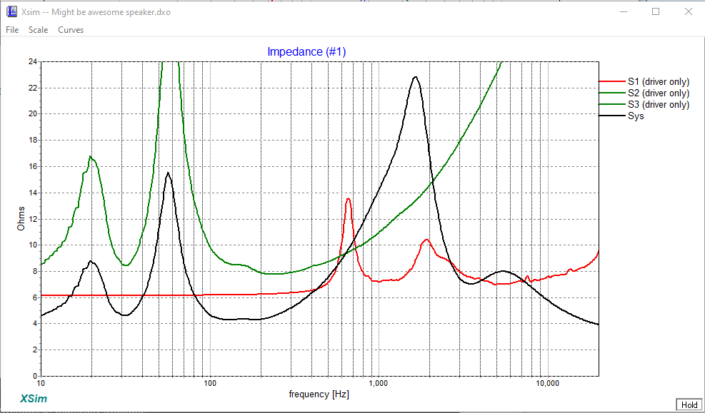

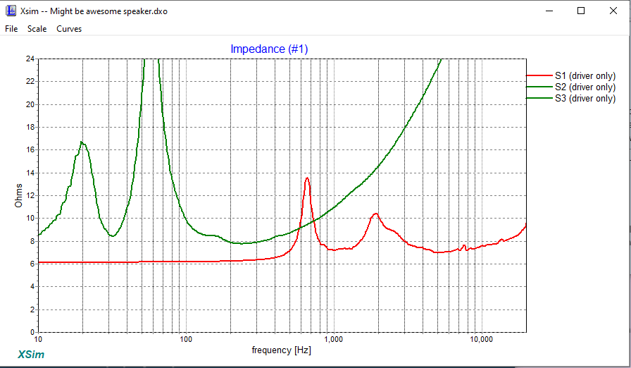

So I need a sanity check- I have all the parts- needed. FRD/ZMA for SDS woofers for simulation provided and measured on 37.5H 8.5W 10.5D box with DATS by someone in another DIY forum.
FRD/ZMA for D220TI were also provided and measured I was told- not sure baffle size...anyway I am just trying to get close and use some these drivers I have. WG will most likely be HM17-25 seeing as I already have 2. I have 3 dayton audio H6512 but not sure how id like such a large wave guide going vertical. If you think im being an idiot please let me know lol- if you see a issue please explain it to me like im an idiot-
This will be a good way to use up a lot of stock sitting around and if it turns out they way I hope, I plan to do the rest of my speakers like this for our theater.

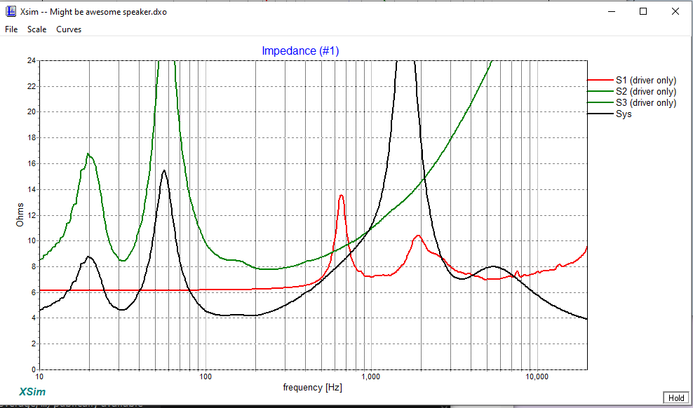

SDS 160F25PR01-08 is the woofer. again I have everything I need minus the 30uf cap if thats better- I have 1.5Mh but no labels haha so will be pain figuring out which ones they are..
With this XO i have 5DB NULL at XO when inverting tweeter..
WITH THIS VERSION i have 10DB NULL AT XO- I just changed CAP on Woofer to 30DB

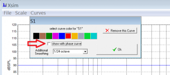

It's not important how big your null is, it's what you do with your phase shift that counts... Turn off system phase in Xsim and turn on individual phases.i have 5DB NULL at XO
