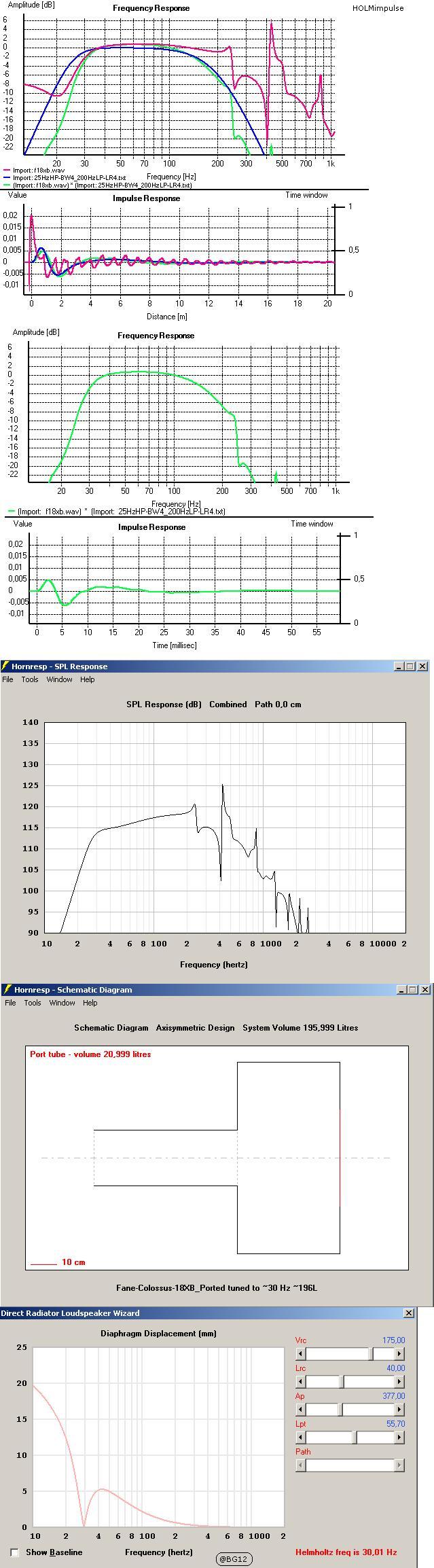

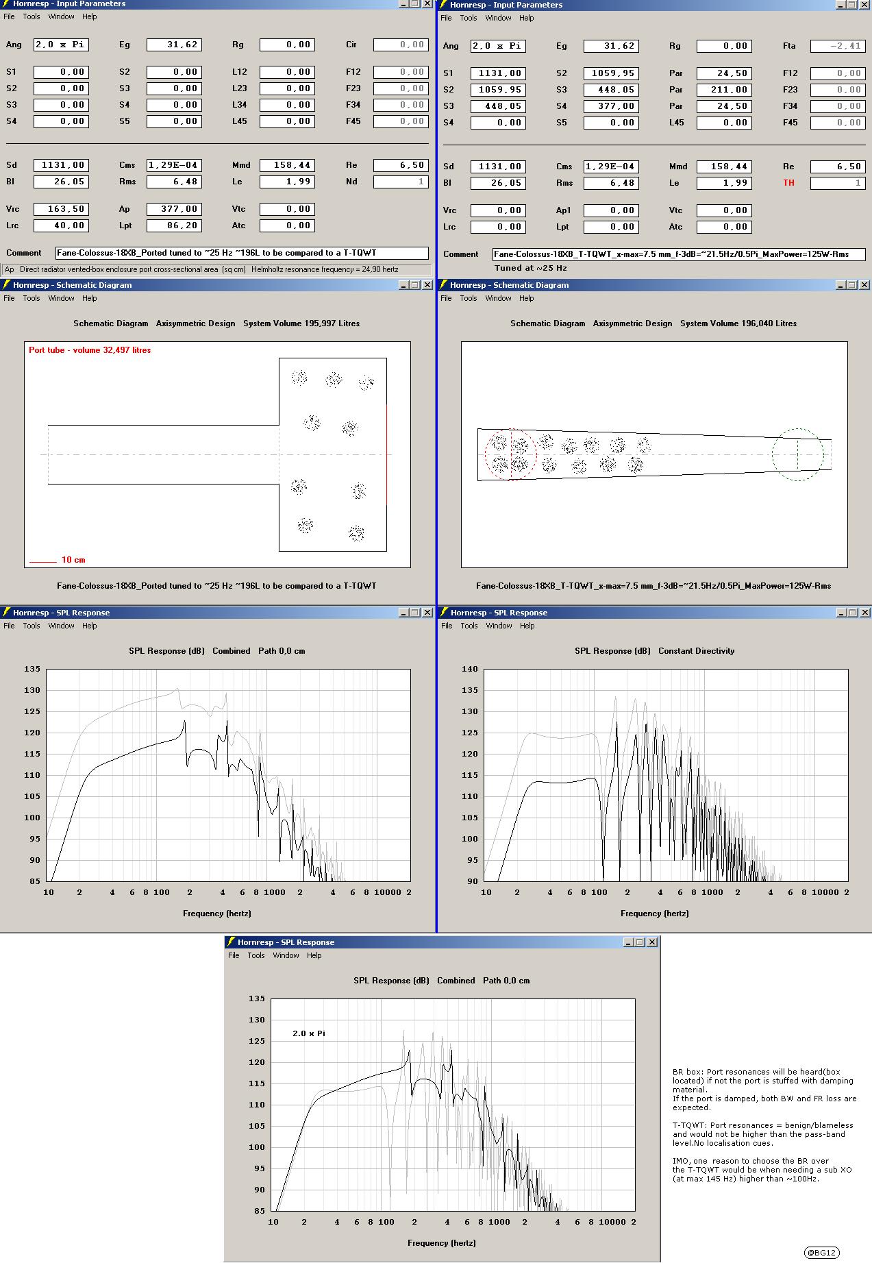

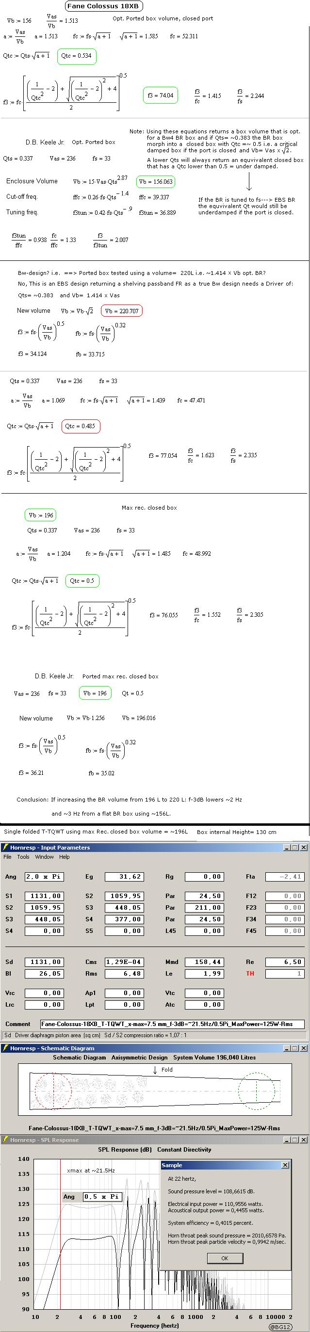

Hi Peter,
Take a look at this:
b🙂

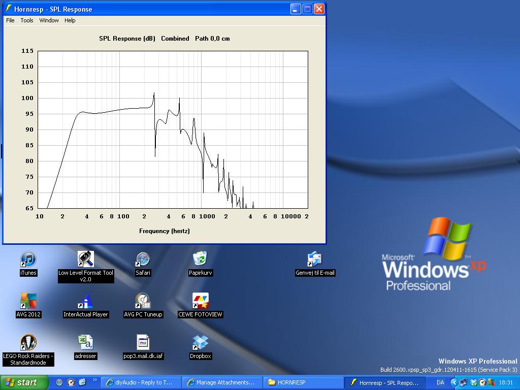

I have tried to model my own suggestion using HornResp, and it looks ok as far as I am concerned! However, one problem is the spike just below 300 Hz due to a rather deep cabinet.
Q: Do you think I will be able to hear this spike when using a 24dB/octave crosover at 200 Hz?
Bjorno: Thanks for the detailed calculations - I am impressed! Since my mid/high combo only reaches just below 200 Hz, I will have to go for a vented solution though.

..Q: Do you think I will be able to hear this spike when using a 24dB/octave crosover at 200 Hz?..Peter
Answer: No. Picture hints:
b🙂
