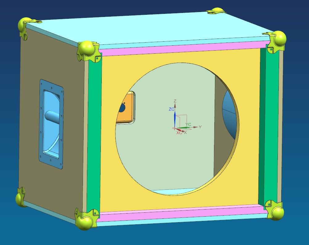

Decided to press on regardless and knock out most of the model for the sub cabinet today after work. All the parts is able to be scaled up/down from the assembly per desired front baffle size and enclosure volume, so I can easily switch it up to be vented instead. Got some penn-elcom hardware imported too which will come in handy for the other enclosures, and I'm getting in the swing of things (cabinetry is not my day job).
Once I finalize drawings, I have a buddy who can CNC route 18mm birch ply for me, which is sort of the impetus for this whole science experiment.

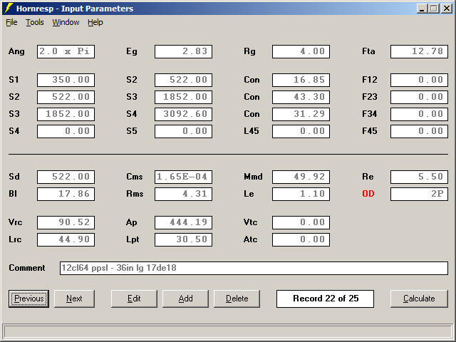

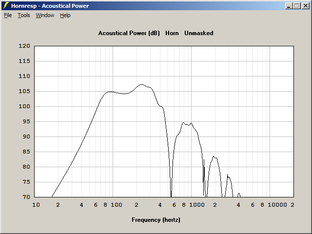

So, after going through JBL's current catalog and calling up a dealer for pricing/availability of certain parts like gaskets and phase plugs, for the tops I definitely want to basically duplicate the JBL MD49, so the PT-K95MH waveguide loaded with the 2169H from 270 up to 2.7khz and a 1.4" throat compression driver going up from that, possibly 2452H from the higher-end MD2.

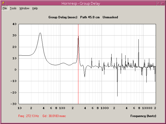

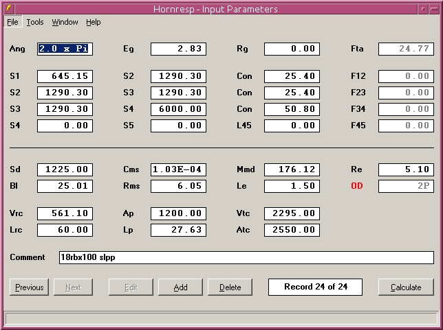

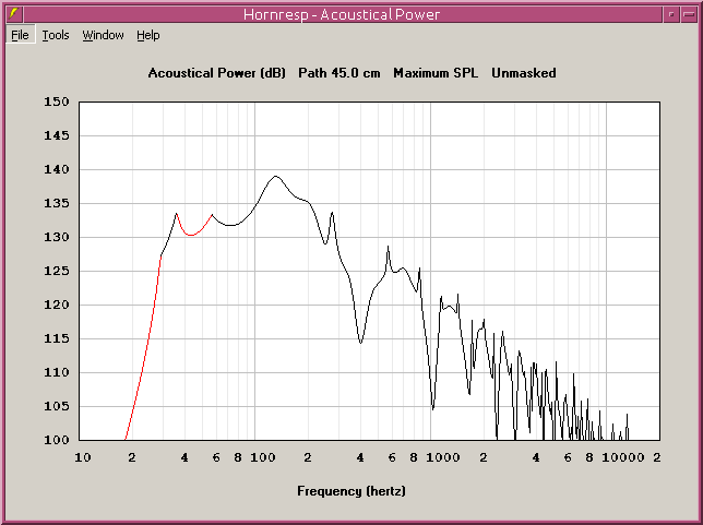

After the very helpful feedback in this thread, I began looking into higher output/efficiency for the sub. I stumbled upon the PPSL design, and began doing some sims in winisd/hornresp. Switching from the extremely expensive 18XL1800 woofer to two woofers that cost half as much each, the 18RBX100, and doing a vented box with slightly higher tuning than I had been hoping for initially seems to yield interesting results.
A 20x10" slot just big enough to fit the drivers into gives a 1.9:1 compression ratio, and sinking the plenum deeper into the box and adding a horn mouth actually seems to add some efficiency. With the back corners of the slot filled to reduce the volume in the horn before the drivers, it looks like it could actually play up to that 270hz crossover points well.
These would certainly be massive things to move, taking up something like a 4'x4'x4' cube each (although making them narrower in one dimension and taller in another may be beneficial to handling), but if the subs can play from 33-270hz, that saves me from needing a separate set of midbass enclosures.

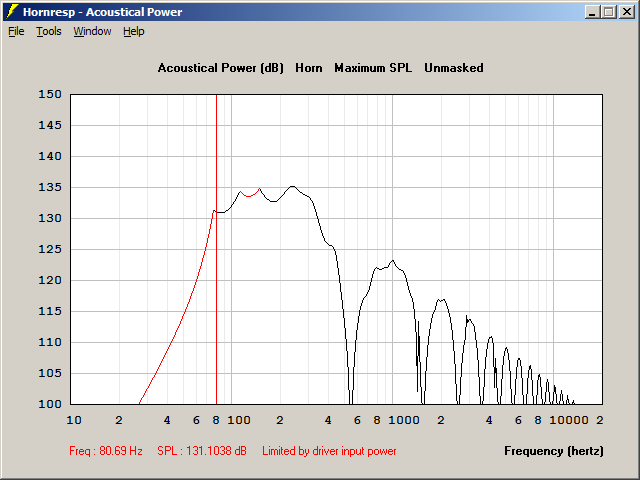

Does this seem reasonable, or is 33-270hz too much to expect from a pair of 18's? The hornresp sim makes it seem like after EQ'ing those humps down, you could get 130dB max SPL from 33-270, is that too ambitious?

A >500L back chamber is a huge box. I'd argue that's gonna be a 4-man lift. Minimum. If there are any stairs, forget it.
For the size of the rooms you're looking at, there's genuinely no need for a 4-way system.
4-way systems always end up big and complicated, and very difficult to get right.
3-way systems are easier to get right, and would be aligned well (IMO) for the sort of size gigs you're looking to do.

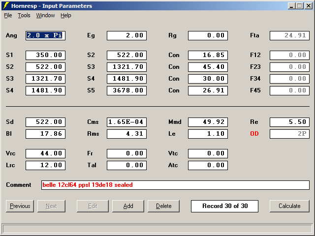

Forgive me if I'm gravitating to strange/impractical designs, but I spent some time looking further into the vented rear chamber + PPSL plenum + conical horn idea, but downsized greatly.
If I'm sticking (for now) with the JBL mid/hi progressive transition waveguide (8" mid, 1.4" CD high, bottom crosses at 270Hz), and we've decided stereo subs up to 270hz is a dumb idea, then we're into a 4-way system and we need a pair of midbass enclosures that can play 80-270hz.
The B&C 12CL64 weighs just 4.2lbs per driver, and seems to sim well in a 2:1 compression PPSL plenum feeding a horn with an 80Hz expansion truncated heavily back to just 36" horn length. Back chamber is 90.5L with a tuning of 52Hz.
The mouth measures 17.2"x27.8" and I assumed a 17.2" x 6" rectangular port underneath, so the box wouldn't be so large at all. Total system volume is only ~240L which is ~2'x2'x2', so I need to set aside some time to figure out the CAD but I think if bend the horn and add an access panel to load the plenum from the side, total size of the enclosures would be manageable, particularly given the predicted output.
I still think you're on the wrong track, sorry.
2x10"s (Faital Pro 10FH520) in a ported box would keep up with that horn in output, in a smaller box, and make it up to 1kHz easily. 1.4" HF unit above, add subwoofers, and you're done.
I'm using those drivers (and a HF horn) in a cabinet that's around 800mm x 300mm x 250mm (HWD), and it's enough output for outdoor festivals. FWIW, they'd match well to 4x QSC KW181 per main speaker, which would be around 18dB louder than what you originally said was enough.
Going 4-way with three of those sections horn-loaded will be a serious undertaking, and IMO a serious departure from what you set off to achieve.

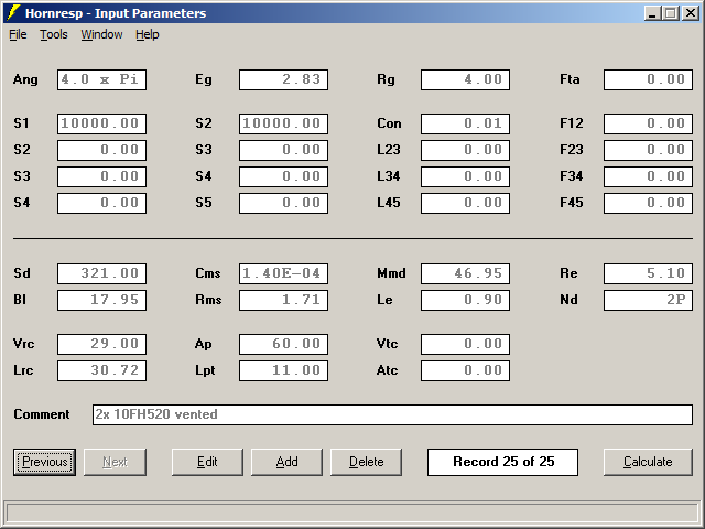

Appreciate your patience with me. I'm having difficulty replicating your empirical experience through the conceptual/analytical simulation-based approach, which I think means I must be doing something very wrong.
I have attached an overlay of the maximum SPL chart of the proposed 2x12" horn-loaded cab with an equivalent max SPL chart of a 2x10" vented cab of 29L tuned to 60Hz.
Probably worth going into the assumptions made:
  • 2x12" horn loaded radiates into 2pi space (270Hz LPF ok to set on floor?)
  • 2x10" faital vented radiates into 4pi space (1000Hz LPF needs to raised high?)
  • Pmax in hornresp set to 1/2 the rated power handling (300w for the faital driver, 125w for the B&C 12"
  • Xmax in hornresp set to the manufacturer's rated Xmax (7.25 for faital, 4.5 for B&C)
You've got a 4ohm resistor in series with the cabinet, and the Faital Pro drivers are happy with 1200w peaks per driver. IIRC I used 90v RMS input levels on my simulation, although my current amplification will go past 100v.
Why are you setting the power levels so low?
I also tuned the 10"s at more like 80Hz for a bit more mechanical power handling, although when you've put a 100Hz 4th order crossover in there, it's largely moot.
Chris
Ah, that's what I was missing, Rg should be 0 unless I want to simulate voltage drop in the cables / amp.
I had wanted some sort of safety factor, but I suppose two hours of pink noise is probably the worst case imaginable and there's no need to pad that number further.

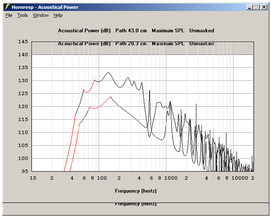

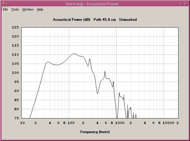

Hopefully I'm not beating a dead horse here but, I tried to combine some of the different ideas I had explored previously while looking at various enclosure types.

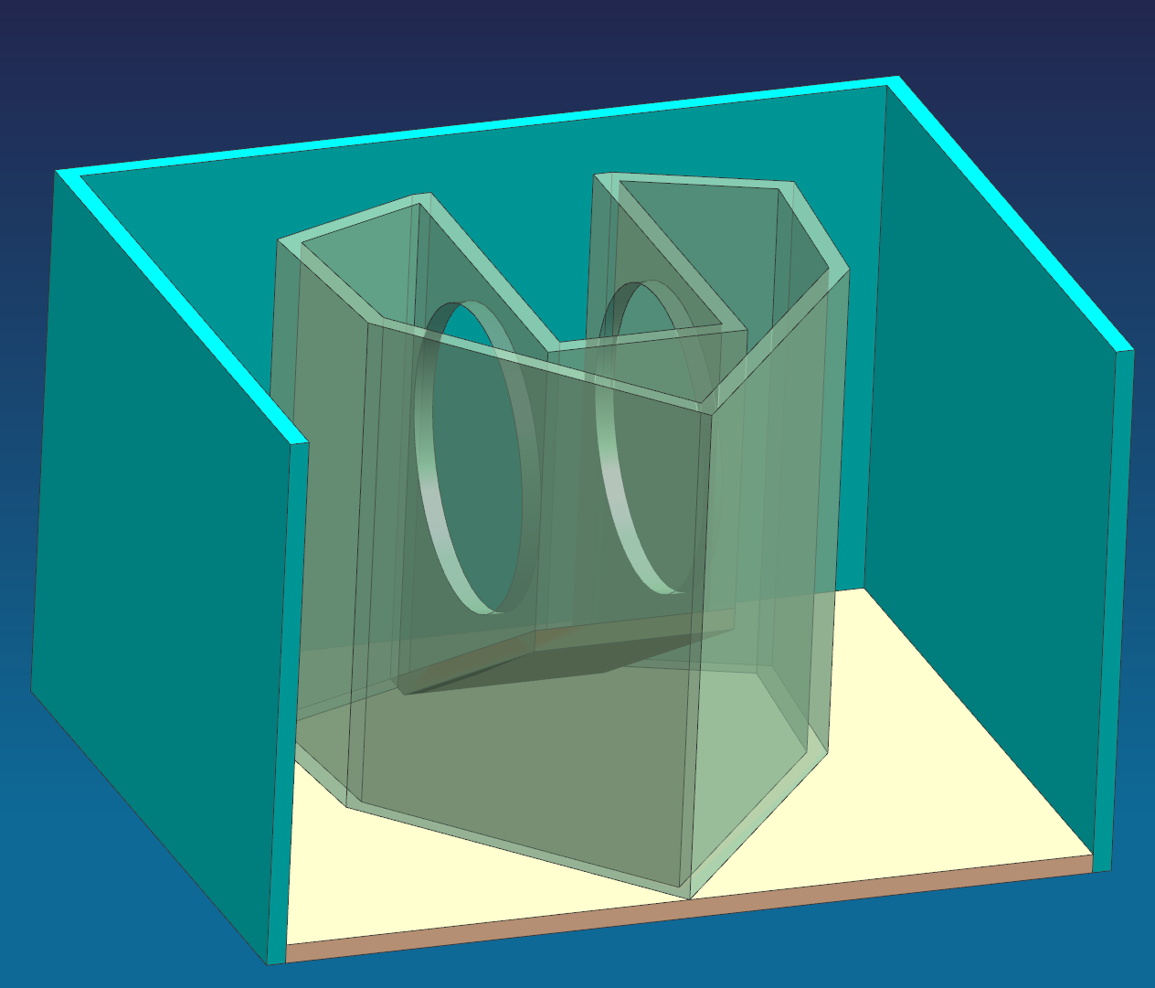

Here is a simplified La Scala type cab, internal dimensions 77.14cm*60cm*47.68cm, 18mm thick ply. The sides of the doghouse in the plan view now form an irregular heptagon, which means that all of the flare happens in that view (fewer 'ramps'), except for one piece. Drivers are still those B&C 12CL64, and they'll load into the doghouse via an access panel on the top (or bottom, probably, I think I've shown the cab upside-down here).
Before adding bracing, the volume inside the doghouse is ~44L.
I realized Hornresp can sim these types of horns where the rear chamber vents into the horn mouth, and after playing around a little, it seems like this design functions better with the doghouse sealed.
This seems like a relatively compact and efficient kick bin, and I'm surprised at how flat it sims.
