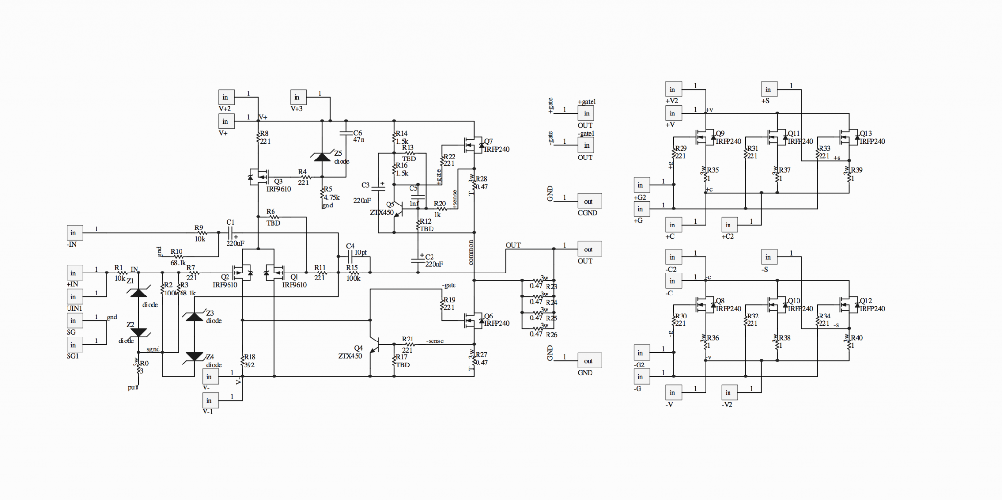

Hi woodturner-fran:3. I think I can use the BrianGT mini-aleph boards with pretty much no changes on the main boards, and then just add the satellite boards populated with the matched mosfets (irf240) and 1r0 source resistors.

But, long story short, you can use the BrianGT boards without changes to connect several output boards for an Aleph 60. I have attached a .pdf covering an Aleph 60 that I think I got from BrianGT's web site (chipamp.com) at the time. The main difference, I think, between Aleph Mini, Aleph 30, and Aleph 60 on the BrianGT board is how the Aleph current sense resistors are configured.

So copied from here it looks like:
R6 may be used to help correct offset if there is a mismatch in Q1 and Q2. You don't need it if you get a good match.
R12 sets the AC current gain. You'd be at 50% with 1K
R13 fine tunes the bias in the output stage. The higher the value the greater the bias.
R17 is a protection circuit part that sets the Q6 current when the protection kicks in. 392R has been used before. I used 1K and 1k2 for R21.
And attached is the schematic for ease of reference. I'm putting this here for my own benefit as much as anything!!

Thank you Claas and Fran for posting the schematics info. I had completely forgotten that Brian's PCB has some different parts numbering.

Some further info on the "tbd" values. As I get more info, I'll post more.
I don't have a value/range of values just yet for R6
People seem to have experimented with R12 going between 680R to 1k. So a 1k pot is probably not a bad suggestion for experiments
R13 - default value seems to be 47k5, and you see from this value up to 200k mentioned in the older treads. So probably a 200k pot preset to 47k is a good place to start.
R17 - this is a bigger range - some are 100R, and you'll see above someone else used 392r. Needs some experimentation, and of course some leave out the protection circuit completely.

R12
easy - when (with signal - say 1KHz,and load connected) AC voltage across R28 is same as across R27, Aleph CCS current contribution is 50% of sum output current
also called Aleph CCS Gain, though - I always found initial Papa's explanation confusing

@Zen Mod - that is very easy, and easier to set on these boards maybe than the newer ums designed ones.
