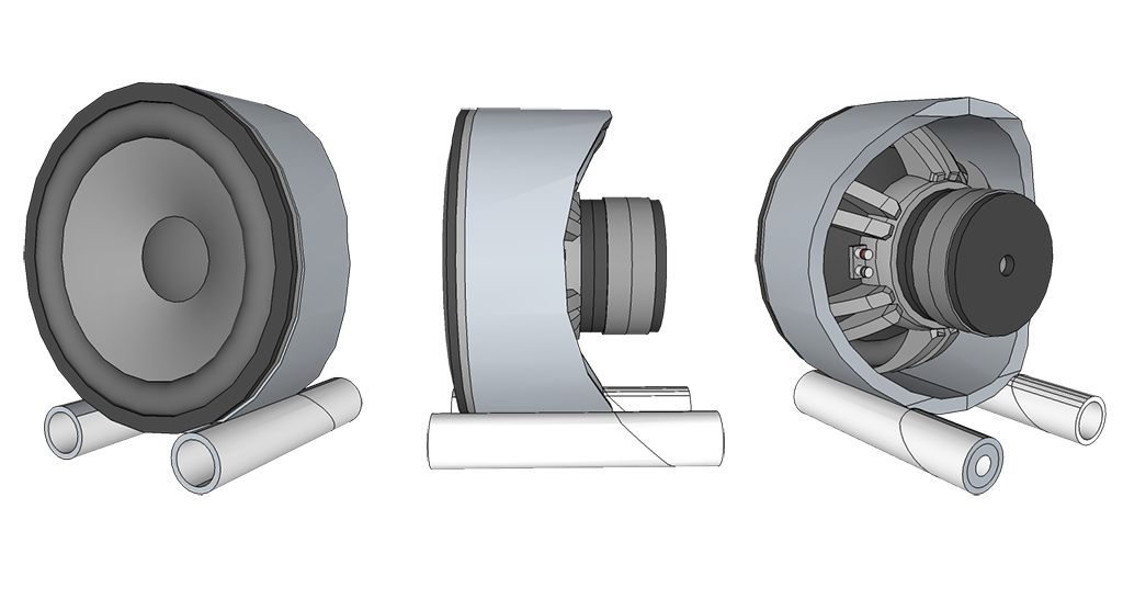

Your paper is very interesting however. Did you do simulations/measurements with baffleless units, but mounted in an shallow cilinder (10 to 15 cm for a 15 to 18 cm woofer). It's like a U dipole, but with round frontend. I'd like to know the effect of that. Not for the Neo, only for bass and mid section woofers.
Edge can't simulate this type of dipole I think. Boxsim can do it for rectangular U frames, but not for round ones.
And I'd like to add another touch, maybe cut out a semicircle of the rear of the tube, hoping to spread even the response a bit more. It would look something like this:
I didn't simulate/measure U frames. For a deeper understanding look at DIY-dipole-1
U frames change their radiation pattern rapidly from dipole to monopole behaviour. Damped U frames have a cardioid pattern.
I've seen that link.
People (And you too, according to your PDF) use H and U frames for bass, for obvious reasons, also without the cardioid pattern, mostly undamped. I though that using a shallow U frame would would give me best of both worlds, and making it rounded on the back, helping me smoothing response.
People (And you too, according to your PDF) use H and U frames for bass ...
Where do I give the impression that I use U frames? I haven't built one in the last 50 years. 🙂
A real U frame will typically change from dipole to almost monopole within two octaves. If the side wall depth is less than a quarter of the frame diameter, I would not call it a U frame. To me it would be just an OB with the backside reinforced. 😉
