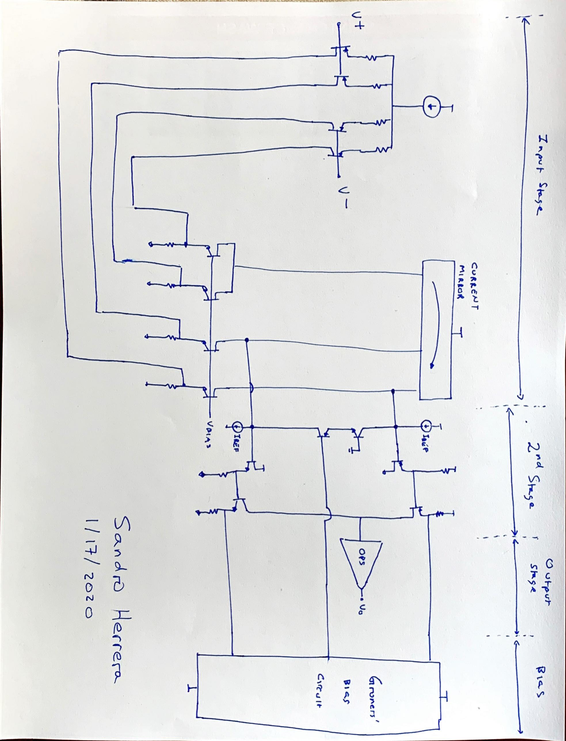

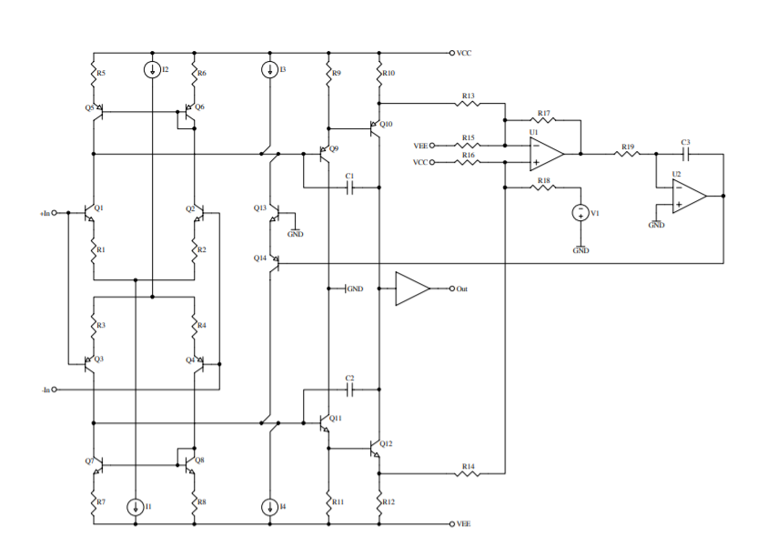

Hi Pete, I just stumbled across this circuit also from Mr. Groner, and I like it quite a bit. No matched transistors needed, only matched resistors.
Regarding op-amp implementations, look up patents by Moshe Gerstenhaber in google patents. Specifically, Rail to Rail output stages. There are a few that are interesting and can be adapted to a push pull VAS (Moshe used to be one of my mentors at ADI along with Scott Wurcer).
Hi Pete, I know that. I put it up because I thought it was interesting and to give you some inspiration. Here is my inspiration from Groner's circuit to fit your needs. What do you think?
The box labeled Groner's bias circuit is the same as the one in the schematic of my previous post: R13-R19, C3, U1, U2, and V1.
Enjoy, Sandro
P.S. Not sure why in the world the forum uploader keeps rotating the picture, in my computer the file is the right orientation 😕

That is really interesting, I like yours even more. I'm going to have to study that for a bit.
