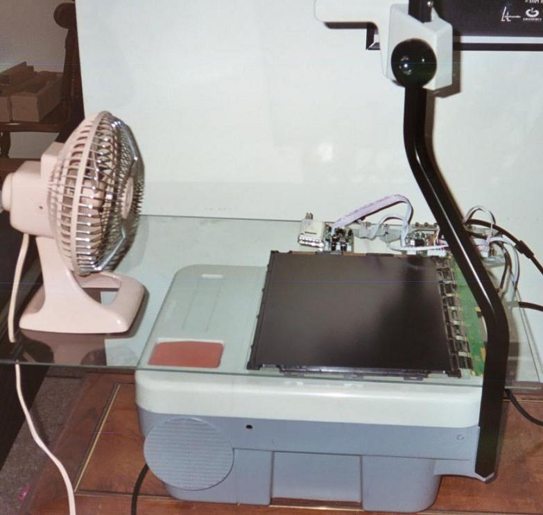

My prestripped LTM150XP came today. I connected the screen to my PC before stripping, it looked good. I removed the frame and the reflector casing, and disconnected the inverter. Once it was disconnected I was able to seperate the LCD from all the reflective material. There was also a block of acrillic inside and a few plastic sheets. I think they were optimized for distributing light from the cold flourescents, and would not be useful in a projection setup. However, I'd welcome a correction if this is not so. There were a couple times that I was sure I fubared something, but when I put the LCD on my overhead and connected everything it semed to work. Hooray!
I'm going to have to build some sort of enclosure, but in the meantime I have everything on a panel of glass. I'll scotch tape the circuit boards so they stop sliding aroung, aim a fan at the LCD, and see how a movie looks when it gets dark.
This panel was prestripped and most of my work was already done, but man, I felt like I was defusing a bomb.

Tried a movie out with the LTM150XP on my overhead. The stage isn't big enough for a 15" LCD, so I ran the movie windowed (800x600 or greater). Even at that resolution it's much better than my Nview Z115 was. Now I've got to scrape the cash together to build an enclousure and so forth, so it will be a while before an update. I took a picture of my current jury rigged setup, I'll post it for laughs Monday.

The backlight was really easy to remove once I found out I could disconnect the inverter board. It does nothing more than power the flourescents in the backlight. There were 2 screws holding a circuit board in a folded position behind the backlight. I took them out and folded it out of the way (180 deg). It is connected by 8 short plastic ribbons which seem fairly flexible. So disconnect inverter-> unscrew board behind panel-> fold it back-> unlock all the pry points-> and the backlight comes right off.
