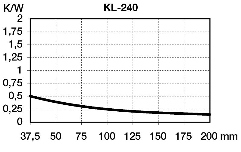

I'm a bit puzzled by different heat resistance ratings for virtually identical heatsinks from Seifert and Fischer.
The sk-130 from Fischer and the kl-240 from Seifert differ only in the thickness of the baseplate as far as I can tell from the datasheets. Yet Fischer gives a heat resistance rating which is about double that of Seifert (~,5 K/W versus ~,25 K/W for 100mm heigth).
Which am I to trust?

you must look out the information sheets from both manufacturers where they define the test conditions used to rate their heatsinks.
The biggest difference is made by choosing a different DeltaT s-a.
But this, with other conditions, could account for this apparent 2:1 discrepancy.

You have luck, because this is exactly the heatsink profile I used extensively for my Class A power amps, such as here :
http://www.diyaudio.com/forums/showthread.php?s=&postid=1744005&highlight=#post1744005
I used Seifert, but it is exactly the same as Fischer. The Seifert thermal data are attached.

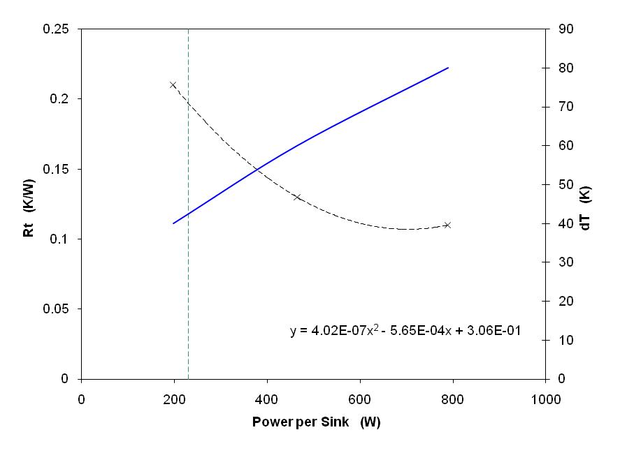

A third supplier who produced the same profile was kind enough to do a full blown simulation for my application (length 550mm, free convection, black anodised, vertical), and you can see how things depend.
Patrick
Neither figure is close to reality if you are trying to operate at say 55°C.
Patrick

In my experience, the values provided by Fischer is on the optimistic side if you want to work with a 30°C temperature difference. And you would almost certainly NOT be able to reach the values stated by Seifert.
Even with a height of 550mm instead of 100mm, the heatsink I used can only dissipate 220W with a temperature rise of 40°C, or 0.17K/W (proven by measurements). I know that height above 150mm does not bring a lot, but to hope to get 0.23K/W with a height of 100mm is IMHO a bit unrealistic.
But prove me wrong, by all means.
Patrick
