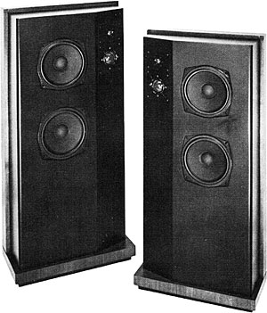

Hi, I discovered two speakers using the same drivers and crossovers. But different box sizes. Yet they both provide good sound.
They are ADS L810 and L1230. As mentioned above, these speakers have the same drivers and crossovers but different box shapes and sizes. They received many positive reviews. Many audiophiles will know, especially in the US.
How could it be? Does this mean their woofers were designed to perform well in various box tunings?

Because there is no such thing as one perfect box size for a woofer for every sitiation/needs, it all depends on what's the goal. If they are really the same drivers and only the box size is the difference between them, then they must have slightly different low-frequency response, but probably both are "good"(if they are reported as good), just slightly different.
Hi, Inside dimensions of a box need to be "big" for bass alignment, but the bigger the more modes inside for the passband, the more panel surface area to radiate noise, and front panel area to create directivity/diffraction, which makes secondary sound sources other than the transducer itself and affects how sound is radiated into room. All of which is more or less audible and lends to sound quality.
In general what you have is some sort of compromise between low frequency sensitivity (and system Q) and amount of midrange issues. For least issues one would want the box size very small or very big, small doesn't have bass and big is not practical so what you endup is some box with some issues and some bass 🙂
If going after minimal issues one should always optimize for midrange performance with cost of bass performance, because one can always add more bass boxes to a system, problem solved.

Had to search for this speakers. Are you sure they use the same crossover?
Volumes are maybe not THAT different - the big speaker is shallow and you don't know the internal volume, maybe the tweeter side is not part of the volume?
Smaller speakers often have a bumped low end to sound bigger. For a closed speaker this could be a Q >1 to achieve that. That would be way less volume as a Q of 0,6-0,7.
And I hope they don't use the same crossover ... these baffles are way different. If they do - I would say it's luck how it worked out ;-)

Theory states that a volume change of 20% has less influence one would expect.
Especially using closed box system.
Depending on the room and maybe different damping inside the two sorts of boxes there will be little audible difference.
And as said here: the bigger the box the more difficult to control the radiation of the surfaces. But those resonances can be pleasing to some ears giving a slight "colour" to the sound.
