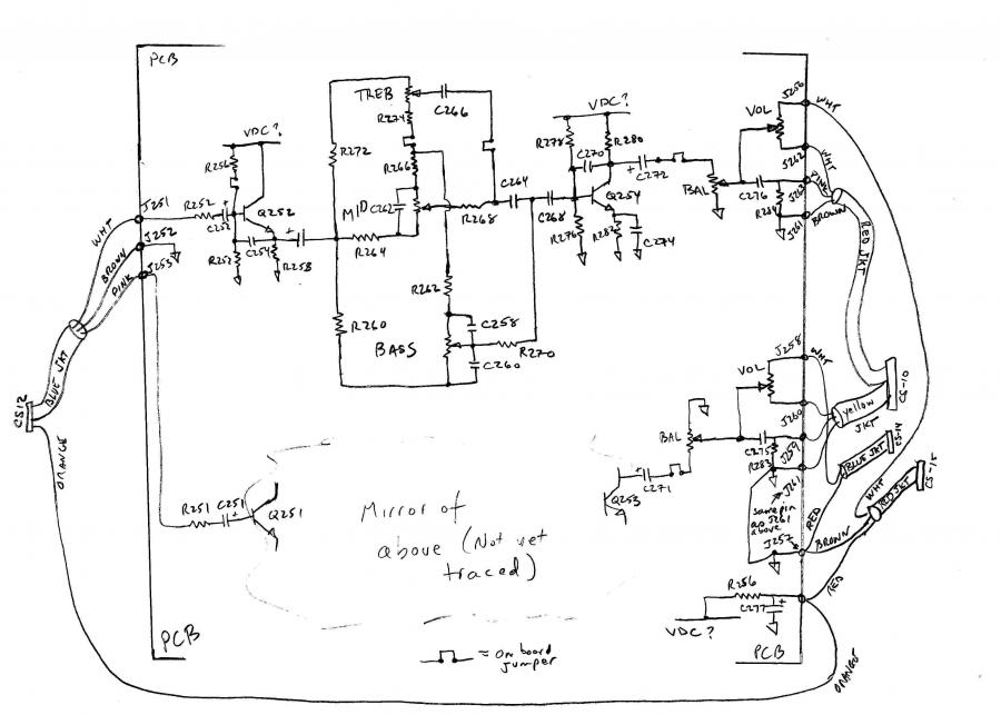

Pre-amp - Has bass, mid, treble and vol/bal. I've traced the pre-amp (not the RIAA pre yet) and have a good picture of its topography. I'm getting hung up on the output connections and power supply rails. I know this area should be the easiest to reverse engineer but am having some difficulties. Can anyone help me with the complete schematic . . . anyone have it? I searched, and searched and come up empty so far.

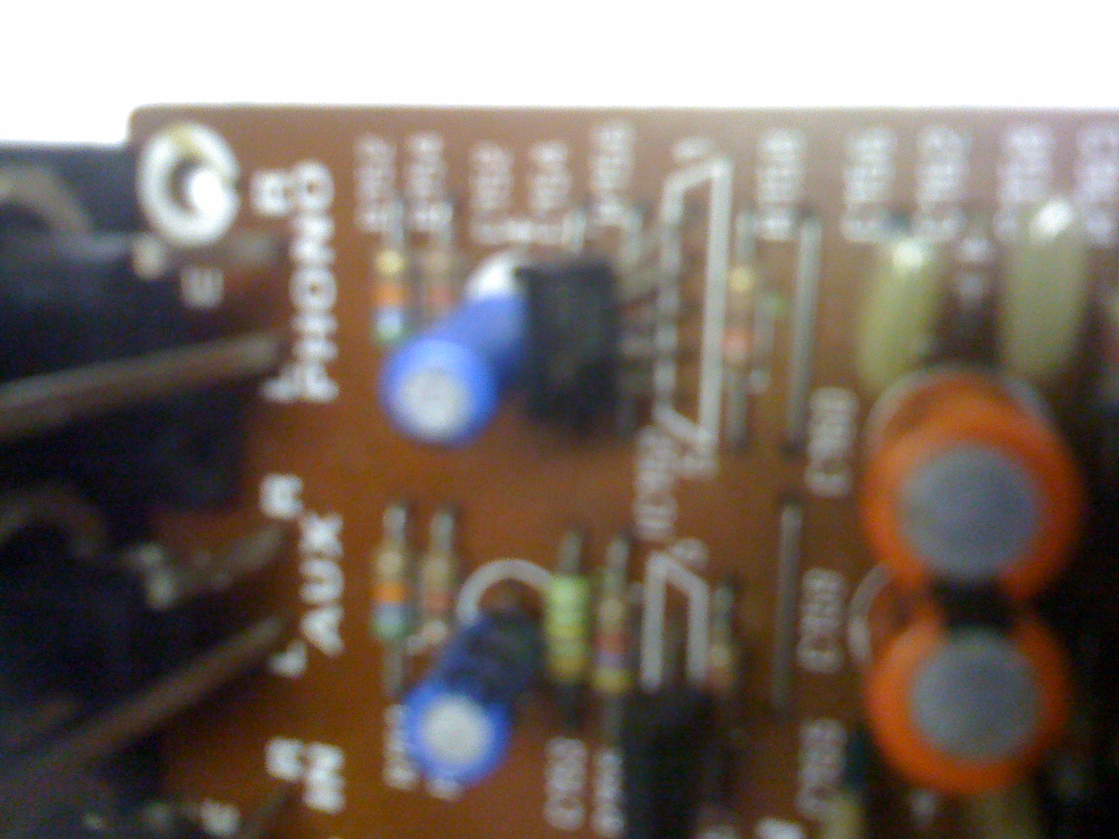

RIAA phono pre - this section is nicely congregated near the phono inputs of the RCA input board. There are two 5 pin ICs (IC151, IC152) both labeled "ML120 1301". Again searched and searched and can't find anything on this. Does anyone know what this is. I suspect it is some kind of opamp.

Schematic
So, after several hours over a few evenings, below is the preamp schematic. One channel fully traced, the other just the I/O sections. This is pretty accurate, hopefully minimizing tracing errors. Not fully analyzed but looks like a usable 3 tone control with vol/bal pre-amp circuit. Having problems understanding the volume control circuit where both ends of the dual pot go to another board (white wires on CS-14 and CS-15).
What about the power rails? It appears as a single ended supply with +VDC and ground. Is this correct or am I missing, not seeing something here. And why does it enter the board through R256 (I haven't measured the value)? What would be the suspected voltage(s). +12V?
If the image is not clear, I'll re-up.
Again, hanks in advance.

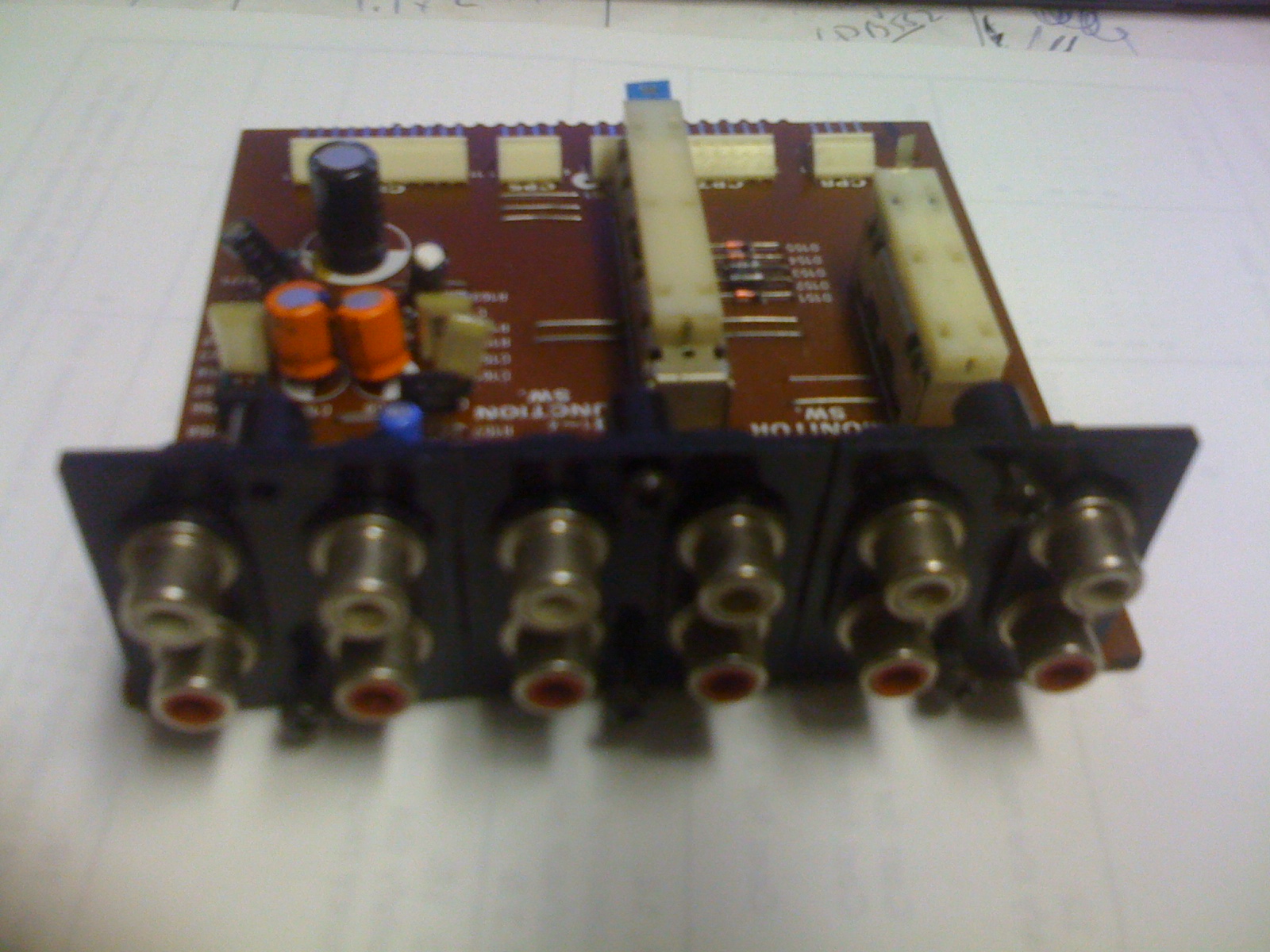

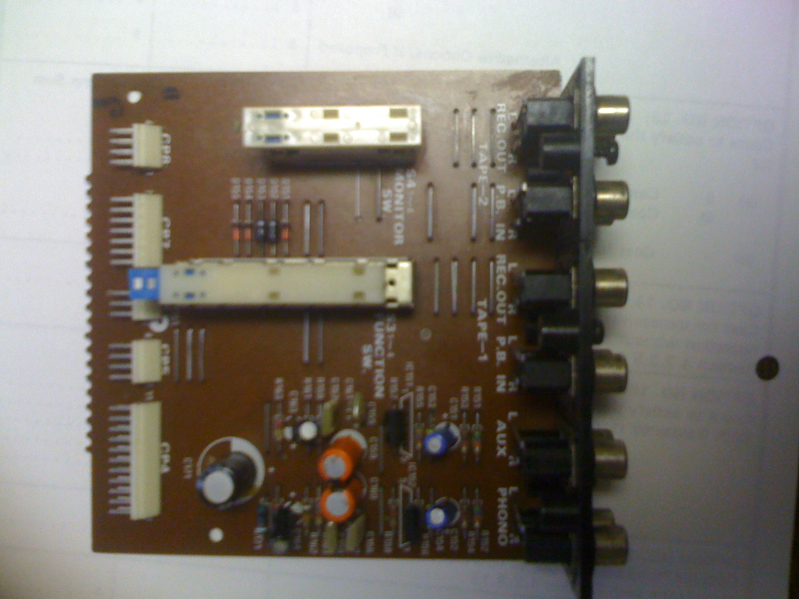

LXI Phono section pictures
Below are pictures of the phono section. I apologies for the blurryness as they were taken with my iphone up close (and it doesn't do up close well).

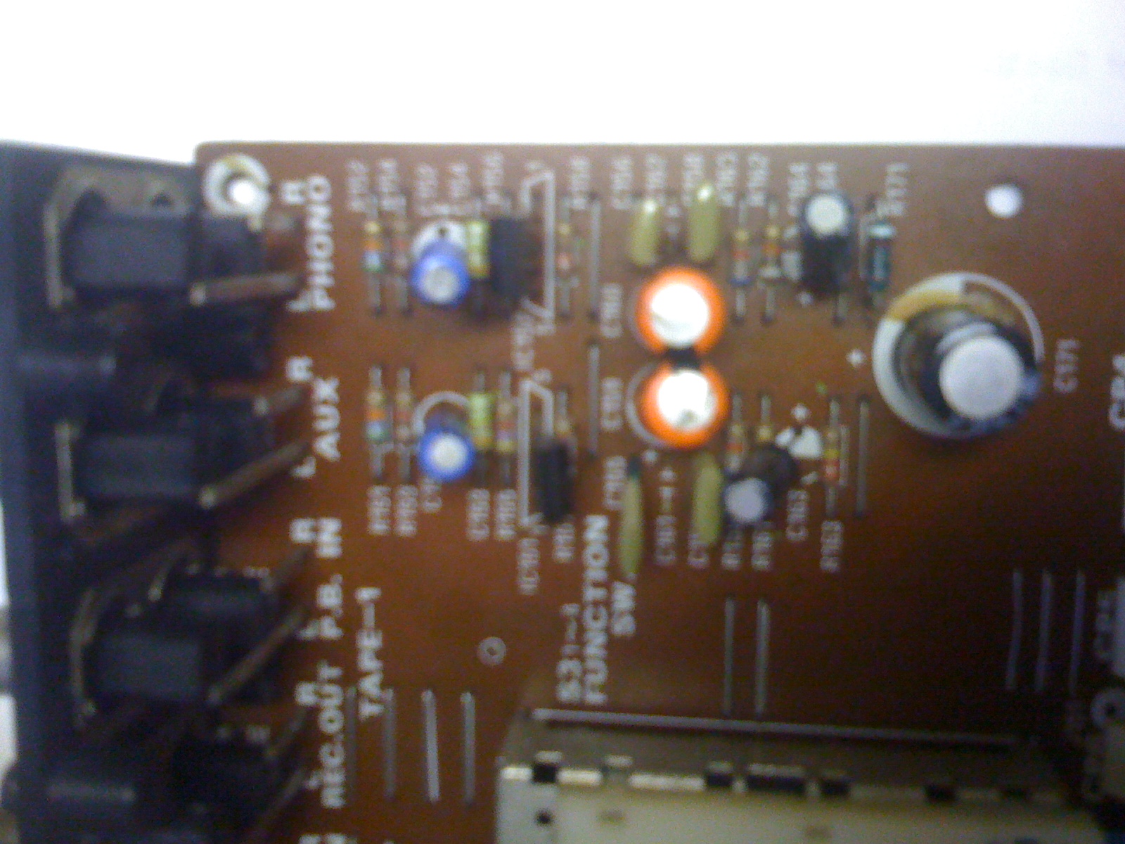

Some more pictures:
(Again very sorry for the blurry shots).
Edit: Closeup (poor) of the 5 pin SIL which I suspect might be an opamp. I have spend many hours searching on the net but cannot find this device.
