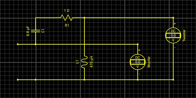

I was assuming that coil is to go to the woofer........simple first order, can you draw out the circuit? It's kinda difficult to decipher what goes where by the pictures...it's all kinda scrunched together.

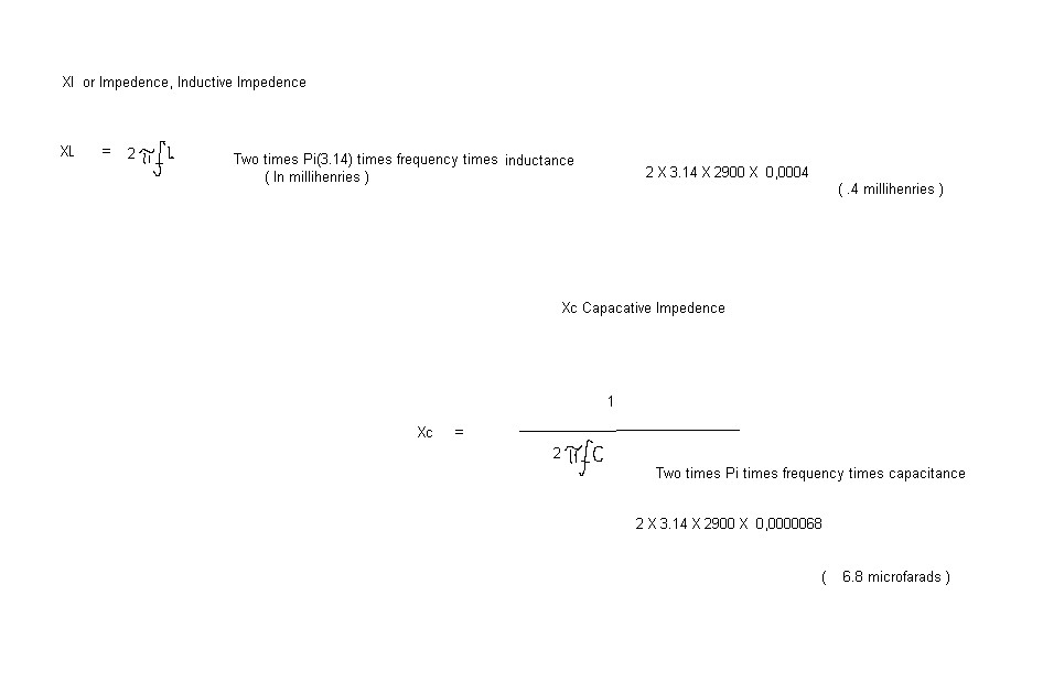

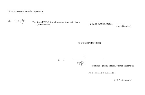

Capacitors & coils work rather in opposite ways. Both act like variable resistors according to frequency. Coils cut-off higher frequencies as capacitors cut-off the lower frequencies....but are now considered Impedances, not resistors.
If you graph out a collection of frequencies & plug them into these two formulas you will get two curves, one for the tweeter & the other for the woofer. The results are in Ohms & you'll note they "come together" at a common value which is considered the cross-over frequency.

so i has off by a hundred hz.
from the pic's it appears that the coil is in parallel with the tweeter after the cap but i could be wrong
