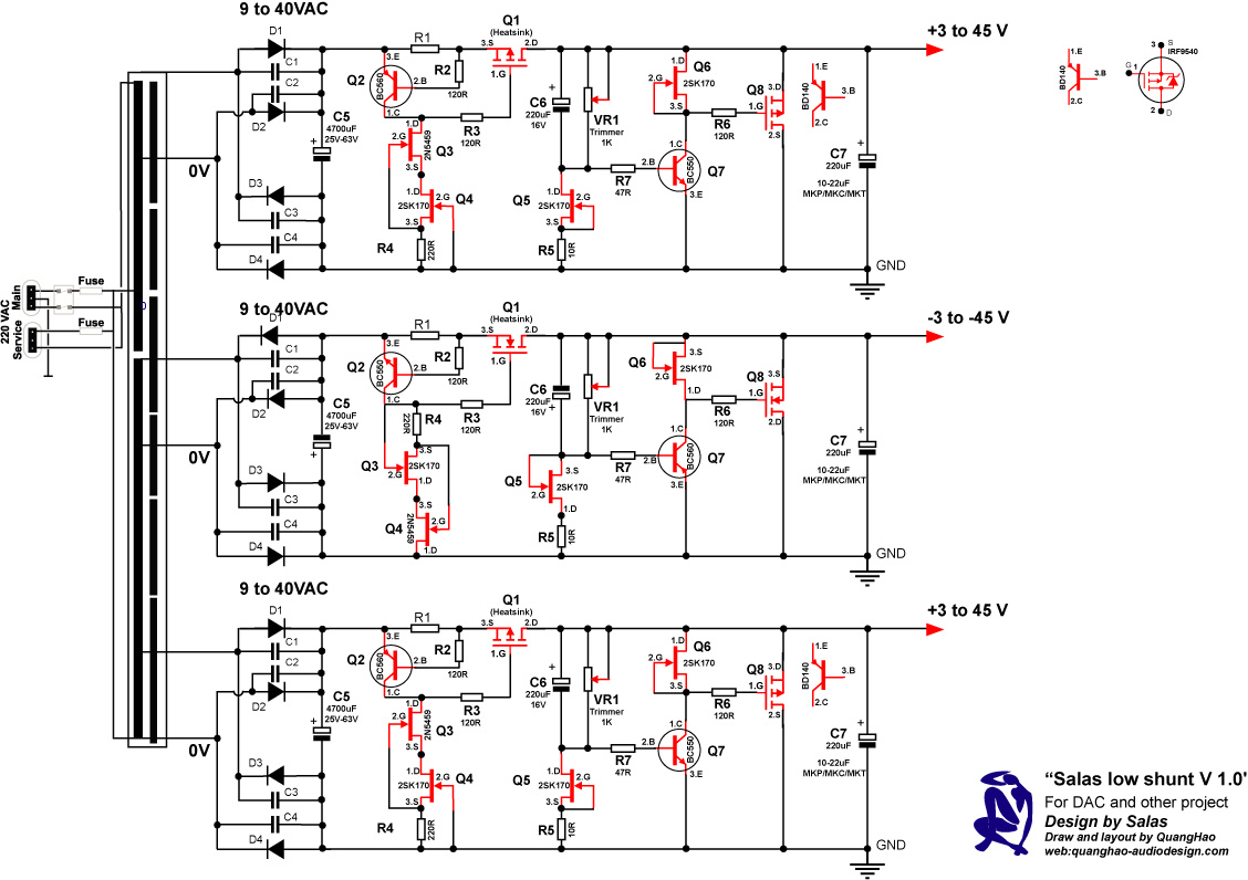

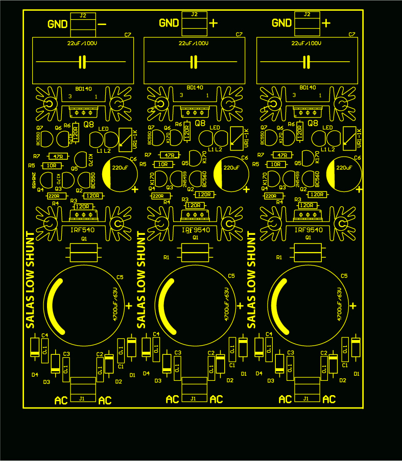

There are so many members want me to do this PCB. I find v1.0 very stable Salas low and very low noise. In this PCB you can use for projects ranging from 3 V to use 50v. with 3 outputs including 2 + and an early start - with a maximum response line 250-300ma! you can see by the pictures!

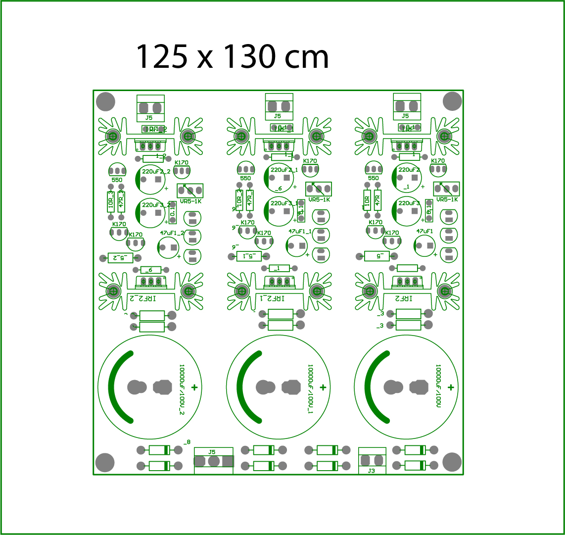

Hi all this is layout for Salas for DAC anf all project low voltage
Min 3 v- 40V.
In this PCB i use the new CCS of V1.2 of Salas, About Shunt i keep design V1., because i likes V1 , it is simple!
You can se circuit and layout!
Min 3 v- 40V.
@quanghao: do you sell a single rail CCS v1.2 PCB? I would need it for +12V output
Hi! you can use one PCB have 3 supply:
have three separate sources, and can separate them
2 x +
1 x -
check the pin out of Q8 in both the +ve regulators. Drain should be pin2, as the other mosFETs are labeled.

Quanghao,
You mention above that the individual sections of the PCB can be separated. The board design looks pretty tight at the junctions...perhaps you can add a dashed line to indicate the cut line for separating? Do you have a BOM list?
quanghao, any chance we'll see a V1.2 Salas shunt pcb/kit? 🙂
Yes! Now I test layout!
Quanghao,
Hi! thanks your advance!
Now im testing with Salas CCS v1.2 with Salas shunt V1.
When it have good the layout out, i can open it again!

I don't know what you are mixing but If you will issue a full V1.2 to the general plug n' play public it will be a support nightmare, brace yourself.😀
No! i test about The V1.2 CCs with Bc560 and 2n5459, 2sk170
An shunt of V1.0 ( i like it)
If CCs V1.2 it work good with V1.0 Shunt, i can make it for diy!
What do you think it?
Thanks for advace!
Thanks for advace!
Well, its a faster CCS, positive to have, should be no problem if it will work in your layout as a hybrid with a proven V1 shunt part. Make sure its absolutely stable on scope and for enough practical real life tests. VR1 1K will never take it to tens of Volt out. Also your 5459s will be dead at 40V you aspire. Designate a 5k trimmer and 28V max in 22V max out spec.
