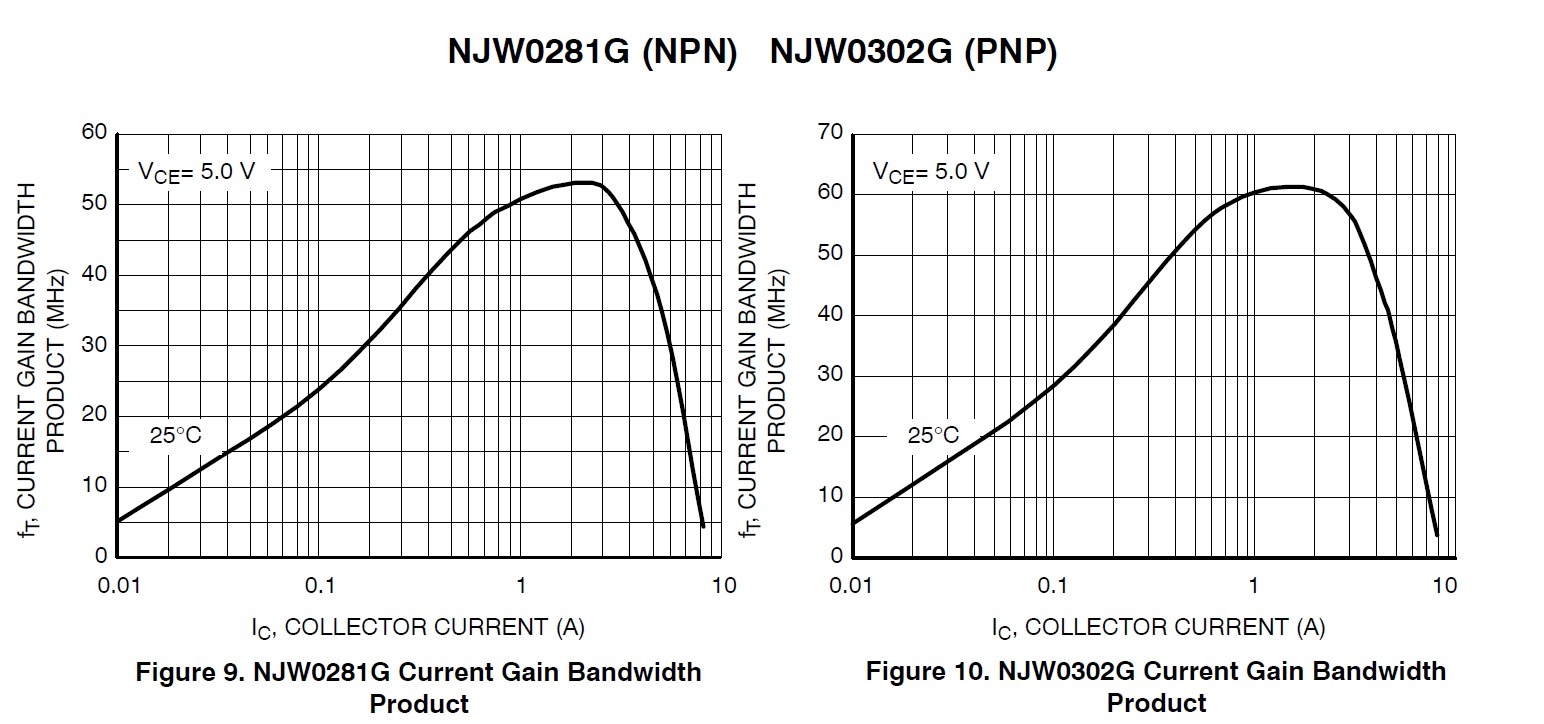

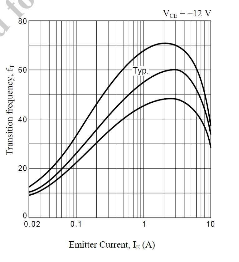

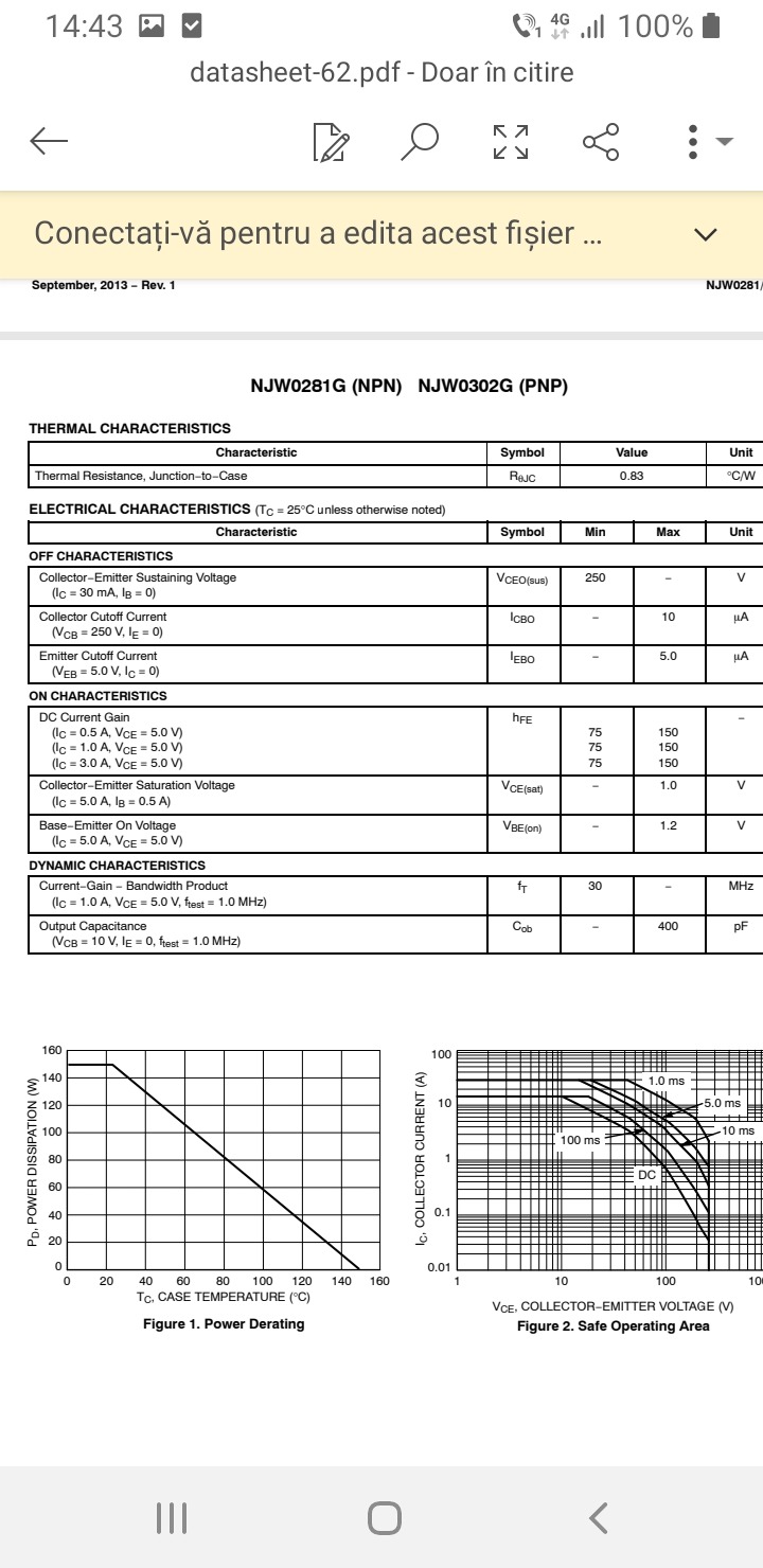

I can't stress enough how much i looked for these transistors even as second hand as they are and how sad the new datasheet makes me feel...I wonder ...what's better than these today?

6 times higher COB , two times lower FT... most probably 2sc2837 would be the perfect driver for 10 x MJL transistors in a 3EF output configuration. My preffered amp of all times had 2 x 200Mhz paralleled transistors driving 2x 2sc2837 ...I said that before...there was a point in time in the 90's where big FT transistors stopped being produced and kenwood had a last try with the quadrive system to get around the cob problem then simply moved all their high end line to Accuphase which settled on the diamond buffer and current feedback to overcome the crossover with low bias as it was immune to driving high cob , but if you want a simple schematic with good distortion figures at high power output transistors cob can only be overcome if we go back , way back in time to bootstraped drivers yet bootstrapped amplifiers have a nonlinear evolution of thd as bootstrap is not doing its job at low levels so you see 10 times higher distortions at 1watt then what a bootstrapped amp shows at 100watts...which is weird.3EF stages with low cob and high ft transistors can easily achieve unmeasurable thd below -120db at 1watt and below 0.001%thd at 100watts.

One measurement is done at 5v, the other at 12V...that means double the headroom at high frequency which is normal due to 4 times higher capacitance of the njw transistor, but that also means you need 4 times more current to drive them at just half the headroom and similar bandwidth...Not COOL 🙂
Lower Uce is worse condition. So NJW would be better with 12V Uce. Same for the Cob. It is easy to measure low Cob at 80V Uce...

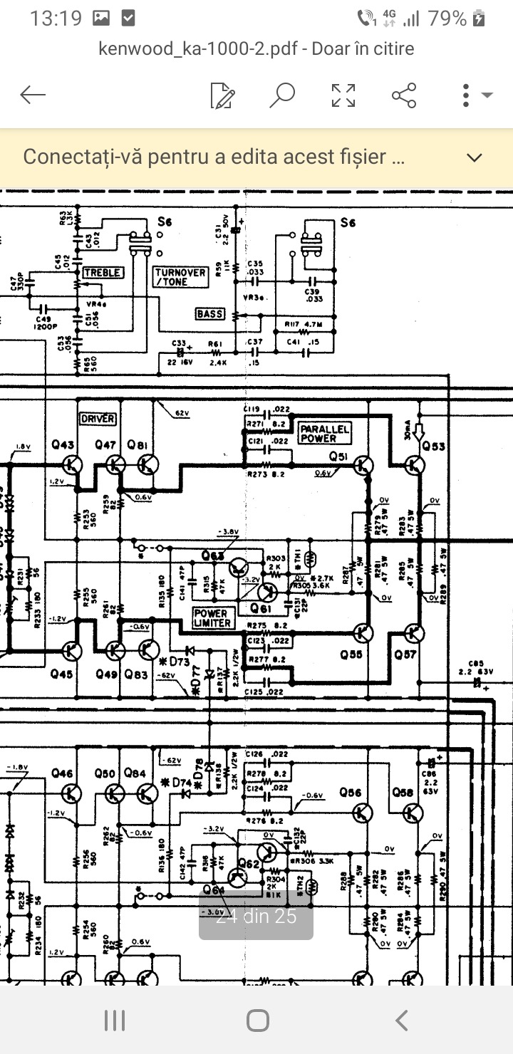

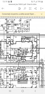

since dreamth threw it out there with that schematic snippet, is it just me or is it rather strange to put such a nice design (KA-1000) in a plastic chassis (!) and separate the power transformers from the amp in such a way?
it seems to be taking the desire for a "non-magnetic" chassis to an extreme at the expense of other design concerns ...

I talk about that amp anytime i can because I had it and I can only regret selling it.It was the best amp I ever heard.I never touched anything out of the L kensonic -kenwood series which was made by the same engineers and had the same philosophy, but at least I know one amp that was brilliant.It wasn't made out of plastic actually, the plastic and glass was on the faceplate,but the rest of it was just some light metal.Nonmagnetic chassis ment that the transformers were not inside the amp and the main reason for that was to not interfere with the sigma drive circuit at low frequencies.

@dreamth, be carefully with this tricky amp. there are transis on Board But Not on the Diagramm!!!
Unsolder all semiconductors to measure them. Work for slaves but otherway there might a
Bad surprise on switchon. Arnd dont forget the Board on the backside with the speakerterminals
As there is a saftycircuit.
Good luck
