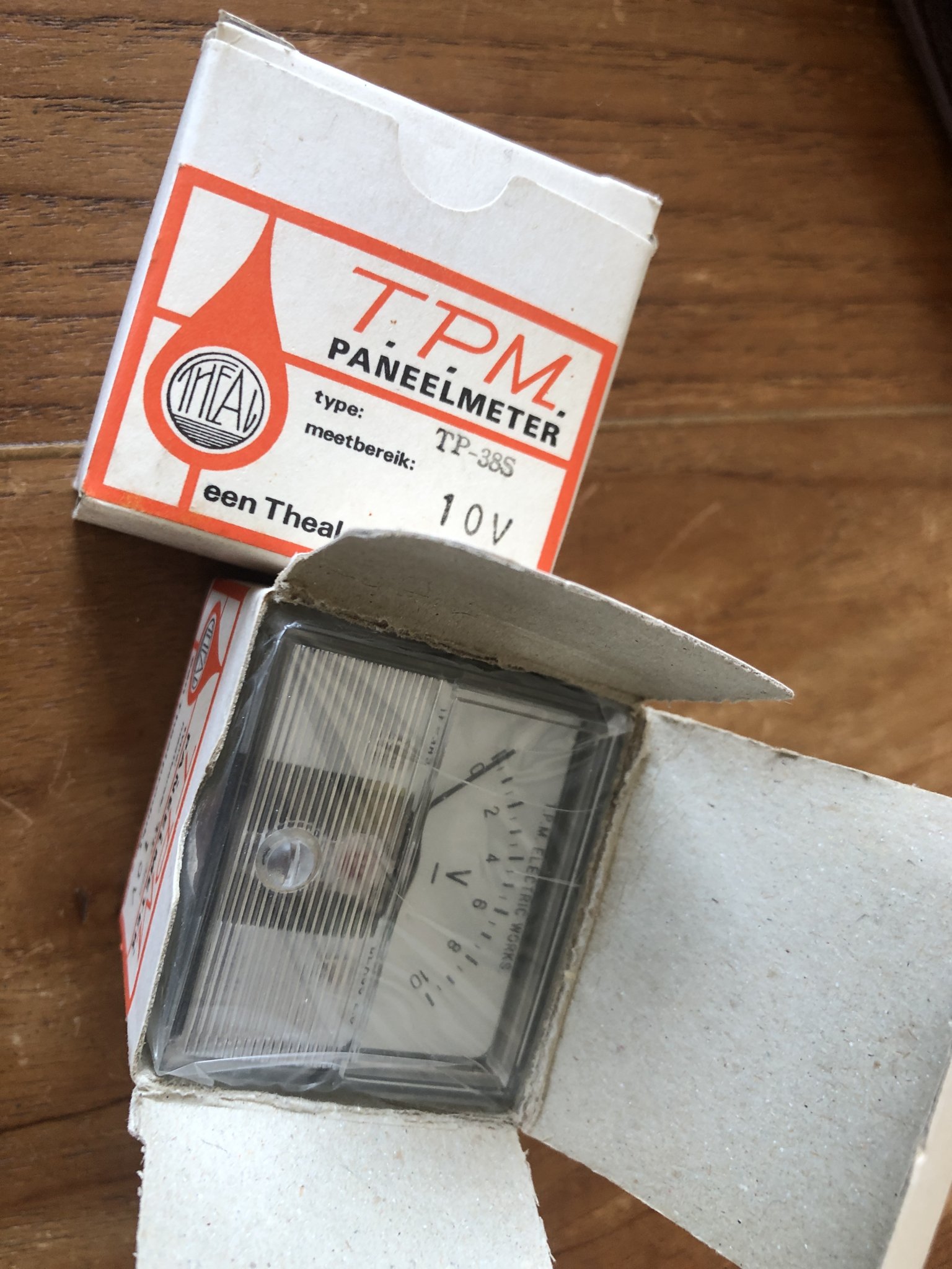

Just looked but the small ones I have in pairs for low voltage are 10V made by TPM, type TP-38S. A pair, plastic covers.
There are WW II meters and cold war stuff but all larger. Size and pairs are indeed keywords.

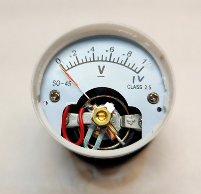

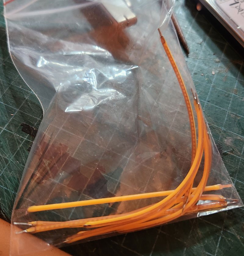

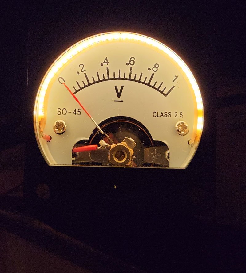

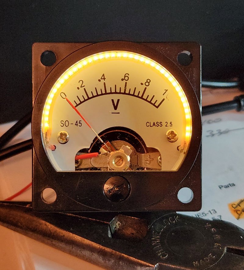

Well, I did get my meters in and to answer the silly question I posed originally, the mounting hole required is 45mm round. I guess that's why they call them SQ-45 🙂. On a side note, I attempted to illuminate one of these cheap meters and am still debating whether it was a success or not. I like it but wonder if the C.O.B filament I used was a bit too long. The following images are in normal room light and in darkness feeding it roughly 2.5 volts. If anyone is curious about the filaments, they are 80mm C.O.B. bought at AliExpress. 10 pieces for $8.00 Can. shipping included. COB Filaments . The SQ-45 volt meters are also from across the pond. 4 of them was about $22.00 Can. shipped SQ-45.

Can you share a little more about how you did your modification?

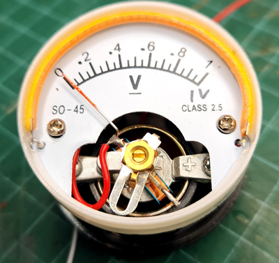

Happy to 🙂 This is probably more than is needed but I would have appreciated seeing how easy it is to do.
1. Attach some leads to the COB filament at a 90 degree angle to the connection points. Just for reference, the end with a tiny hole through it is '+'

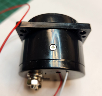

2. Pop open the meter by removing the 2 small Phillips screws at either side of the meter

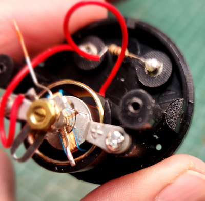

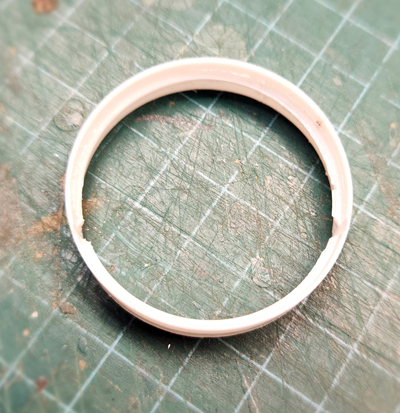

3. When the housing is removed, you'll be left with the internals with a cheap white plastic shroud that needs to be popped off. It's easy and a bit of pressure will do it.

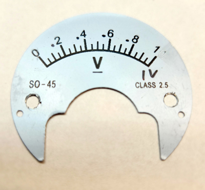

I approximated where the filament would lie and filed 2 small grooves to make space for the filament connections to be pressed in close

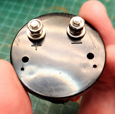

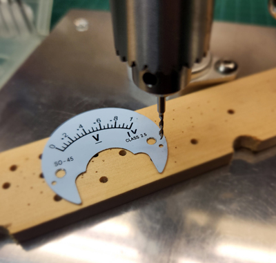

4. If you look around where I drilled my 2 holes in the face plate, you will see there is space to pass a wire through all the way to the back . Mark where your holes will be drilled and pop the 2 holding screws out. Drill out the faceplate holes but make sure it's supported as these things are flimsy. At the same time make your exit holes in the back of the meter. There's tons of space back there to add a resistor to dim your filament. There is an existing resistor back there for the meter. If you look close at the faceplate you can tell they used the same meter for various renditions and hand painted decimals and the 1 V at the end of the scale. A wee bit of whiteout there too 🙂
5. Feed your filament leads down through the holes and bring them out the back. Twisting the leads gently between your fingers will move the filament so that it fits almost perfectly in place. I used medium viscosity cyanoacrylate with a small feeding tube to run a bead around the outside edge and the shroud (cowl?). Press the connection points in tight as well right around where the grooves were filed. Plastics and crazy glue hate each other at the best of times. Perhaps there is a better adhesive to use. Before you put it back together, use a soft paint brush or air or whatever to blow out the residual crud from drilling. I had mine back together and inevitably some crap was floating around inside still. Let it sit for a bit and put it back together. I sent the stupid adjustment screw flying a few times as it's just pressure fit. That's it...we're done. Now if someone can point me in the right direction as to where to hook these up in Pete Millet's Engineers Amp 🙂
