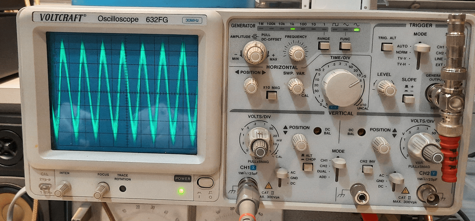

Do they seriously ship this with an oscillating regulator? What is the root cause for oscillation and how to fix it?First hint...solve oscillation on TVDD 3,3v regulator on left lower side of ak4499.

Both dacs have same result on TVDD pin. This was for me unacceptable before going on with any other mod. I did some dacs with ak4490, ak4495, measured also ak4497modified toping and dx3pro ak4493 and noone had such oscillation. 10uf 1206smd x5r before and after regulator solve the problem. Because 90% of the dac is supplied from very noisy switching regulator. At loxije i put one FB before 10uf to damp a little bit switching noise, not in smsl because there was changed to tps7a4700. Switching regulators are not bad in proper places but in this dac it is no place for such a regulator.
