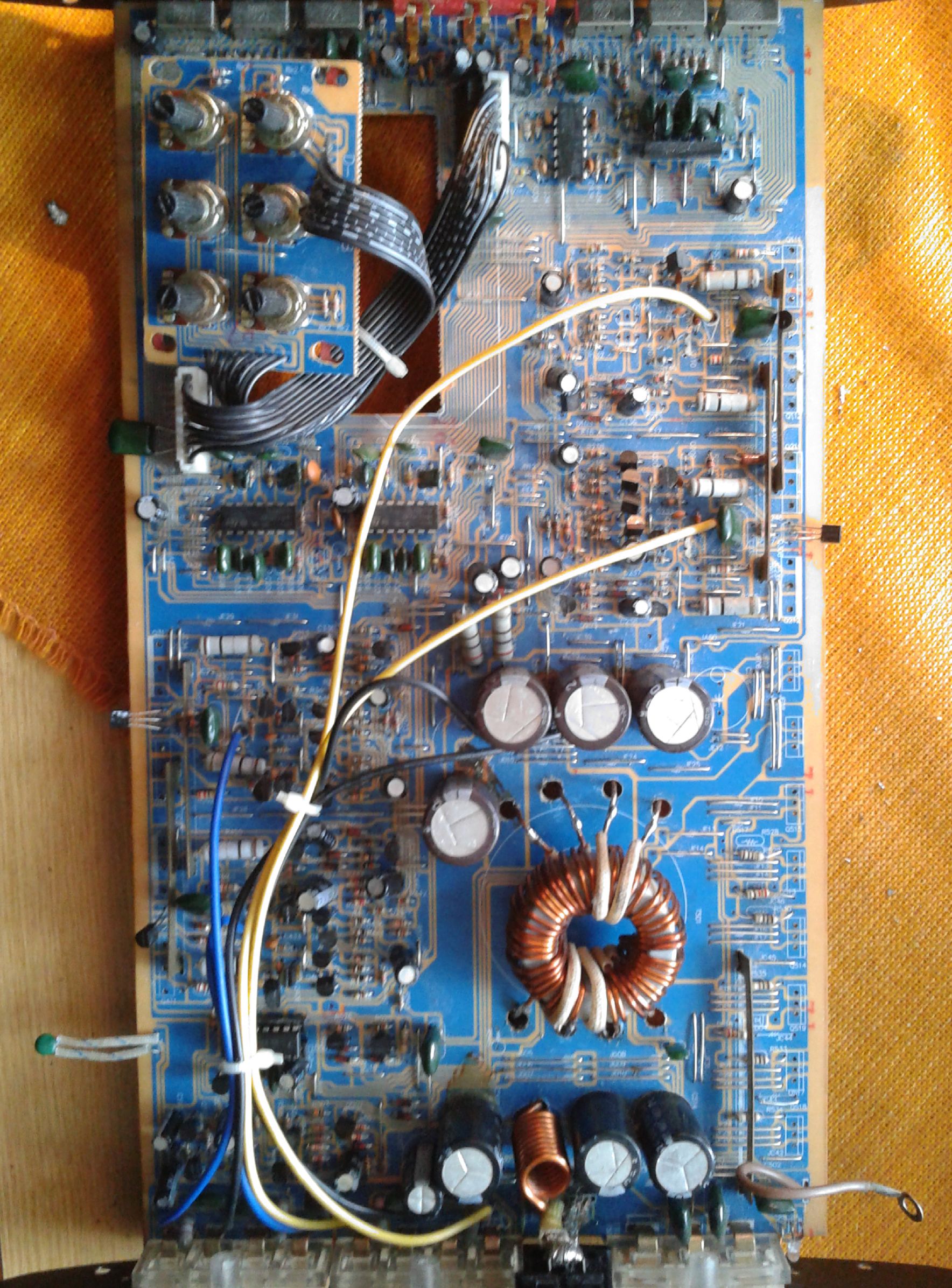

I have this Chinese amp with PS problems. As soon as the power is applied, the amp starts drawing too much current. The LED is flashing red and green. I have tried to fix it myself, but without any success. I have removed the rectifiers and mosfets, disconnected the secondary winding of the transformer, but the issue is still there. Soldered a socket for the 494 chip and replaced it with another one, but nothing. When the chip is out, the LED is green. So, it must be related to the drive circuit. I get intermittent 22kHz at the gate of the mosfets. When I install the mosfets, they instantly get hot. Could it be because the signal driving them is too wide? Do you have any ideas what to check? Thanks.

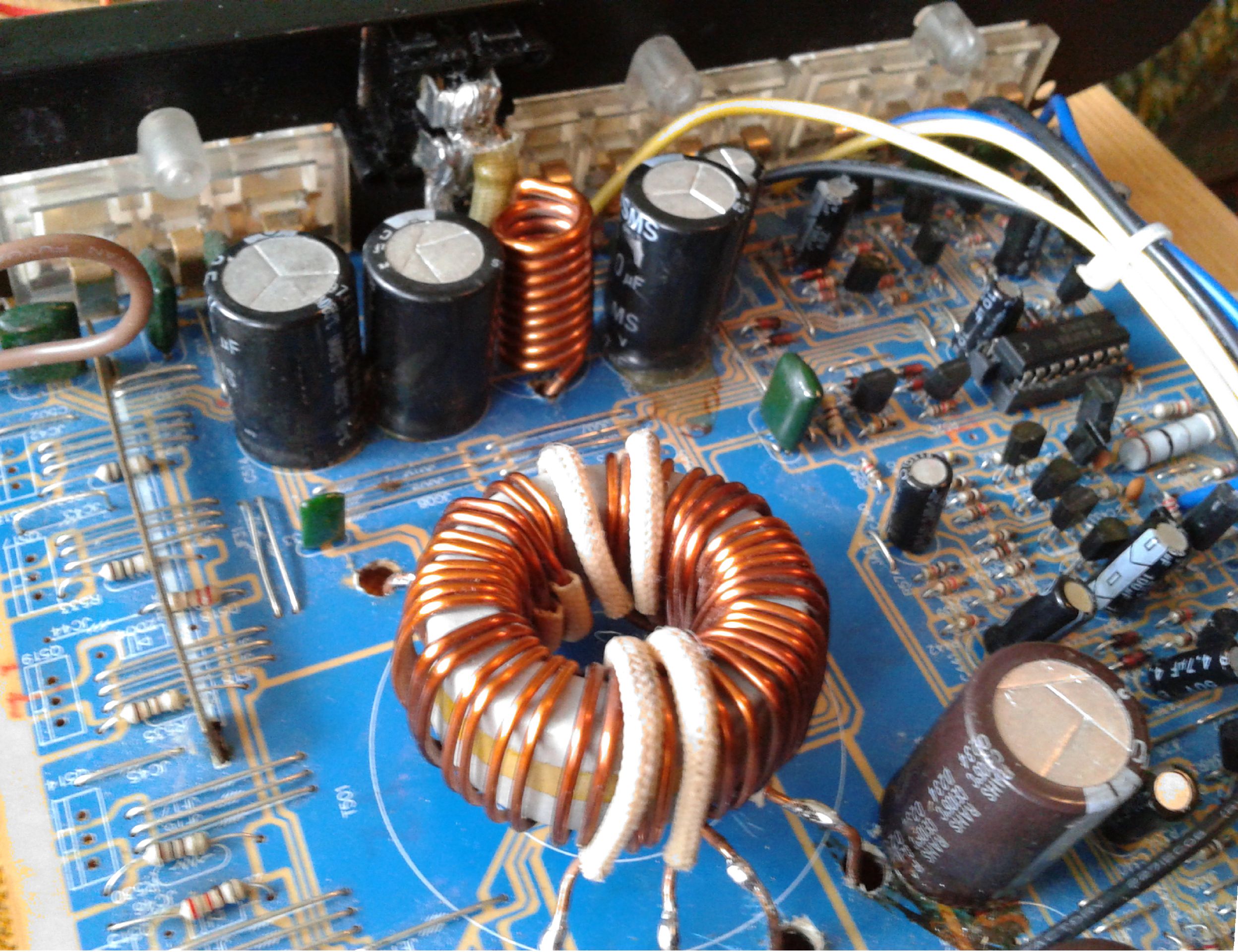

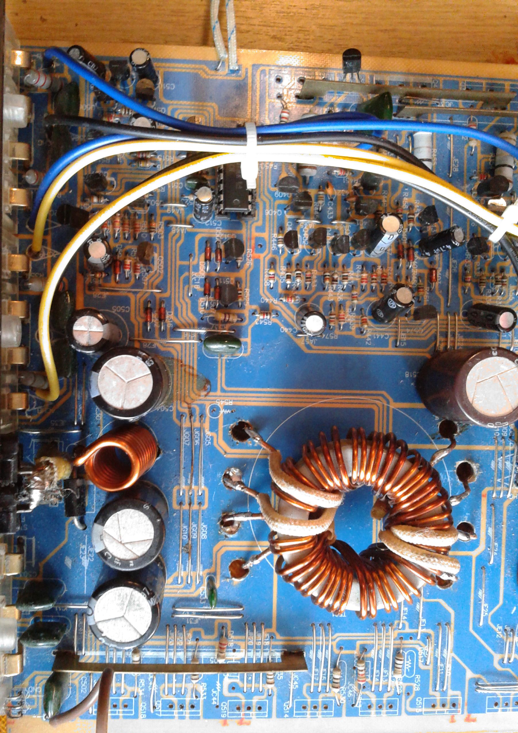

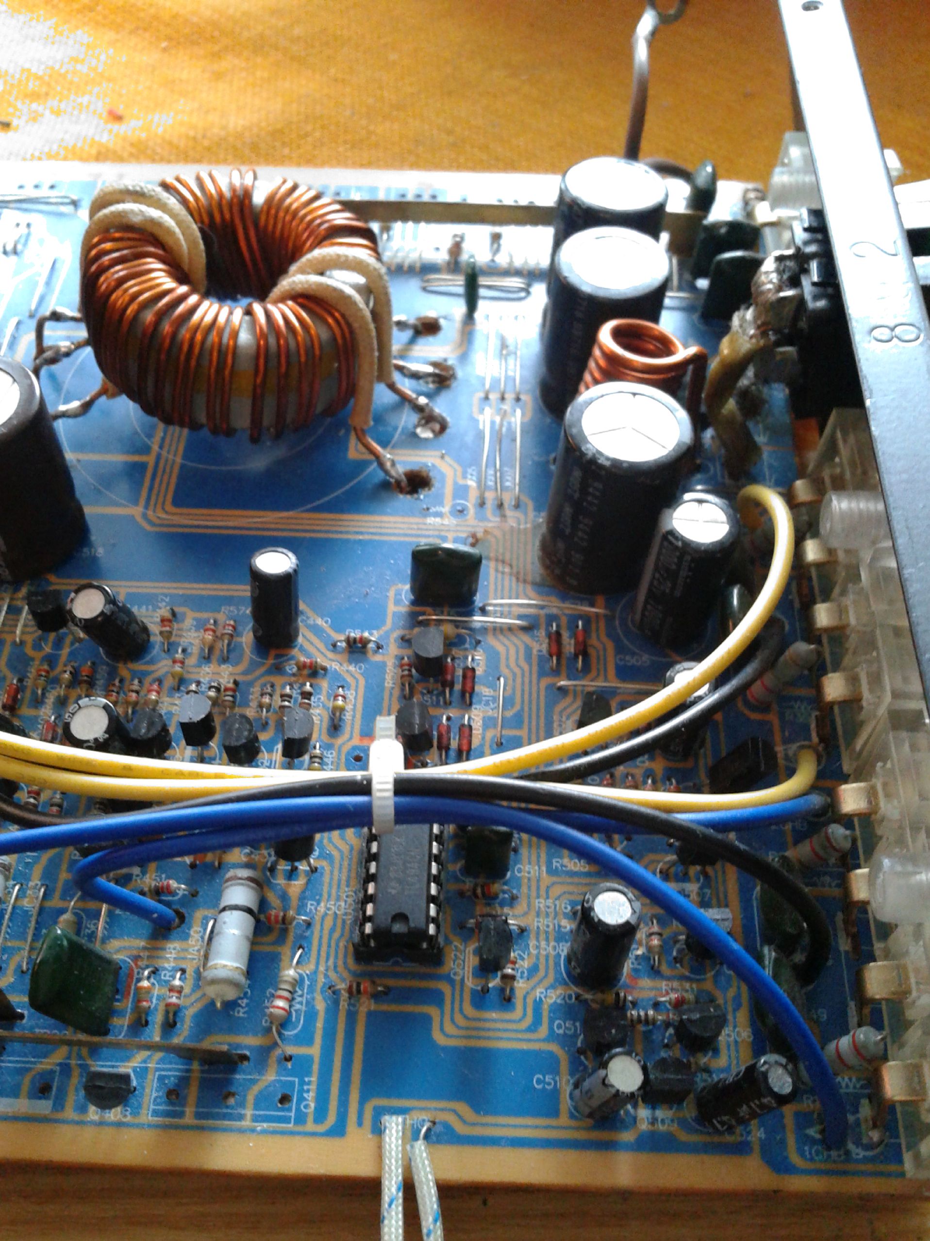

It's been a while since I last worked on this amp, and I wrote the opening post from my memory. It's one of the tough cases I haven't been able so sort out. I installed one mosfet at each PS bank, but nothing happens. Currently, the primary winding of the transformer is connected, two PS mosfets, and 494 that is supposed to be driving them. The rectifiers and output transistors are not in circuit. The gate pad of the mosfets is pulsing between 0.1 and 0.4V. Does this suggest that the drive or protection circuit is not working properly?

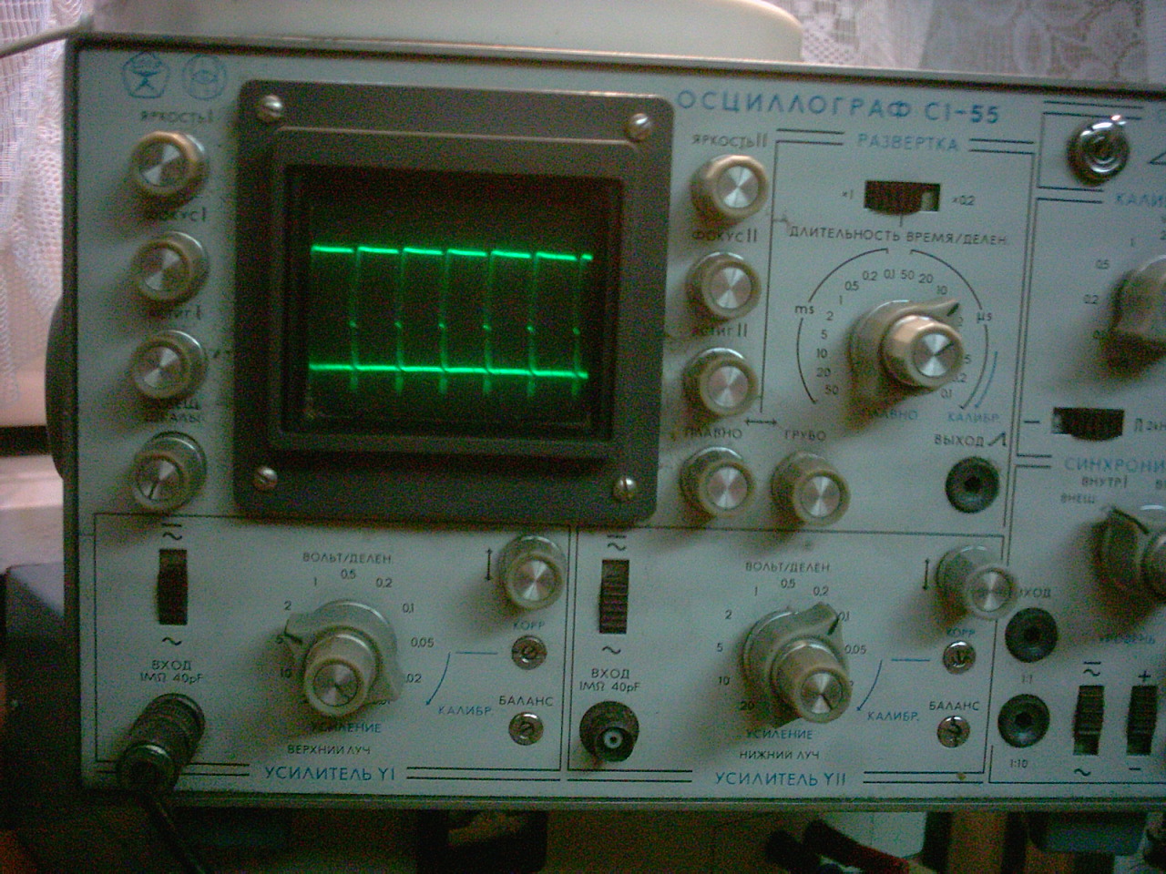

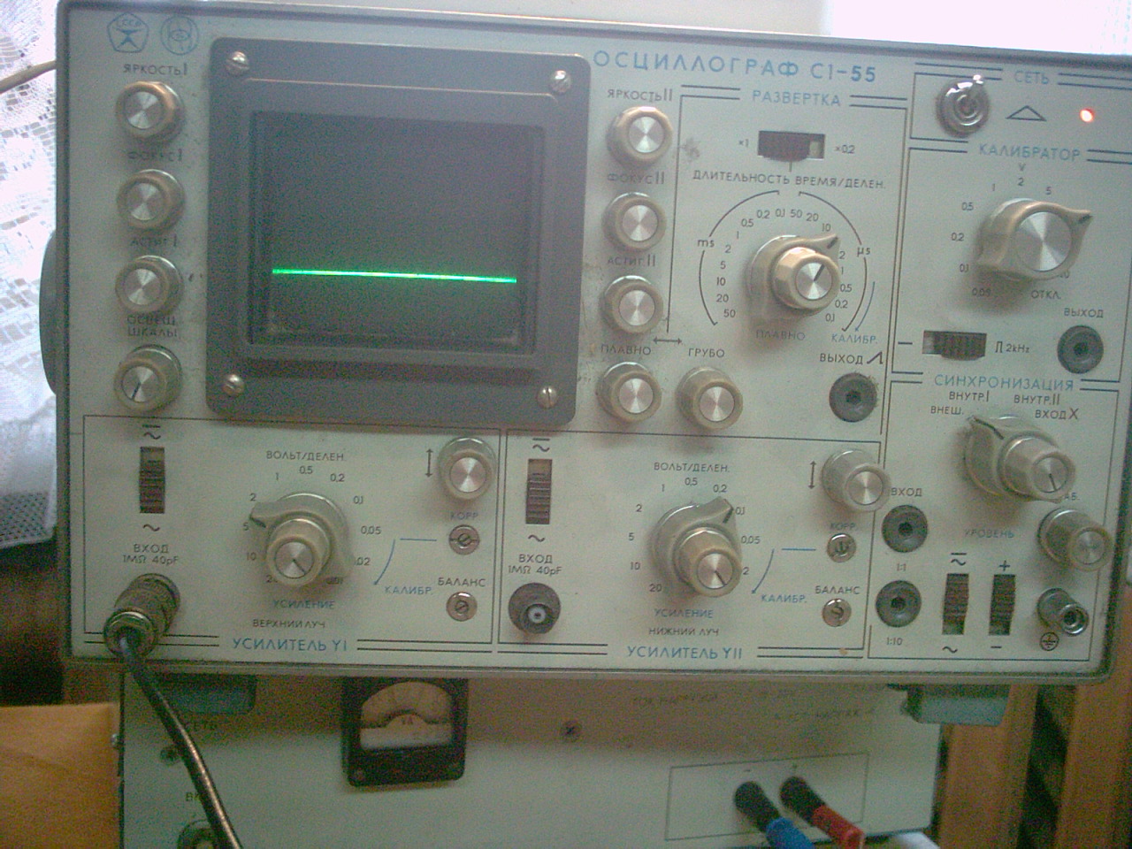

It's an old Russian scope. If you tell me what settings to use, I can try to use it, but the waveform isn't going to be pretty. Also, my multimeter can measure frequency.
For the gate waveform, use 10uS and 5v/div.
You should read the oscilloscope page of the car audio site, pay close attention to information in the section "Best Initial Settings".

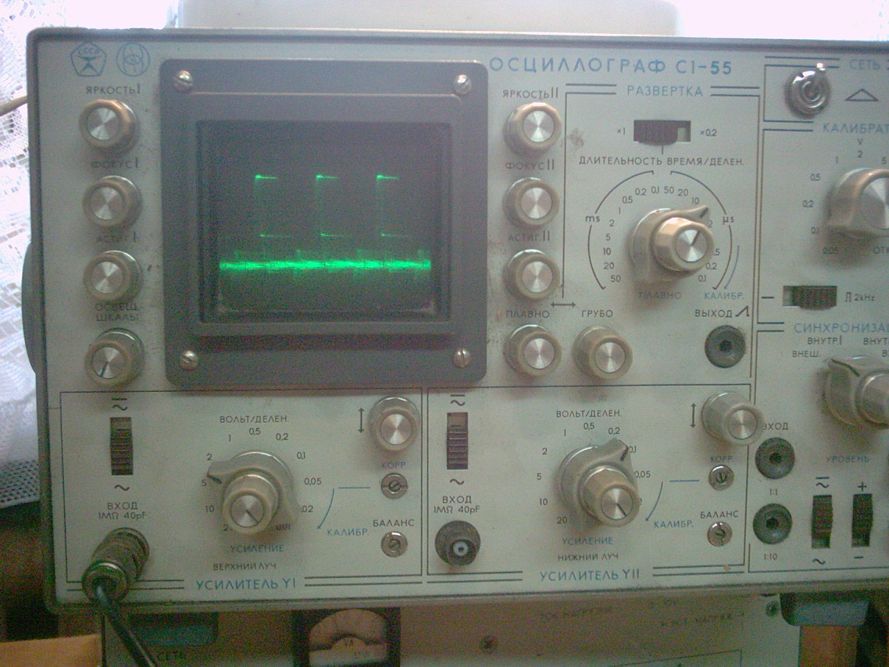

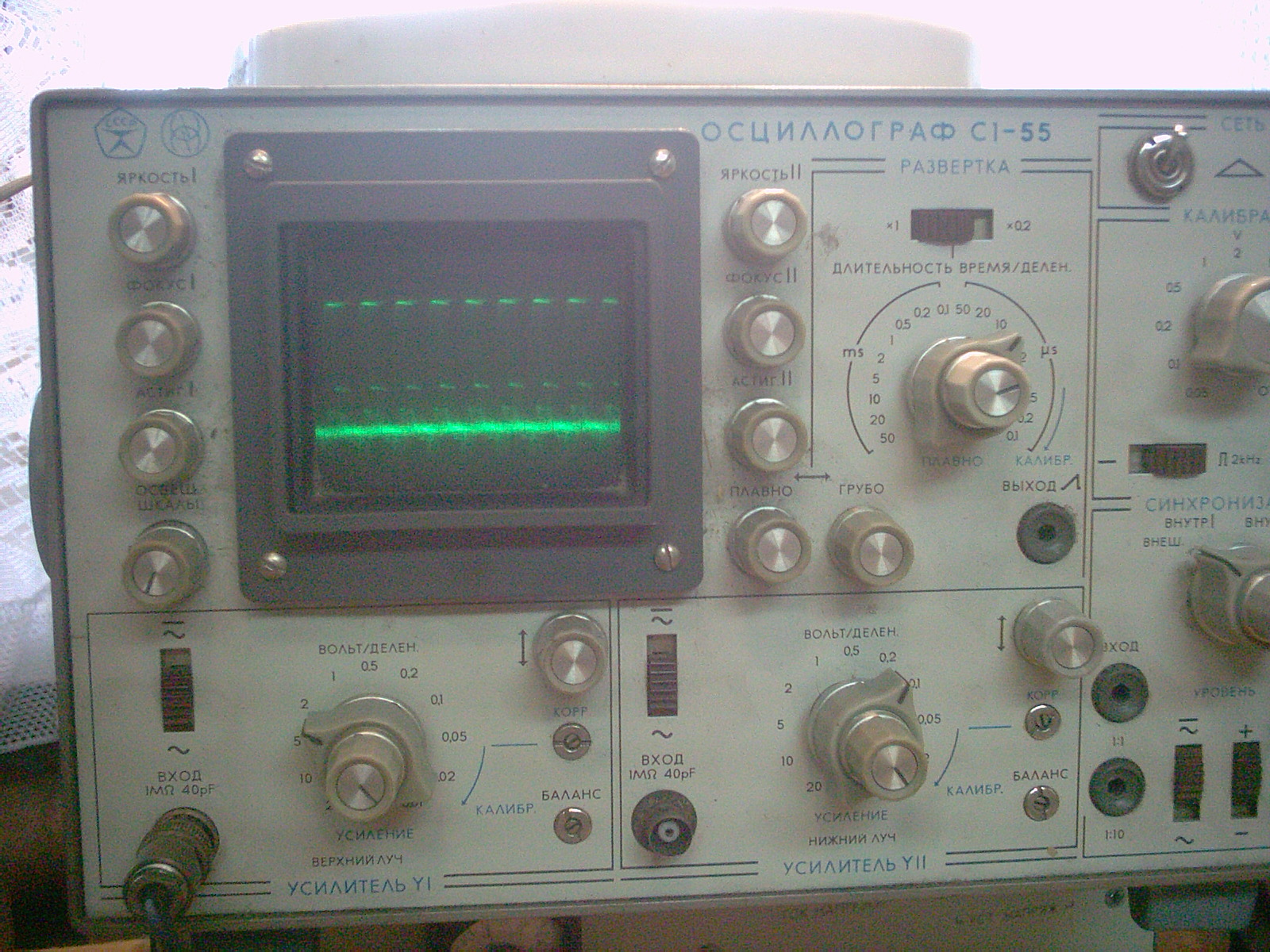

The waveform below is the mosfet drive signal pulsing. Sorry about the bad quality of the pics. I used 2V/div instead of 5V, because the amplitude wasn't enough and it was too difficult to see anything. Doesn't appear like a proper square wave to me.
It appears that the pulse width is changing rapidly. Which of the pins of the driver IC have DC voltage that's not constant?

Lift pin 4 from the socket and connect it to pin 7 of the IC. Does that make the voltages more steady?
Lifted the pin 4 from the socket and shorted it to pin 7 of the IC. The protection LED was still pulsing, but now the amp started drawing current and the mosfets got warm.
The IC cannot operate with pin 14 at 0v. Re-check the readings. If it's still 0v (or well below 5v), find what's dragging it down.
