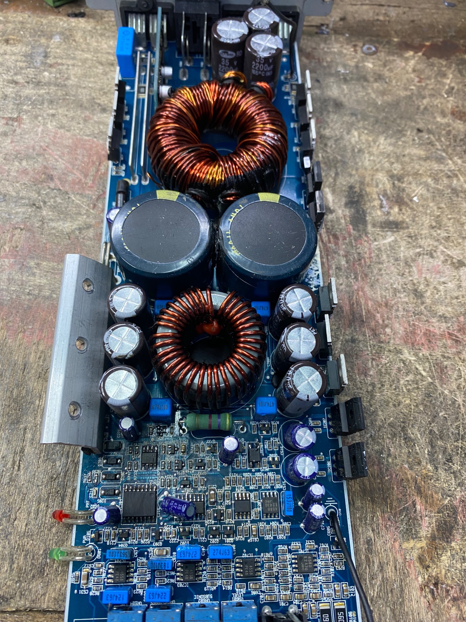

The rail voltage in this amp is not stable.When I used the amp to drive a load one rail will goes high and the other goes down slightly.Rail cap rated 75 v.The rail voltage goes as high as 71v.
Any suggestions?

Precisely, what is normal ±rail voltage?
What is the DCV on the positive rail when there is a change in rail voltage?
What is the DCV on the negative rail when there is a change in rail voltage?
Use the secondary ground as the reference (black probe) when measuring those points.
Are you using the secondary ground as the reference point?
I've never seen this happen on this type of amplifier but when it has, it's happened when one half of the FET drive circuit was damaged, allowing the inductor to act a bit like a flyback transformer/inductor.
To check drive, you may need to go to differential mode if you have a mains powered scope. If you have a battery powered scope with no connection to the mains supply, you can check the drive directly across the gate and drain for the output FETs.

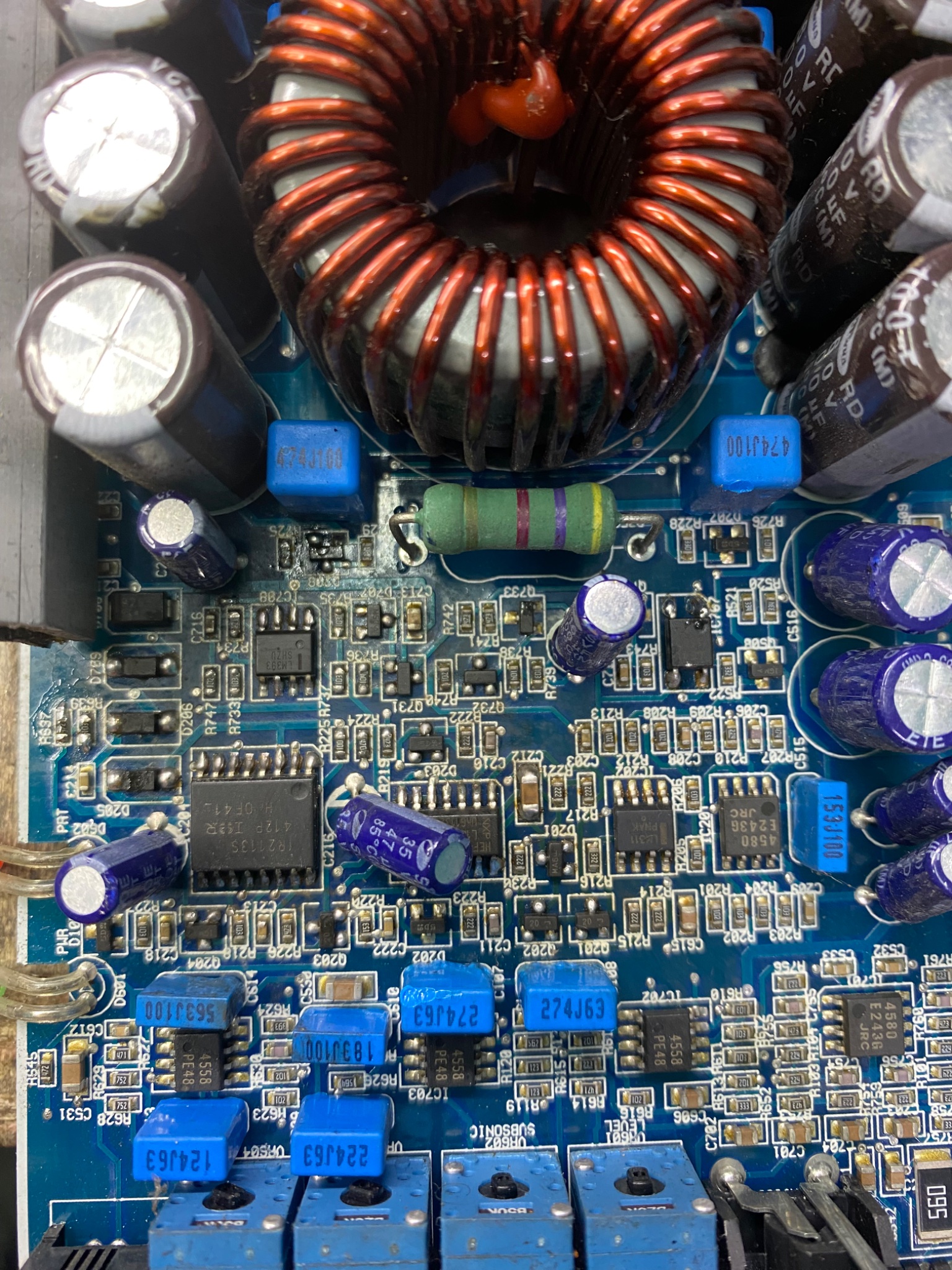

Yes 3525
Pin 1: 0.000
Pin 2: 5.18
Pin 3: 0.017
Pin 4: 0.414
Pin 5: 2.057
Pin 6: 3.743
Pin 7: 2.004
Pin 8: 0.331
Pin 9: 5.73
Pin 10: 0.052
Pin 11: 0.006
Pin 12: 0.000
Pin 13: 9.70/10.3
Pin 14: 0.007
Pin 15: 9.70/10.3
Pin 16: 5.18
Lm393
Pin 1: 1.180
Pin 2: 0.225
Pin 3: 2.568
Pin 4: 0.000
Pin 5: 0.004
Pin 6: 2.568
Pin 7: 0.262
Pin 8: 5.18
