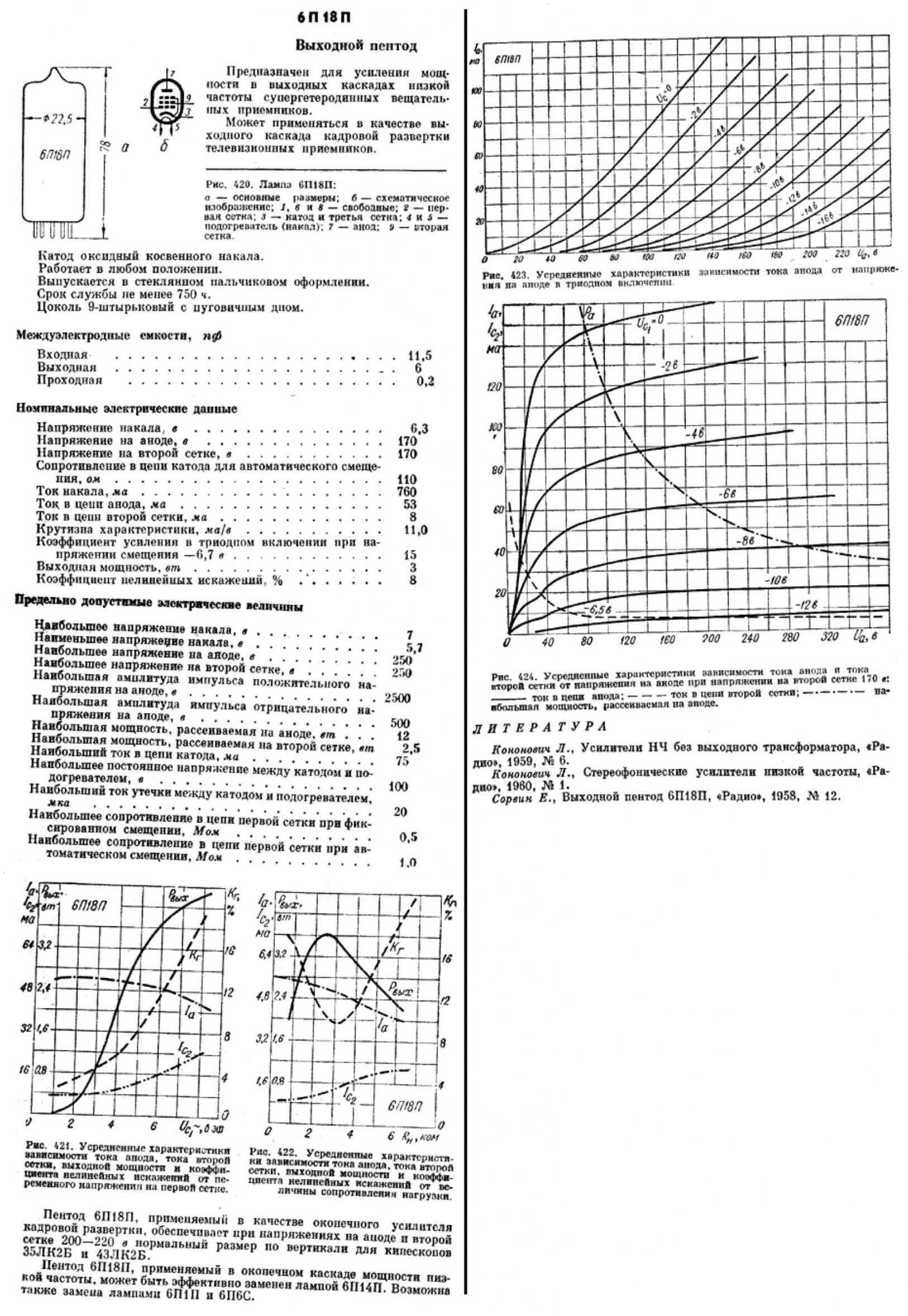

There are data sheets for both, if that helps.
6P18P - https://frank.pocnet.net/sheets/113/6/6P18P.pdf
Pa = 12W max
Pg2 = 2.5W max
Va and Vg2 = 250V max
gm = 11mA/V
ra = 22k ohms

Yep, those two look pretty close!

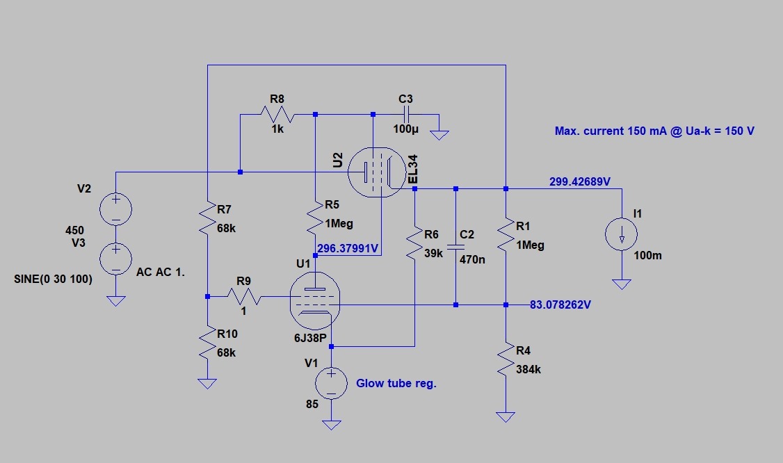

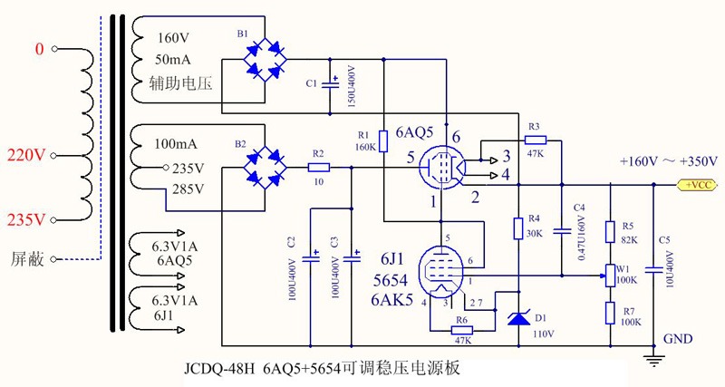

If you want to build tube regulator with 6p18p, I believe these schematics will work:
https://www.aliexpress.com/item/1005001270184823.html
https://www.angelfire.com/planet/funwithtransistors/images/FIG-3-19.gif
https://www.angelfire.com/planet/funwithtransistors/Book_CHAP-3.html

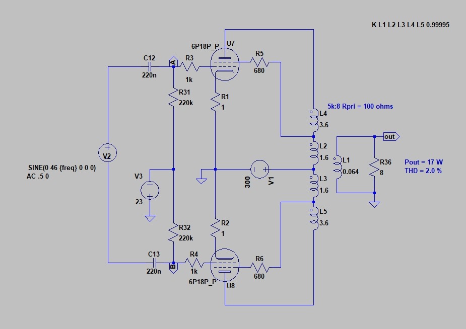

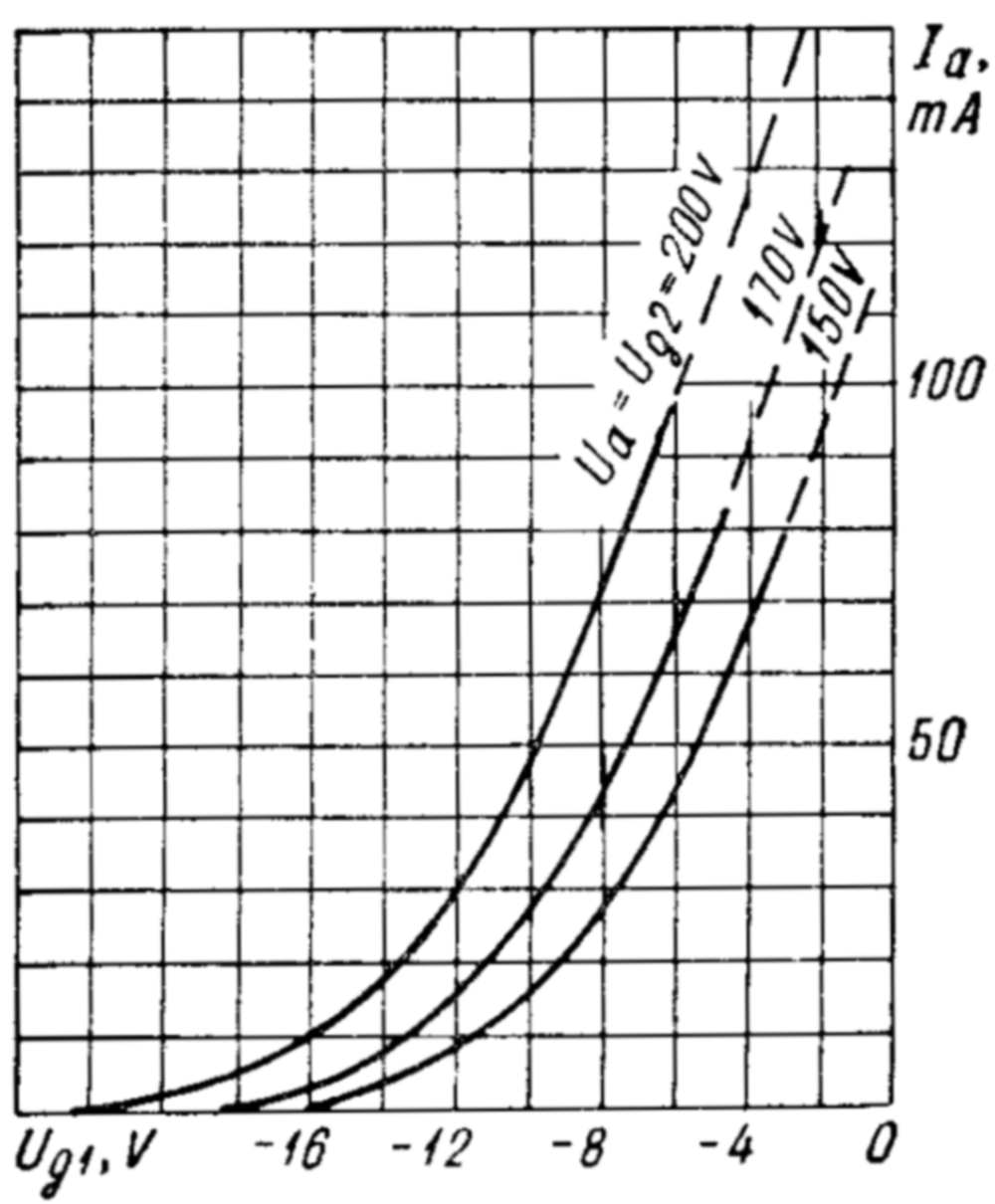

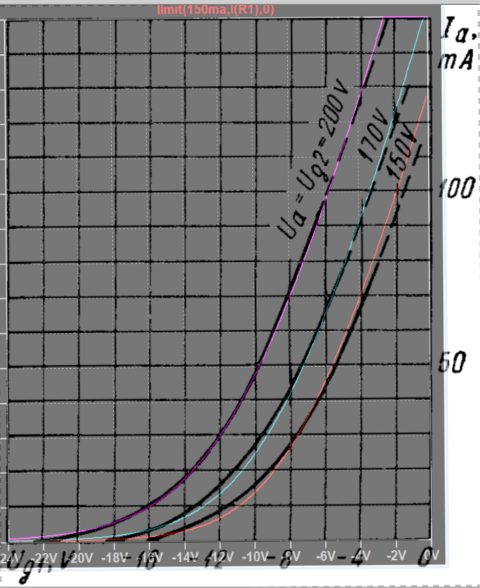

Anyone want to share the model for 6p18p for comparing? Here is my model:

Here.I'm especially interested in a possible implementation in stabilized HT PS circuits.
Code:**** 6PI18PI ****************************************** * Created on 10/13/2022 14:26 using paint_kip.jar * www.dmitrynizh.com/tubeparams_image.htm * Plate Curves image file: 6pi18pi.png * Data source link: <plate curves URL> *---------------------------------------------------------------------------------- .SUBCKT 19 P G2 G K ; LTSpice tetrode.asy pinout * .SUBCKT 6PI18PI P G K G2 ; Koren Pentode Pspice pinout + PARAMS: MU=15.3 KG1=86.39 KP=76.97 KVB=7224.13 VCT=-5.051 EX=0.792 KG2=281.36 KNEE=17.58 KVC=1.571 + KLAM=1.92E-6 KLAMG=2.795E-5 KNEE2=5.398 KNEX=0.01886 KNK=0.000937 KNG=1.037E-4 KNPL=2.938 KNSL=0.2338 KNPR=24 KNSR=232 + CCG=3P CGP=1.4P CCP=1.9P VGOFF=-0.6 IGA=0.001 IGB=0.3 IGC=8 IGEX=2 * Vp_MAX=320 Ip_MAX=160 Vg_step=4 Vg_start=0 Vg_count=9 * X_MIN=53 Y_MIN=14 X_SIZE=628 Y_SIZE=644 FSZ_X=1296 FSZ_Y=736 XYGrid=true * Rp=1400 Vg_ac=20 P_max=12 Vg_qui=-16 Vp_qui=300 * showLoadLine=n showIp=y isDHP=n isPP=n isAsymPP=n isUL=n showDissipLimit=y * showIg1=y isInputSnapped=y addLocalNFB=n * XYProjections=n harmonicPlot=y dissipPlot=n * UL=0.43 EG2=170 gridLevel2=y addKink=y isTanhKnee=y advSigmoid=n *---------------------------------------------------------------------------------- RE1 7 0 1G ; DUMMY SO NODE 7 HAS 2 CONNECTIONS E1 7 0 VALUE= ; E1 BREAKS UP LONG EQUATION FOR G1. +{V(G2,K)/KP*LOG(1+EXP((1/MU+(VCT+V(G,K))/SQRT(KVB+V(G2,K)*V(G2,K)))*KP))} RE2 6 0 1G ; DUMMY SO NODE 6 HAS 2 CONNECTIONS E2 6 0 VALUE={(PWR(V(7),EX)+PWRS(V(7),EX))} ; Kg1 times KIT current RE21 21 0 1 E21 21 0 VALUE={V(6)/KG1*ATAN((V(P,K)+KNEX)/KNEE)*TANH(V(P,K)/KNEE2)} ; Ip with knee but no slope and no kink RE22 22 0 1 ; E22: kink curr deviation for plate E22 22 0 VALUE={V(21)*LIMIT(KNK-V(G,K)*KNG,0,0.3)*(-ATAN((V(P,K)-KNPL)/KNSL)+ATAN((V(P,K)-KNPR)/KNSR))} G1 P K VALUE={V(21)*(1+KLAMG*V(P,K))+KLAM*V(P,K) + V(22)} * Alexander Gurskii screen current, see audioXpress 2/2011, with slope and kink added RE43 43 K 1G ; Dummy E43 43 G2 VALUE={0} ; Dummy G2 43 K VALUE={V(6)/KG2*(KVC-ATAN((V(P,K)+KNEX)/KNEE)*TANH(V(P,K)/KNEE2))/(1+KLAMG*V(P,K))-V(22)} RCP P K 1G ; FOR CONVERGENCE C1 K G {CCG} ; CATHODE-GRID 1 C2 G P {CGP} ; GRID 1-PLATE C3 K P {CCP} ; CATHODE-PLATE RE23 G 0 1G GG G K VALUE={(IGA+IGB/(IGC+V(P,K)))*(MU/KG1)* +(PWR(V(G,K)-VGOFF,IGEX)+PWRS(V(G,K)-VGOFF,IGEX))} .ENDS *$
Hey Koonw, thank you for this.
Unfortunately, I'm getting errors running the 6PI18PI model. I must be doing something wrong.
Here's the .asy symbol file I'm using to place the above into LTspice. Can you see a mistake in there?
(Sorry to go off-topic this way...)
