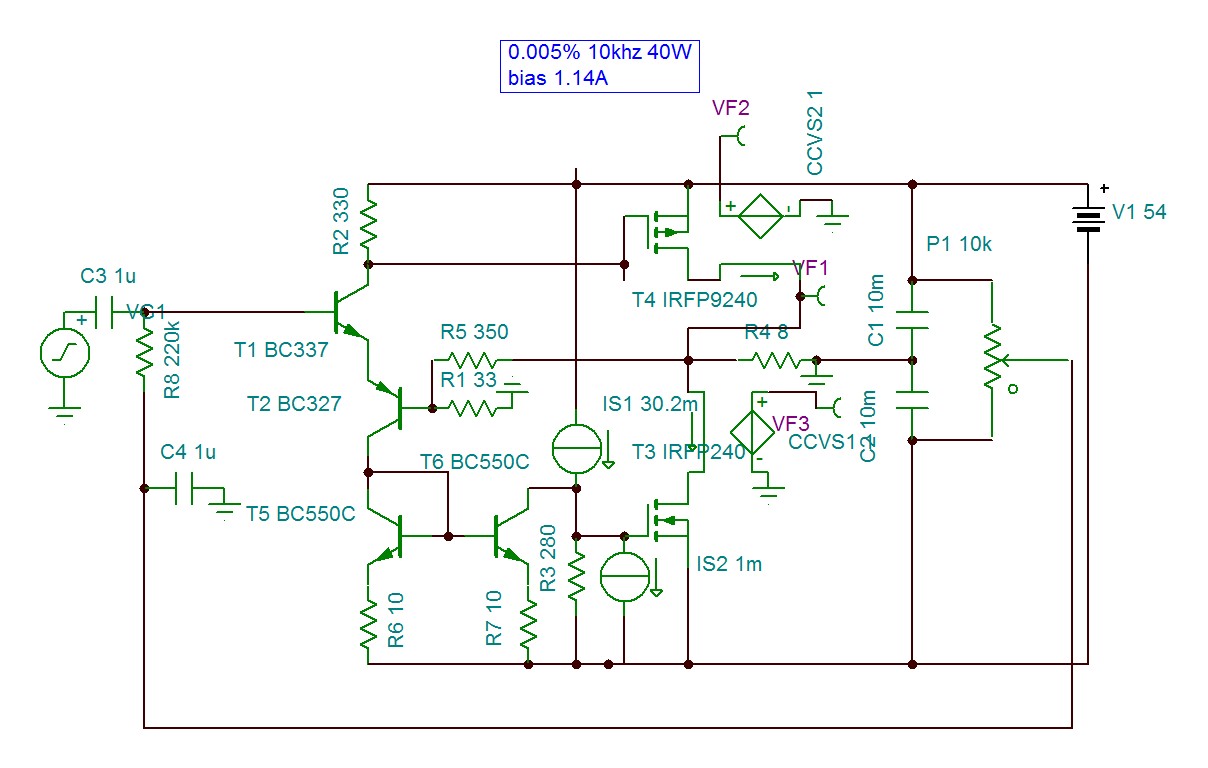

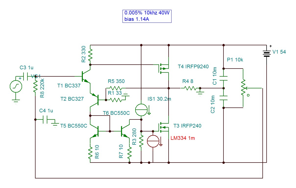

I am experimenting to transform the single front-end into push pull. I came upon this type of circuit. Note that the power mosfets can be VAS stage. The lower current of the Rush is inverted by current mirror subtracting a fixed CCS which adjusts the bias current 1.48A. As the same current of the rush subtracts itself , the distortion goes very low 0.0002% @1khz 1W , in worst case 0.09% @10khz 40W. The power mosfets work in square law bias they are thermally stabilized by LM334 mounted upon . This circuit is designed in less than an hour, To morrow , I 'll post with Single Floating Supply to take care of the offset.

Hi kokoriantz,Better adjusted , it can deliver 40W 10khz with 0.005% Dtot. Thanks to square law , with 1.14A bias it is still in class A at 40W.

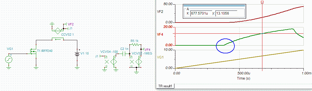

Be aware the TINA IRFP240 does not have subthreshold conduction. See plots:
You get lower distortion from simulations without subthreshold conduction compared to real MOSFETs.

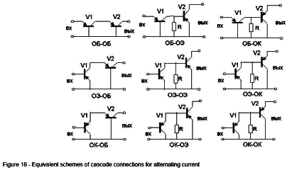

Cascode inclusion of transistors-circuits in which individual transistor cascades are connected in a chain without additional feedbacks. Such compounds are called regular.
Circuits in which individual transistors are connected in an arbitrary combination and with additional feedbacks. Such compounds are called irregular.
6 Каскодное включение транзисторов
These include the Rush circuit, the Sugden output stage circuit.
Some cascode schemes compensate for temperature drift and are used in DC amplifiers.

Hi OldDIY,Cascode inclusion of transistors-circuits in which individual transistor cascades are connected in a chain without additional feedbacks. Such compounds are called regular.
In that reference for classification of compound pairs:
The regular cascode is mid-left (without the DC bias).
The LTP differential pair bottom left (without the CCS for DC bias).
But where is the Rush pair (with two emitters connected and PNP+NPN)?
The regular cascode is sometimes called a telescopic stage (meaning one on top of the other) in the literature.
The Rush pair doesn't fit into this category because the two emitters are holding hands they effectively act together a single device, they forms a discrete 4 terminal NPNPNP transistor with two bases and two collectors.
No emitters, so the base currents flows in one base and out the other base (well assuming matching).
It is similar to the LTP diff amp, except the Rush pair has two Vbe DC bias drop between the bases.
The LTP has an Io*Tanh([Vin1-Vin2]/[2*Vt]) transfer function.
The Rush pair has a Io*exp([Vin1-Vin2-2Vbe]/[2*Vt]) transfer function like a regular BJT.
BTW Cascade means one following the other, as in preamp driving a power amp.

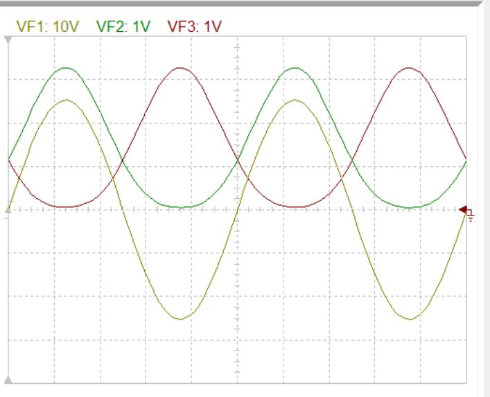

I would rather call these diabolic pair Bonnie&Clyde. The transfer function of these pair is analog XOR. Only what both have decided in common is amplified . In my precedent Rush derived from DHL but in class B , initially I had BD139/140 . I mounted them on sockets to try out different transistors. At the input PNP , I kept BC327 because it has very low Re, by this the feedbacking NPN using weeker ones express their character. Every transistor I tried gave different sound varying mainly in dynamic . It happened I had erroneously a MOSFET 2sk2182 in the bjt box , so I tried it, amazing, The high frequencies got enhanced , as if the treble is set to 3 o'clock but weaker bass. I replaced it by IRFZ44, tha bass got better but lost some highs . With IRFBC20, I got still better highs but lack of bass. As it was asking high gm with low drain -gate capacitance ,I have 3sk339 in smd but for low voltage I mounted it along a cascode. This time it sounded as if the treble control is more than maximum. I measured the frequency response with generator , flat to 100khz ??? I inserted pink noise , the spectrum of the output overlaid exactly with that of input. I plugged a software synthesizer playing piano notes, there I saw the spectrum of the output/input increase from 3khz to reach +15db at 10khz. I replaced the 3k339 with other ones , only the bass decreases . I put back the IRFBC20 without cascode and replaced the input BC327 with 3j327, all the charm disappeared , Now I mount the BC327 with 3k337 in compound Darlington , and I get as if an equalizer is set +6db 8khz and +12db 16khz with excellent bass, always the frequency response flat . For my aging ears it fits the best .
